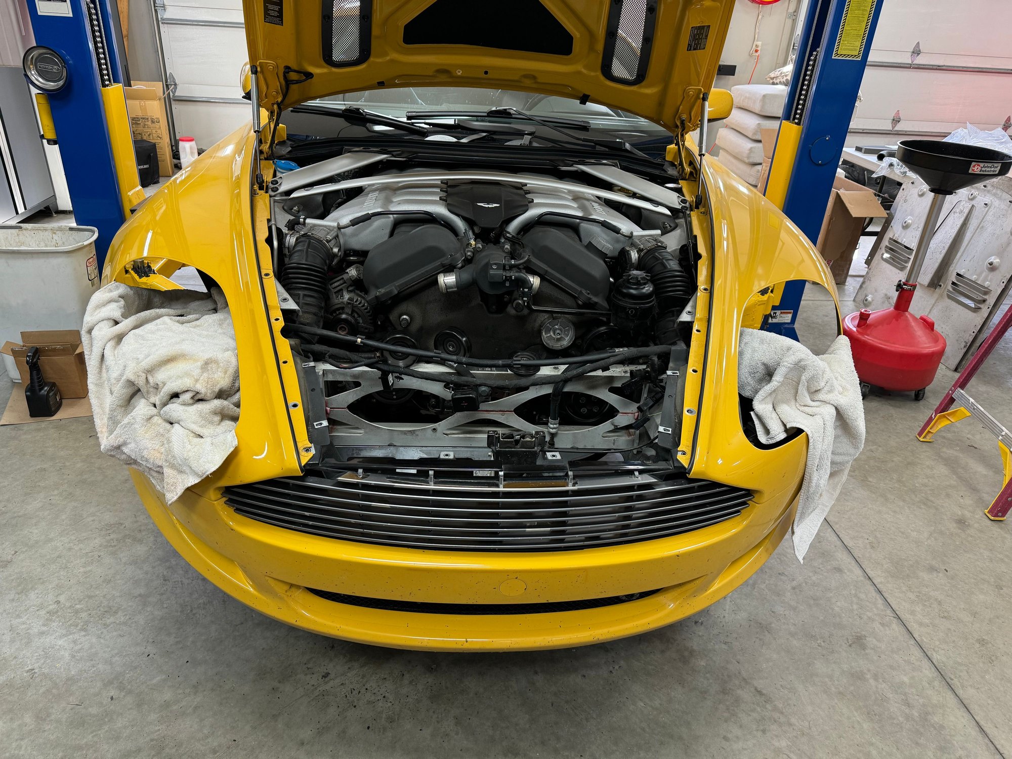

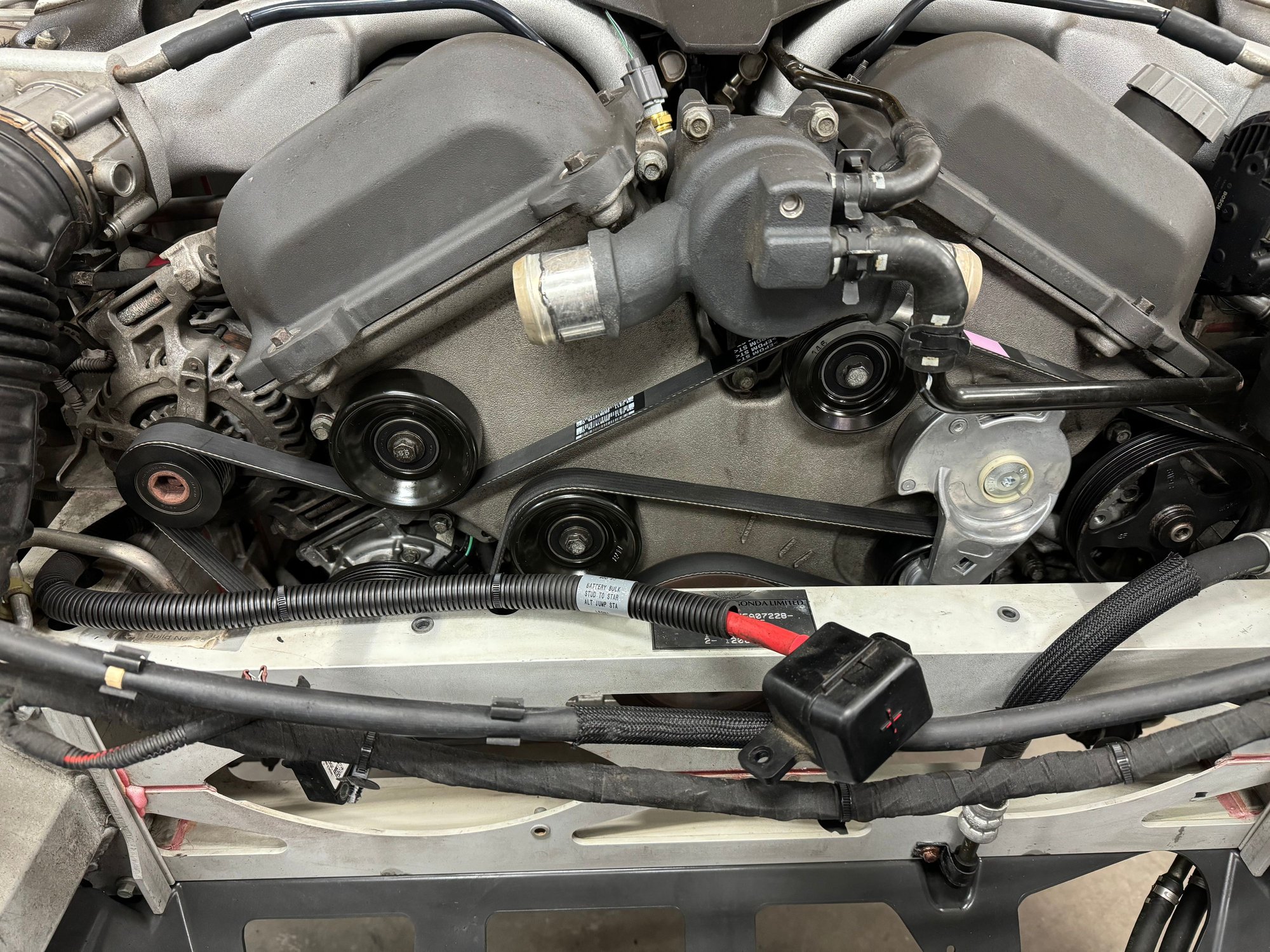

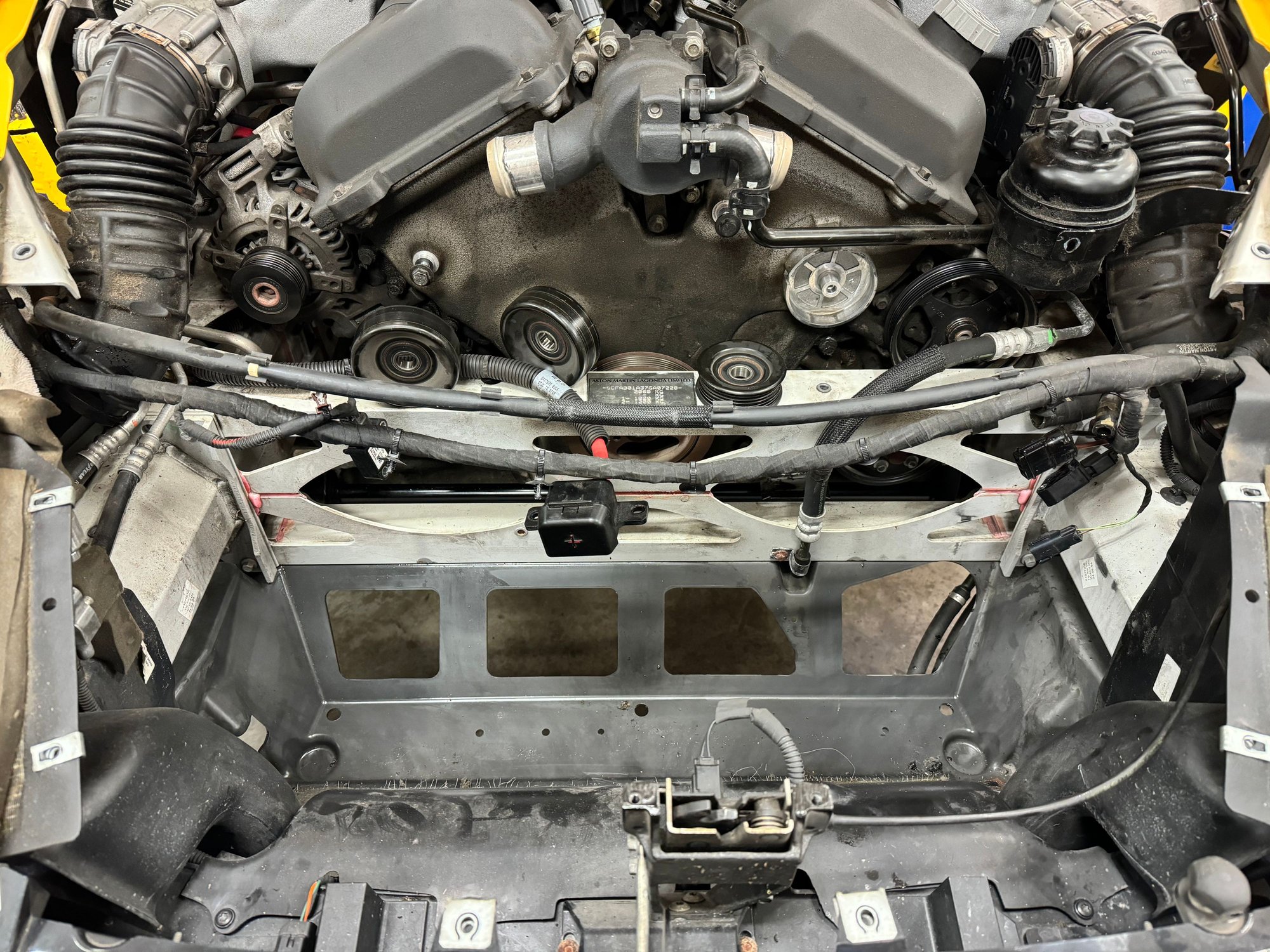

I am in the process of doing this on my '07 DB9 as part of a radiator project. Once the condenser and radiator are out of the way, it's an easy project. if you have a lift, it certainly helps!
The pullieys are very easy to replace as is the tensioner and the FEAD Belt. My old belt "Looked" decent, but after years of heat/cold cycles a new belt is cheap insurance!!!
Jim
