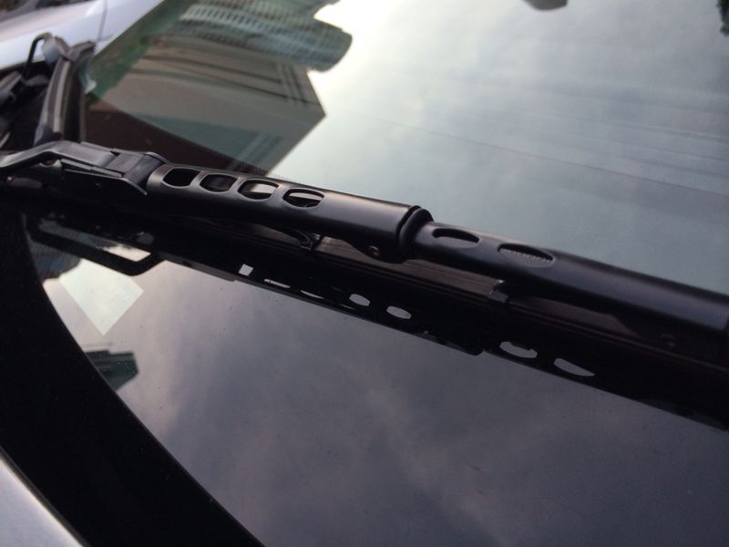

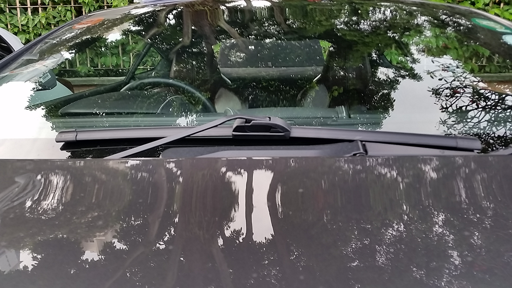

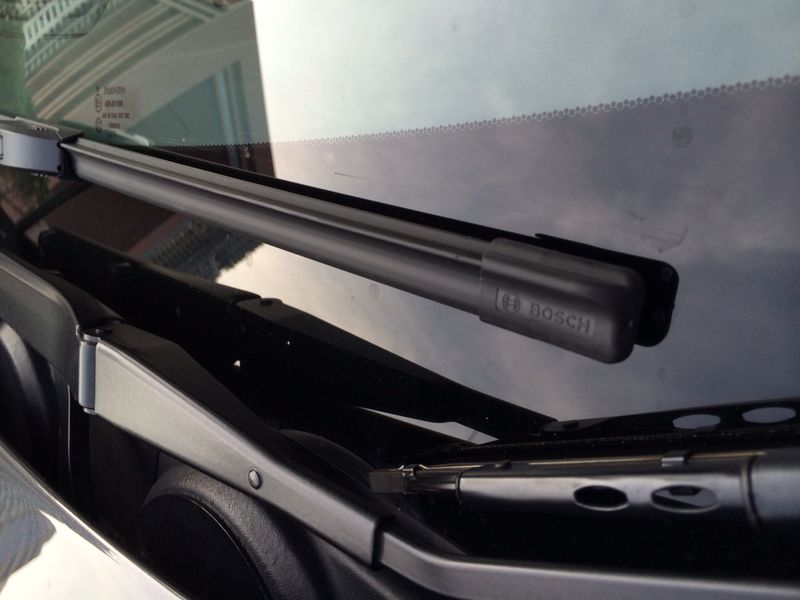

The metal frame wipers on the Vantage rather ugly. I found the Bosch AeroTwin wipers to be a direct fit!

Looks good! I bought the Bosch Icon series at Pep boys... However they look exactly the same as yours. I'm not sure what's different about the Aerotwin vs Icon.
Either way AM of LI didn't like them and told me they wouldn't work at 150mph

I can tell you that, on my Esprit, when you pass 130, the "aero" blades actually started to move the wiper arm up the windshield. By the time I'm going 180 it is at the middle of the windshield. Luckily the Esprit only has a single wiper so (due to the direction of its sweep) it sits in the field of view of the passenger instead of the driver. I suspect that the ugly holes in the original design of the Vantage blade let air flow through it rather than create wind resistance. The newer Vantages actually resolved this problem by redesigning the wiper arm as well.

For RHD car
BBA500 Passenger Side
BBA600 Driver Side
