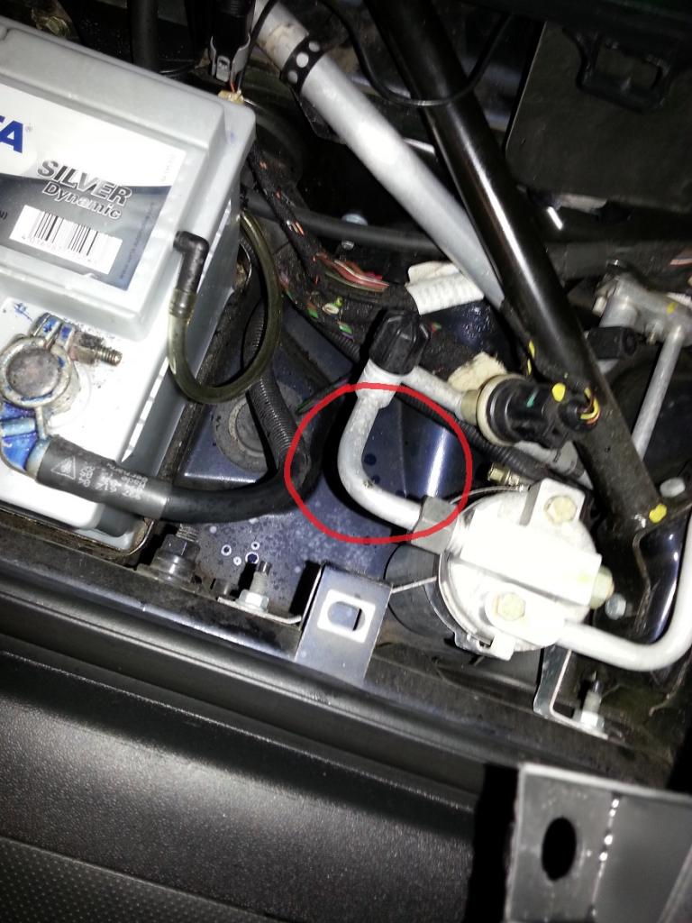

Ok went to disconnect battery terminal, placed socket wrench on nut, sparks flew, hit the pipe circled below, burned a small hole in it, liquid and gas started spurting out.... so
What does this pipe do and is the car able to be driven? It was leaking out air/gas after the liquid stopped spurting out. As I won't get to take it to the garage until tomorrow I assume overnight whatever air/gas is left will be leaked out completely.

i think thats the AC dryer, so you lost your AC coolant. car should drive ok, but youll need to replace the part, and refill your AC at the very least.
EDIT: More accurately, refrigerant.

I think that might be the recharge nipple for the AC. Not sure, would explain liquid gas escaping though.

Thanks, had a feeling it was the AC, least I don't have to get it towed

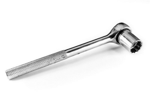

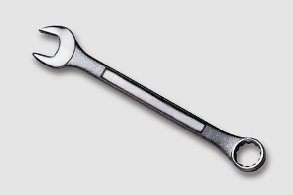

No the socket wrench never touched the pipe, it sparked when the socket covered the nut on the + terminal - no idea why as last time I used a solid wrench and it never sparked, I removed the positive terminal first too.
sparked when using a socket wrench similar to this (mine had a rubber handle - would that be the cause of the spark?)
As it didn't spark last time when I used this to remove the + terminal

Was the negative terminal disconnected when this happened?
