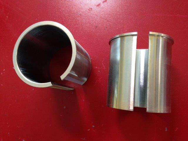

Nice upgrade. See that you have the Bilsteins coilovers with ride height adjustements. Nice.
Since last post I also changed the springs and dampers. I thought about the DDA but they were mostly expensive. For the C2 Bilstein only have option and that is the "standard" B16 with PN 49-115604. For the C4 they also have a "clubsport" option then it is developed for the Turbo initially but no "clubsport" for the C2.
Then I talked to some people about this and they said that it is possible to mount the Bilstein B16 for the GT3/GT2 with PN 49-145489 . I asked about the installation dilemma then the rear is the same but that the normal C2 and GT cars have different uprights in the front.
I realized that it is only a matter of diameter of the front upright then the normal C2 cars have a shock that is 3 mm bigger in diameter. Then I got me some "adaptor sleeves" and mounted the GT2/GT3 B16 kit with PASM compability. Remember that this kit cost 1/3 of the Tractive DDA and it is a tuning Product for the GT3/GT2. The car is fantastic.
Suddenly I ended up with new problems that I did not anticipate. The speed is considerably higher so I ended up with "boiling" brake fluid then the brake cooling is not as good on the C2 as on the GT3 but my speed is similar. I had to change to Endless RF-650 "cup" brake fluid.
Also have a problem with gearbox temperature, the Mobil 1 oil gets to hot and I'm loosing gears. The GT3 have gearbox oilcooler (introduced on 996.2 GT3 because of this problem) and I don't. Mobil and Porsche only recommends this one oil they have and that is a 75w-90. I can't run with this any more so I will change to a Castrol Syntrax Limited Slip 75w-140 for this season I Believe.
Attached you will find an image of the sleeves to put the GT3 B16 on a C2.
