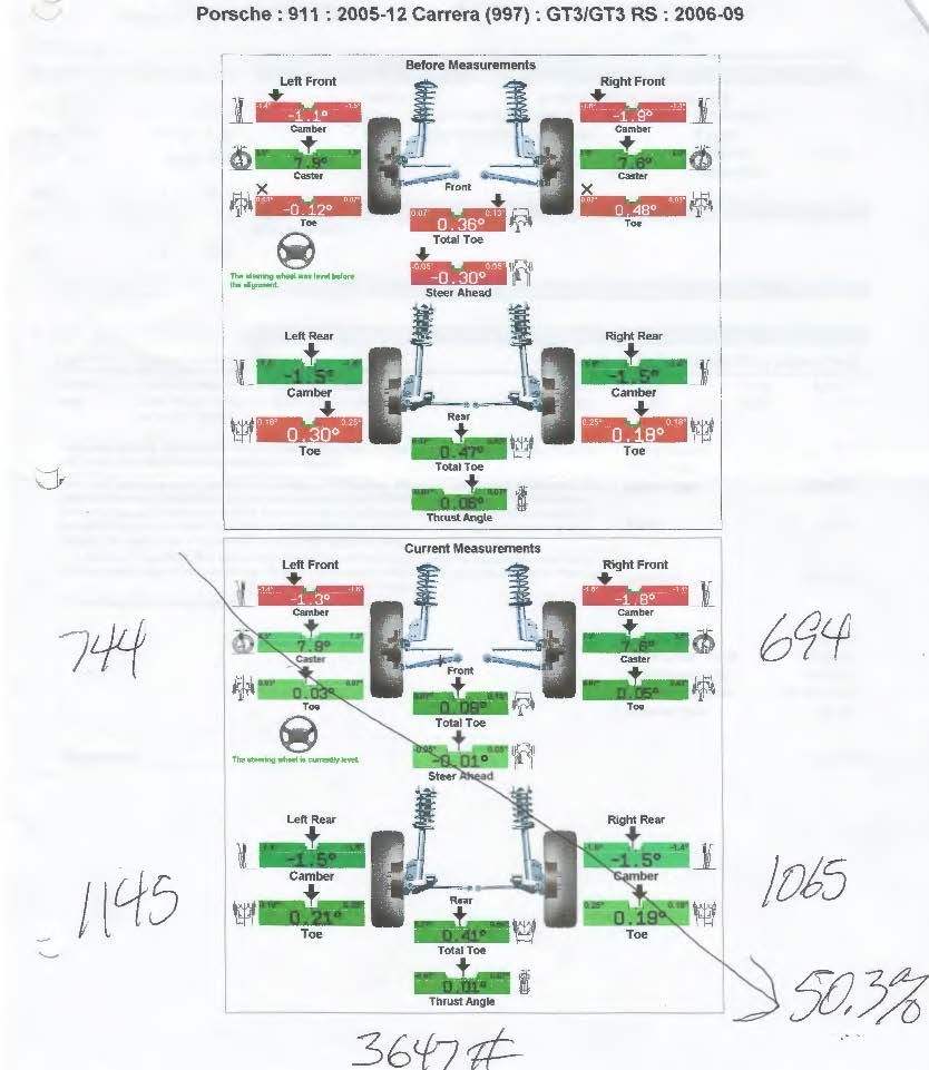

Sorry, I missed this in your original reply but just saw it with the recent bump of this thread.
Here are my alignment #s including corner balance. Tire wear is actually very good and with the suspension upgrades and everything being locked into place, haven't needed to change anything since I originally had this done about 14,000 miles ago.
