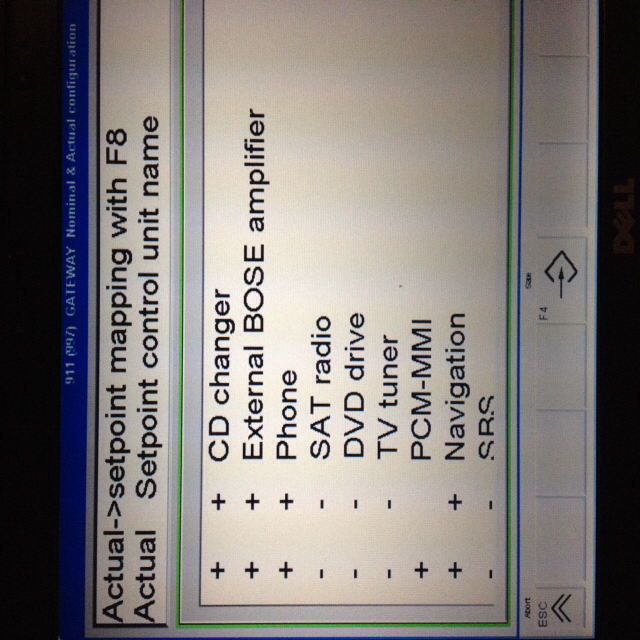

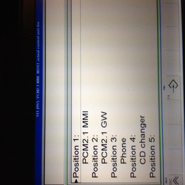

Here are some screenshots from my PIWIS. The first one shows that the PCM is picking up the Dension phone and CDC and putting them in position 3 and 4. The second screenshot is showing double pluses for the CDC and phone which Eric said is a good thing. It seems like everything is set up correctly, yet it's still not trouble free.
ID:	395919   Click image for larger version
