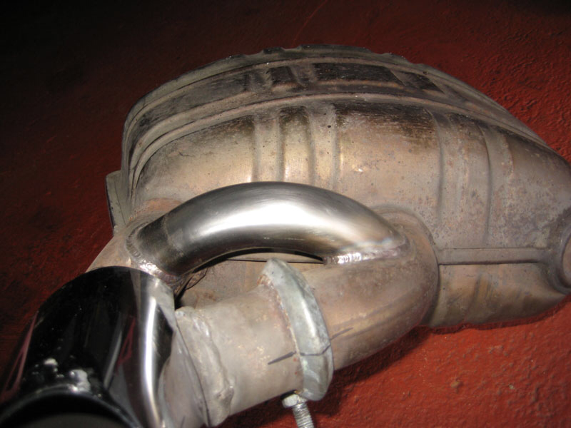

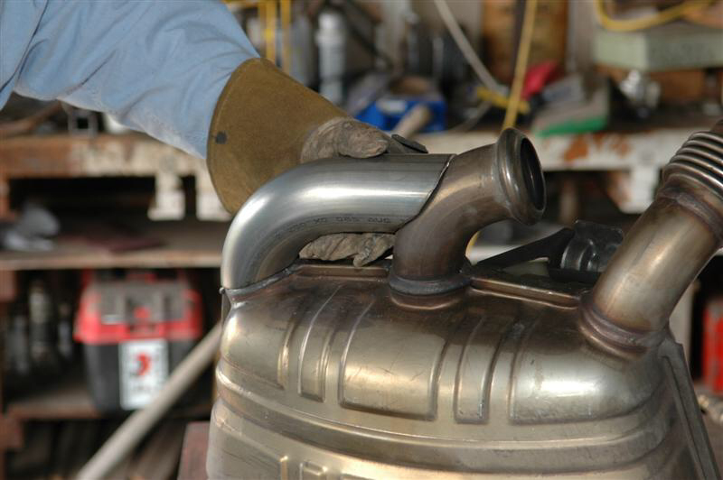

Don't forget there are two kinds of hacks. Gundo and Fister are different.

I can speak for my experience, with a 3.4l . I have the first setup with a 2.5" pipe which simulates PSE setup. I found it a bit too subtle. Nice growl above 4K RPM. I augmented it with a fabspeed CAI setup. The fister set up seems to generate the best sound from what I gather around the forums.

So you have the type in the first pic above?
The gundo hack IS the same thing as a Fister D muffler. Your first picture is a hack into the same 2nd outlet that the PSE muffler uses and as stated above is generally regarded as being a little more subtle than the gundo/fister. The size of the bypass pipe used for a gundo hack also affects the sound.
Yes, done by a local muffler shop. PSE style.

Again, the whole purpose of "hacking" your muffler is to bypass a percentage of exhaust from entering the muffler. The first pic isn't really doing that.
A crossover pipe anywhere from 1 1/2" to 2 1/2" is welded in between the intake and outlet and 50% +/- will exit through the outlet without being muffled resulting in sweet loudness!

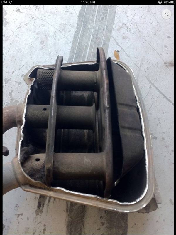

Originally Posted by robsled
Again, the whole purpose of "hacking" your muffler is to bypass a percentage of exhaust from entering the muffler. The first pic isn't really doing that. A crossover pipe anywhere from 1 1/2" to 2 1/2" is welded in between the intake and outlet and 50% +/- will exit through the outlet without being muffled resulting in sweet loudness!
Cross section of muffler. PSE skips a chamber, Fister D has some air bypassing all chambers, therefore it should be louder.

Exactly....but a true crossover completely bypasses the muffler.
