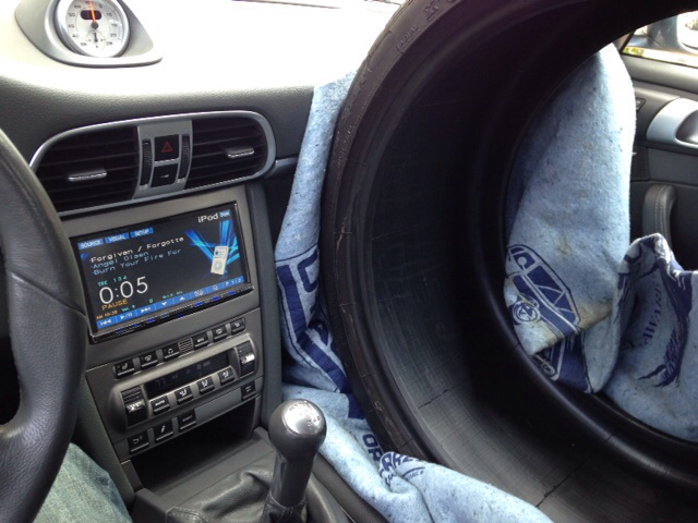

If you've got some tread left on the old ones, it's a good idea to hang onto at least 1 in case you get an irreparable flat and the replacements are on backorder. (It happens) Having an old PSS in the garage saved me today.
{I'd post a pic right here but it never works on mobile for me.} oh look at that. It works.

.......If you've got some tread left on the old ones, it's a good idea to hang onto at least 1 in case you get an irreparable flat and the replacements are on backorder. (It happens) Having an old PSS in the garage saved me today.
Ha ! I never thought you could fit a tire in our cars
