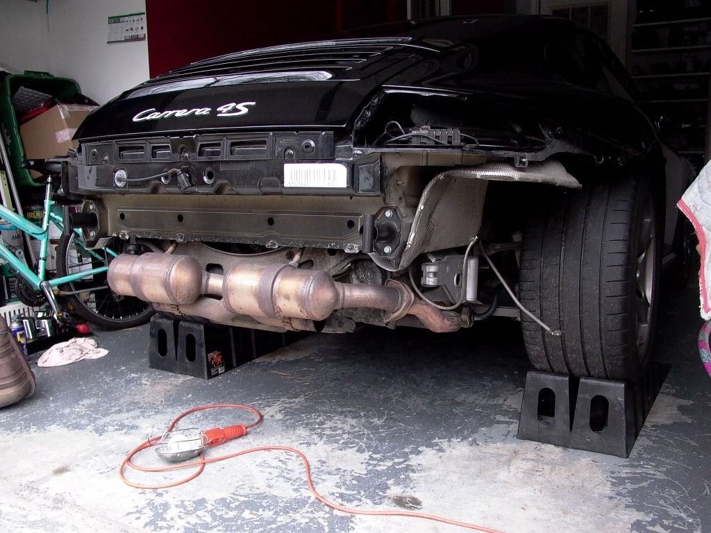

I finally decided to take apart all the mufflers during the Christmas break. After all, a break is made for that: tinkering with your car.
The car was installed on ramps for easier access: (by the way, you need to remove the rear bumper to gain access to the mufflers. Not doing it would be foolish and extremely difficult).
The noise was coming from the left side:

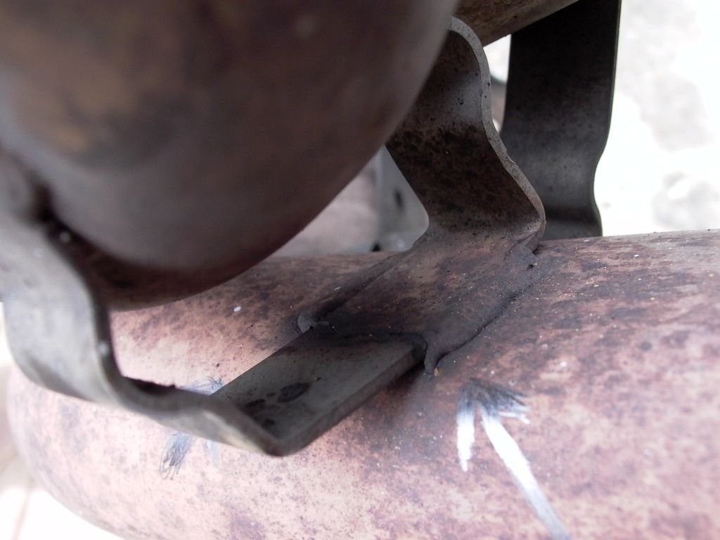

After careful examination of the muffler, I found a broken link between the exhaust tubes. Apparently, this is a common problem:

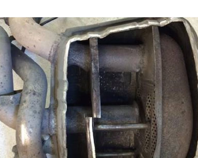

They opened the beast as shown on that picture and revealed all kinds of broken baffles (The following picture was borrowed):

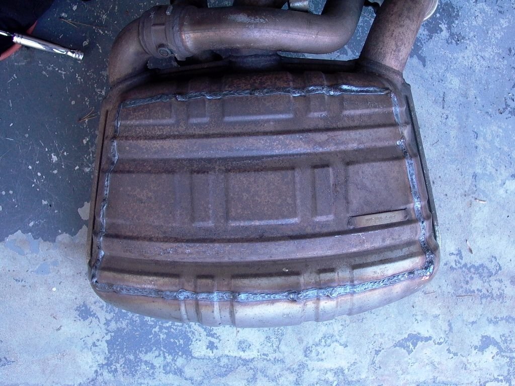

Unfortunately, Henry's crew did not take any inside picture but they did a beautiful job at mending the muffler back:
Very nice welding job. They also re-enforced a few weak areas.
The overall cost was $150 (2 hours labor) as compared to $1295 for a new muffler. Early tests indicated a very good improvement on the noise. The muffler is now completely silent and devoid of metallic noises.
