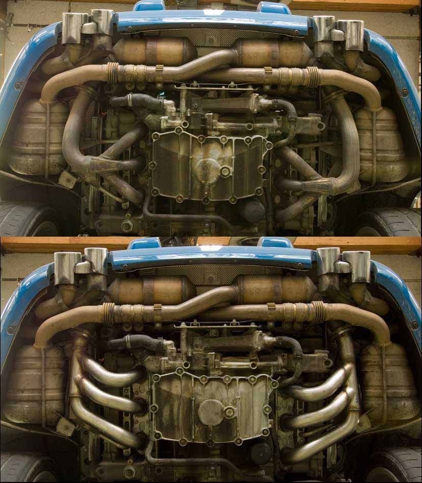

S on top, X51 on bottom

M97 (3.8l S models) headers are in the top picture as indicated. The M96 (3.6l) headers are in the bottom picture. The M96 headers and the X51 headers look the same but X51 has 48mm tubes and M96 has 42mm tubes.
