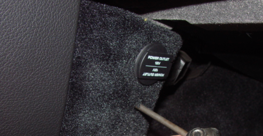

Hi all - I am sure this part is a standard VAG group part and not 997 specific, but.
Does anybody knows the part code for this Male connector?
I have the 12v socket and want to retrofit it - I don't have the male connector at the end of the cables and want to OEM it to be safe?
Anybody know the part or where to get it?

I don't see connector part numbers in Porsche's PET diagrams. The lowest level part numbers listed are for wiring harnesses. That 12V socket is the same as the center console one. That means the connectors on both wiring harnesses are the same. So perhaps picking up a used wiring harness for the center console and cutting off the connector? The center console wiring harness is part number 997.612.652.75
Another option - bring the 12V socket to someplace like Autozone and see if they have a three pin male Molex connector that fits.
