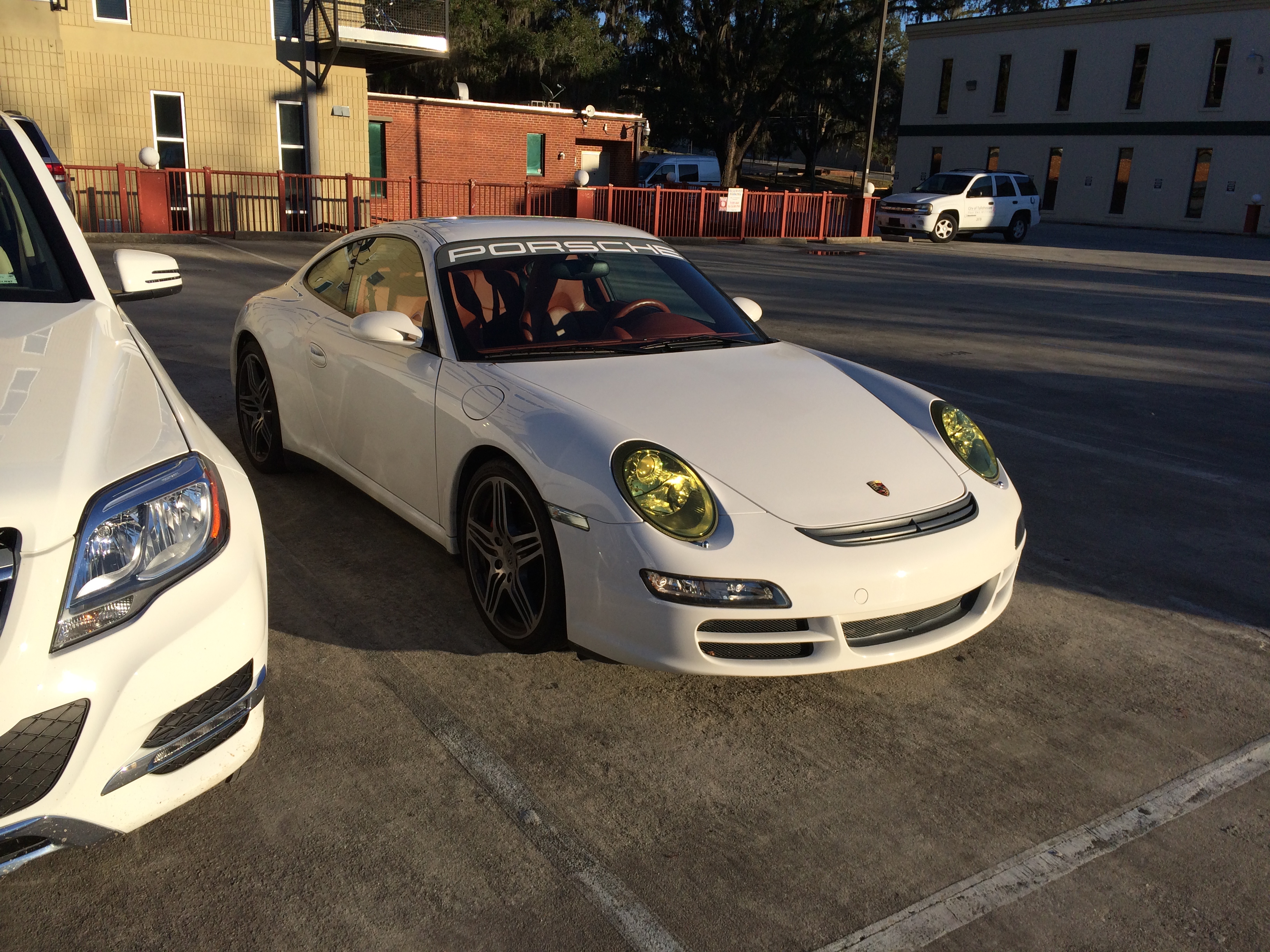

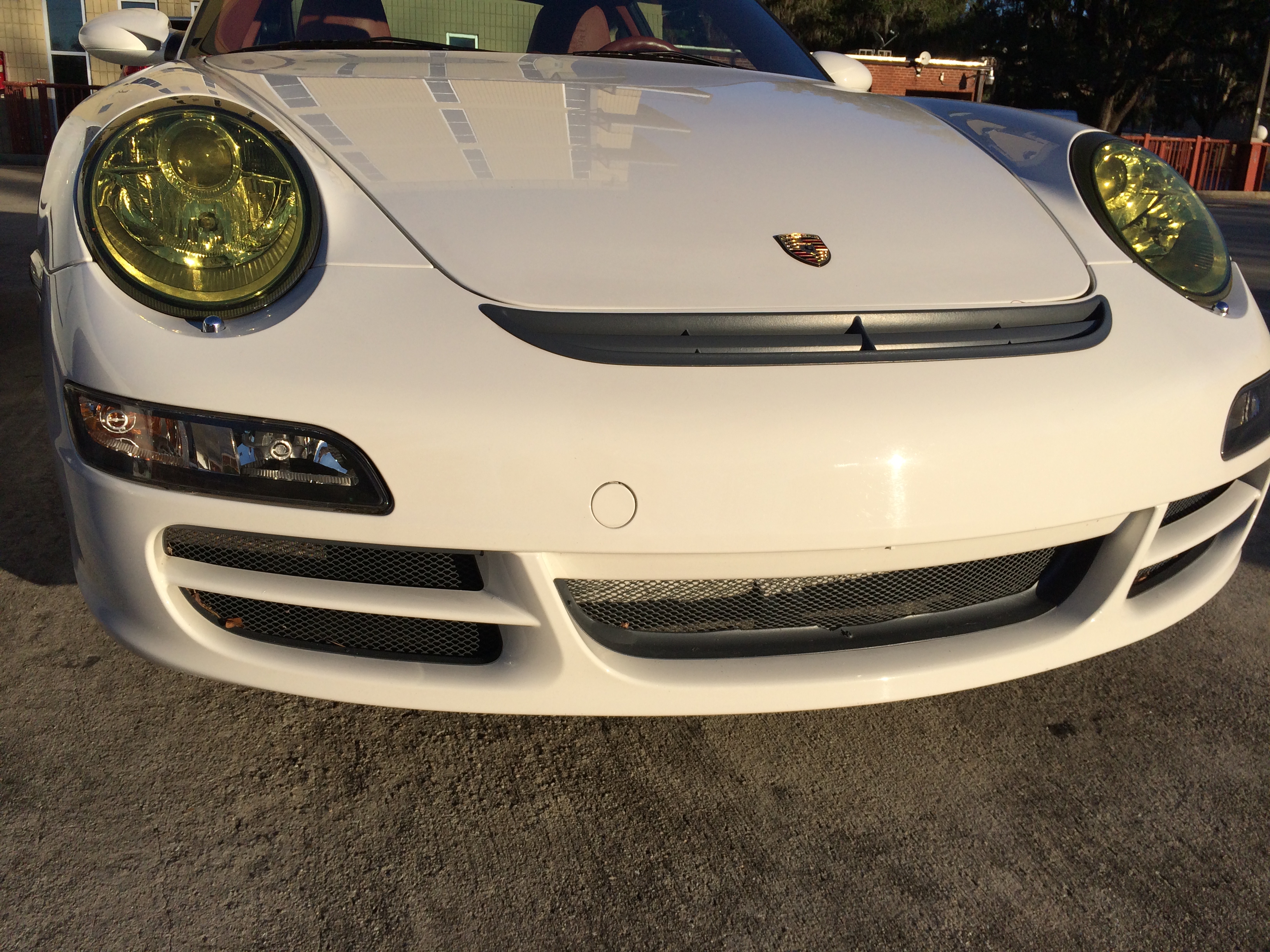

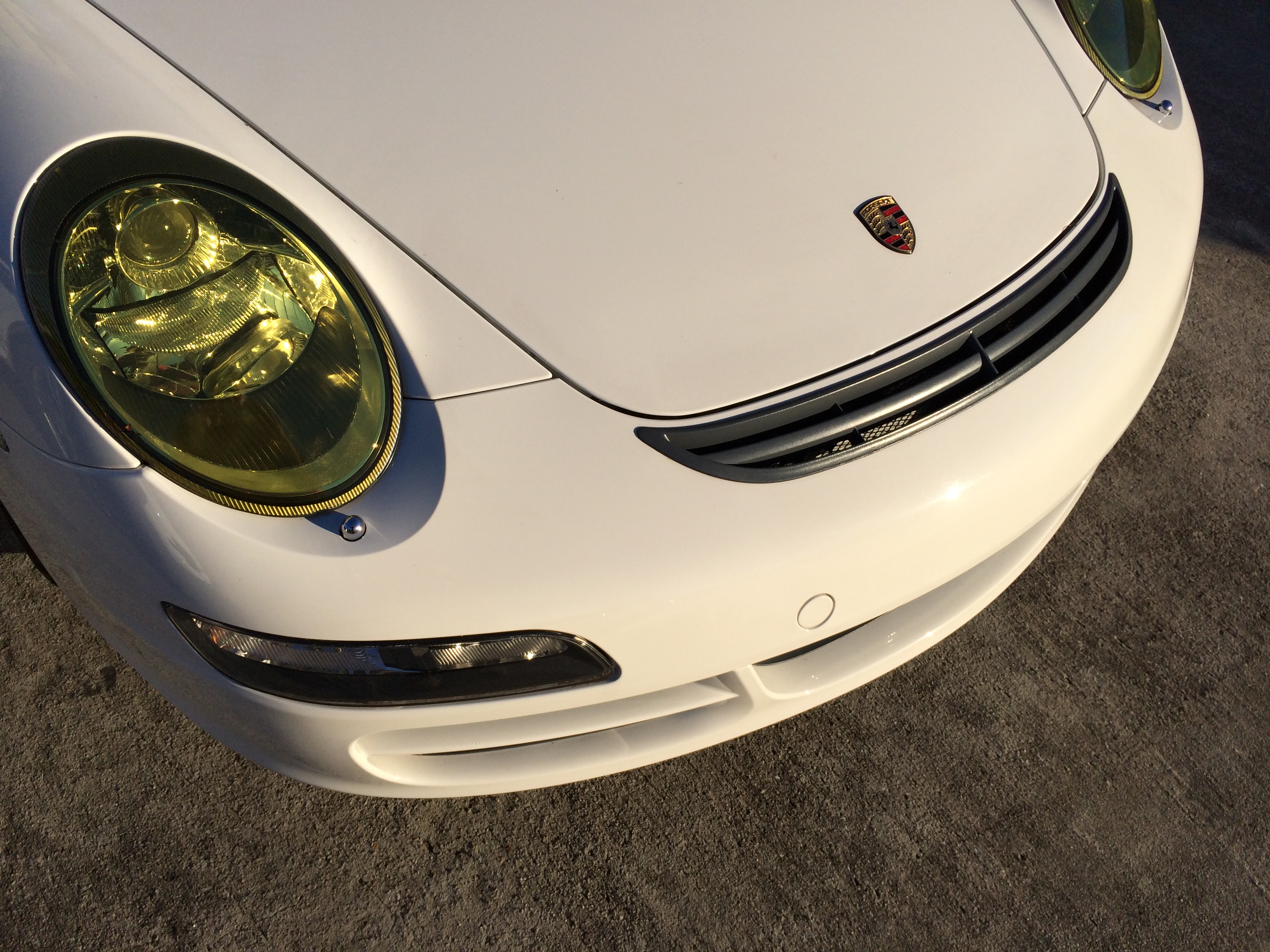

I purchased the rennline kit. Worked well but make sure your jigsaw blade is thin, other wise it will catch on the template. It was scary cutting into the plastic but not difficult to do. Much much cheaper than buying the gt3 rs bumper and lights etc... pm me for pics

I ended up taking the front bumper off but I also removed the lower air dams and replaced with wire mesh as well.

I purchased aluminum mesh (sprayed with matte gray paint) in a roll from hardware store and hand formed and cut it to fit. Then anchored it with some screws to the old plastic vent pieces. The center vent I cutout the plastic with a jig-saw, some areas need to be cleaned up on the bottom. I'll fix it this summer. If I still have the C4S that is. Considering selling it since I don't drive it as much as I'd like to and need to buy some other toys
