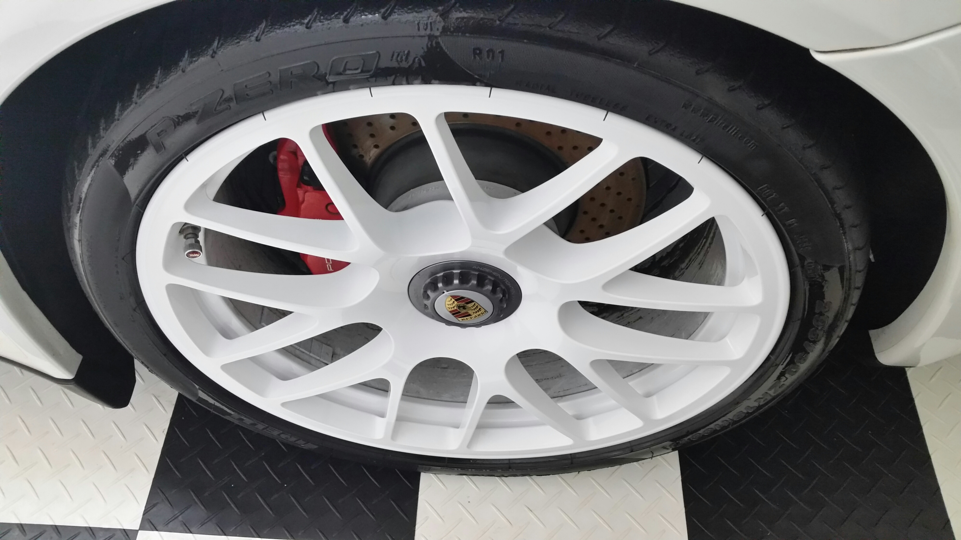

I just purchased a white 911 GTS and the car has white wheels (OEM Turbo S wheels). I love the wheels and the look of the white wheels with the white car. Brake dust creates a bit of challenge in terms of keeping the wheels looking clean and white.
Does anyone have any special tricks that can be used to keep the white wheels clean longer? I applied a coat of wax to the wheels last night and am anxious to see if that helps the dust wipe off easily. It's not the end of the world - I actually enjoy cleaning my car and find it somewhat therapeutic anyways. But if someone has a proven shortcut, I would love to see it or hear about it.
I do love the look of the white wheels with the white car and the white aero kit and spoilers.

I replaced my brake pads with Aekebono European pads and my dust is down 90%. The initial bite is not the same but it's progressive and when you get on them the stop is still there. Wouldn't use them on the track but on the street they are great and literally no brake dust or noise

I have installed the Aekebono European pads on all my BMWs and it is true that they do make a huge difference as far as dusting the rims. Be aware though, that they do not offer the same grip as the OEM pads, are a little bit slippery (for my taste) when wet, and tend to glaze themselves after a while. You may need to perform a few really hard brakings to get rid of the upper layer of glazing on the pads.
For street usage they are fine and safe.

Hawk Ceramic pads also dramatically reduce the dust and are popular for our cars. You'll find discussions about them here and on Rennlist.com. No harm to the rotors, maybe even easier since I'm noting no wear of concern in 10k miles on my current car.
The small amount of dust they do produce is very light in color and sticks less than the dust from factory pads. I'm very happy with the performance of them too, as good or better than OEM in my opinion. I've used them on my last three cars. I no longer have to clean the car/wheels early just due to brake dust.
The above-mentioned Akebono pads are probably fine too, but my direct experience causes me to recommend the Hawks.

Hawk ceramic pads here. I can vouch for StormRune's experience, at least on silver OEM wheels. They don't eliminate the dust problem completely or even 90%, but I can go 3-4 times longer before my wheels really need to be cleaned. I find residual Hawk pad dust much easier to loosen and scrub off. I may not be the best expert on braking differences, but I did not notice any between OEM and my Hawks. Akebonos had been strongly recommended to me by my Indy (well-known Porsche technician), but I could not find the correct fitment for my 2008 997 C2S Cab at the time, and Hawk had the correct fitting pads. I am still using the OEM rotors with no apparent difference from their perspective. Considering truly white wheels, I could see Hawks causing them the look slightly yellowish-brown with use, but never gray or black.

I've found that this armor all wheel protectant actually works as advertised. It significantly reduces the amount of brake dust on the wheels. I apply it every time I wash the car and swear by it now. You can pick it up at walmart. It's works so good I'm scared they are gonna discontinue it so I keep a couple bottles in the garage at all times.

I am another user of the Hawk pads and I highly recommend them. The Hawk ceramic pads have reduced the amount of brake dust by 66% to 75% versus the OEM pads.
