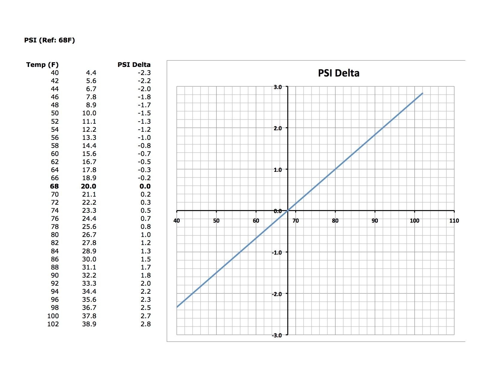

What's the formula for this? I'm a stickler for tire temps, and I run in a variety of ambient temps. Both DEs I've done with these new PSS' were similar temps (around 60f), so I don't have any idea what to set cold if I do a summer DE and the ambient is 100f.
The formula is PV=nRT. See below a chart for that.
Note: That cold setting should be done when the tires are at ambient temperature. Using that curve I set 'cold's 33/37 and when hot on the road (spirited) I am usually at 39/43.

With all due respect... I think your issue is that the outside temp is low and you have not dynamically heated the tires. Raising the 'cold' rears you are aiding into that but that is not the right way.
If you know your garage temp is at 60F you should subtract roughly 1 PSI (0-0.7PSI from the chart above) from the correct value and then properly (dynamically by driving heating up the tires. If the outside temp is 51F it will take while... I use 'cold' 33/37PSI with M-PSS and the car is perfectly stable and precise. i start at 33/37 and on the road I am often at 39/43 (the correct hot tire pressures).
