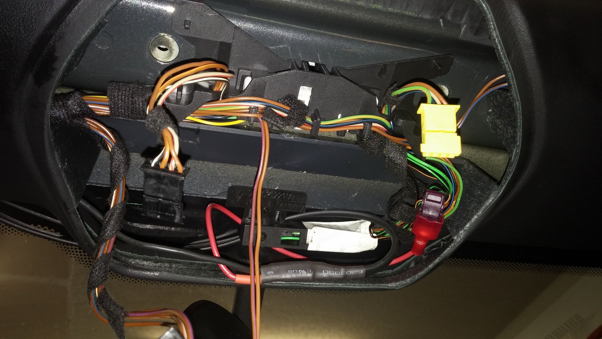

Found and tested the Black/Orange cable that led to the auto-dimming mirror. Great.

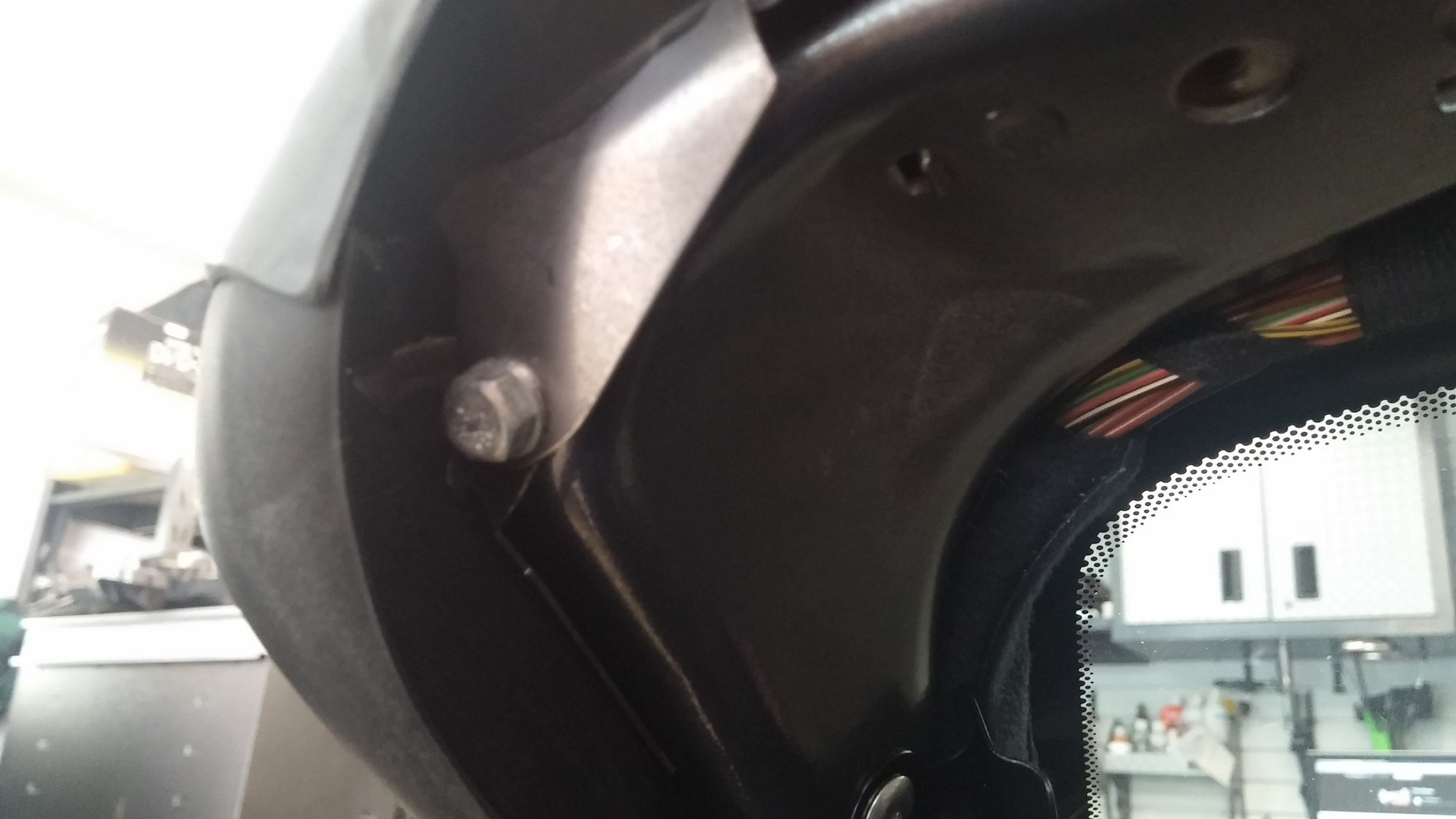

Next, needed a ground. I didn't want to just tap into a ground wire, so I had to back track to find a nice ground point. Removed the visor, then removed the A pillar. Hmm, what is that, a little 8mm bolt. Perfect. Found my ground.

Got a 18-24g Wire T-tap from Radioshack and connected it to the Black/Orange wire.

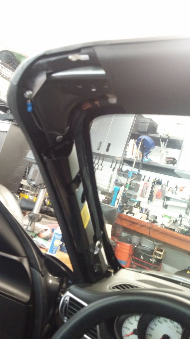

With the visor removed the upper trim pulled down enough to tuck the wire, but I thought lets make it neat and pulled down the wire and tucked it neatly in the bundle. Popped the plastic rivets back in and connected the ground.
Re-installed A Pillar
Re-installed Visor

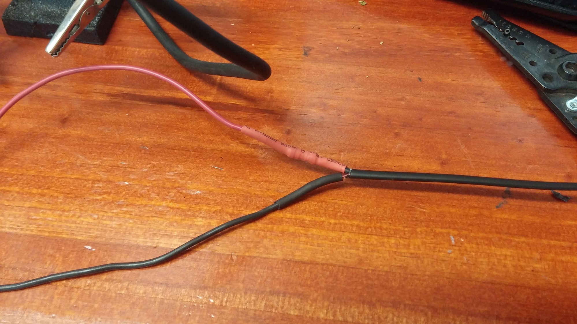

Inline fuse soldered to the cable
Shrunk wrapped each wire
Shrunk wrapped both wires together to reinforce the solder joints

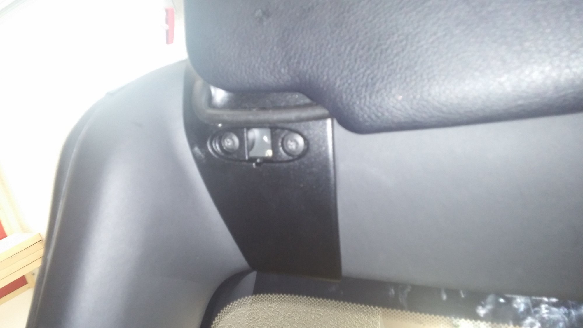

Visor removed, no usable ground
A-Pillar removed, Here is the 8mm bolt that you can use for a ground.
Here is the ground attached and the wire bundle that I tucked the ground cable to. Nothing I hate more than driving and the wires popping from the headliner.

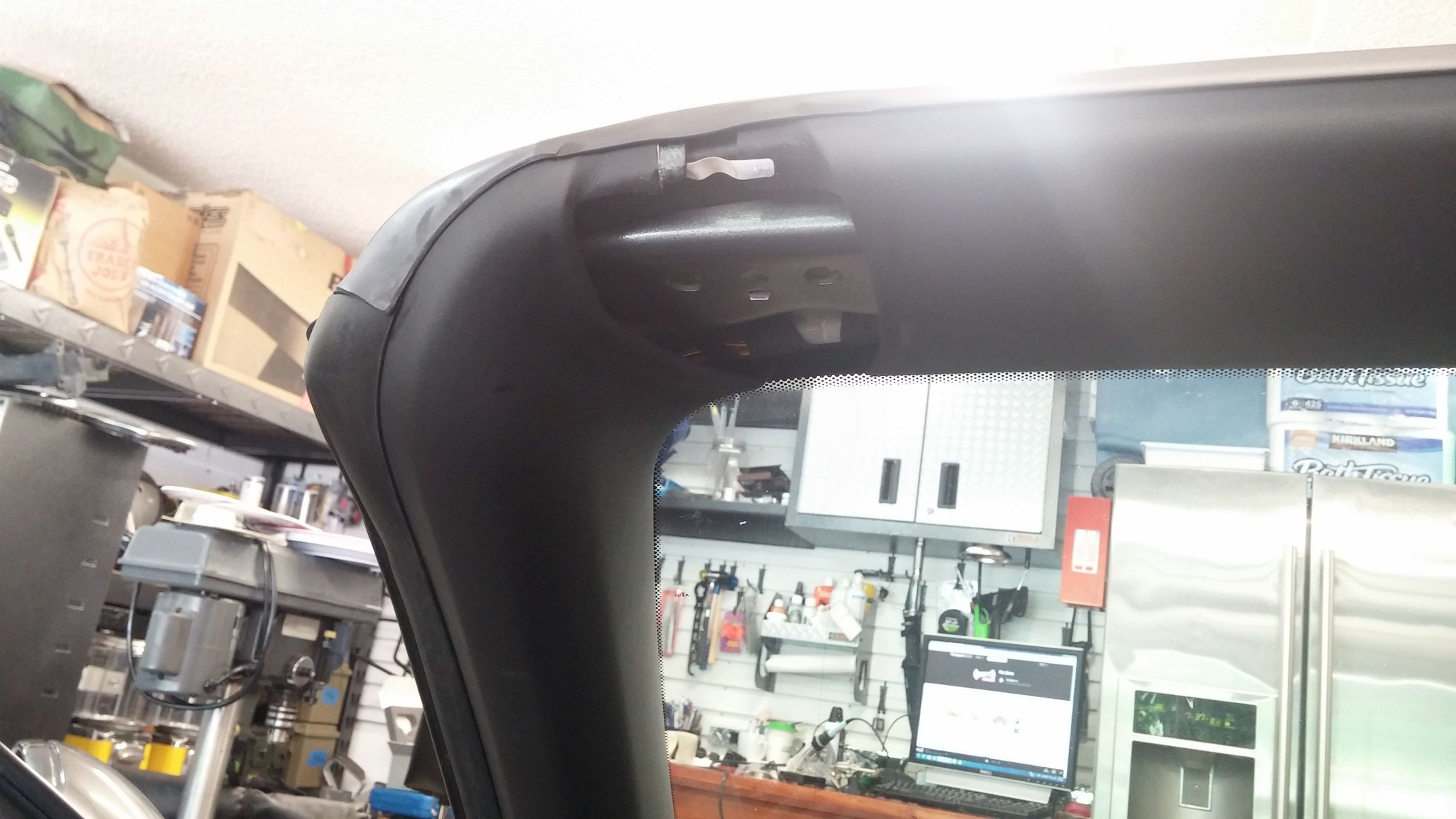

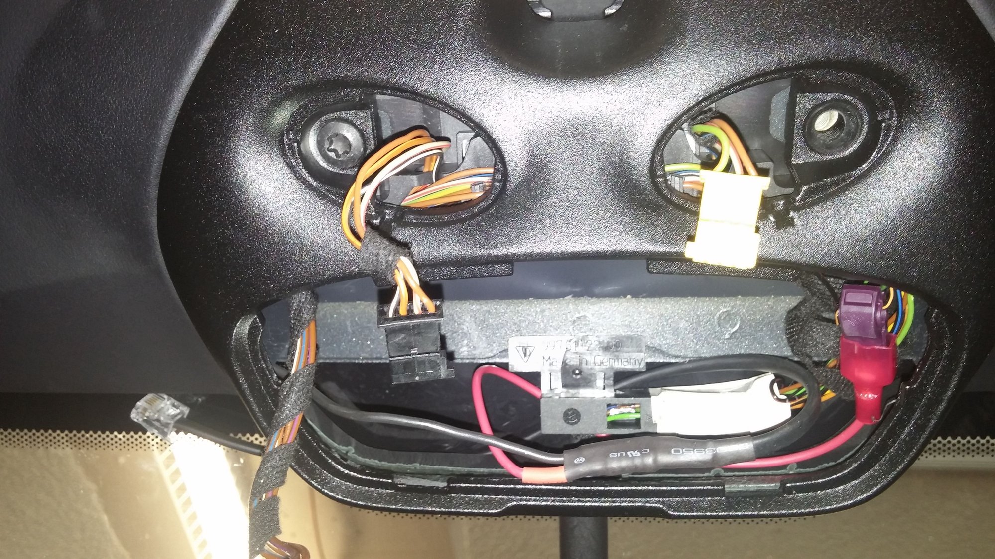

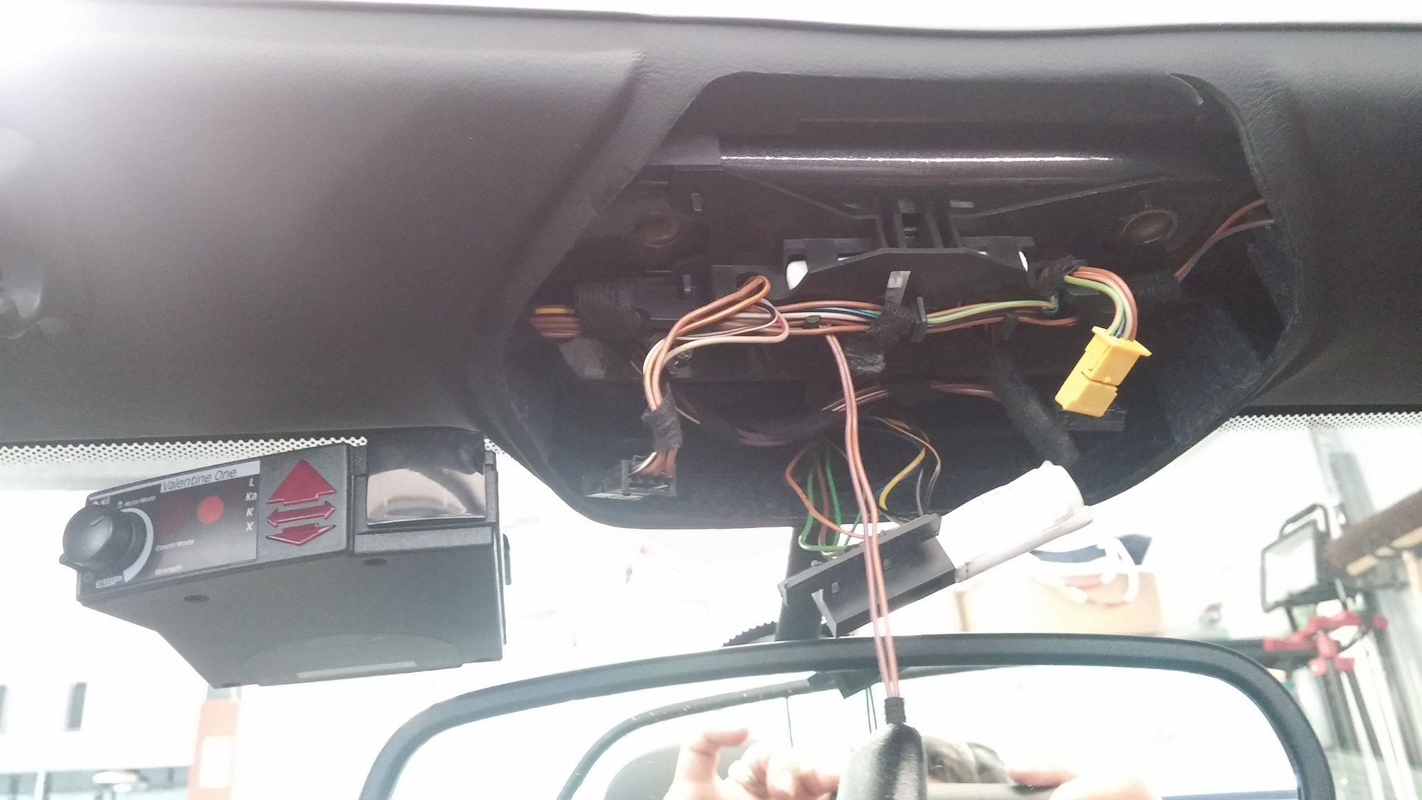

Testing V1 location. Removed center dome. There is that last clip that I couldn't remove.
Inline T-Tap connected and wire tucked in

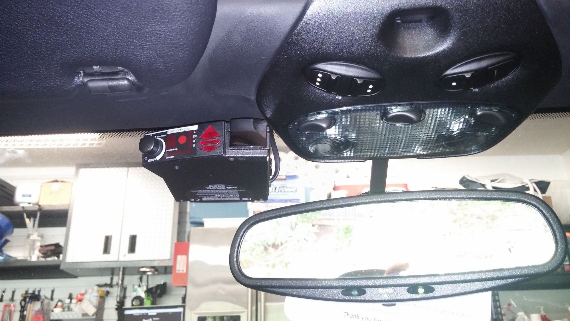

Center dome re-installed. Wire tucked in on the side and back.

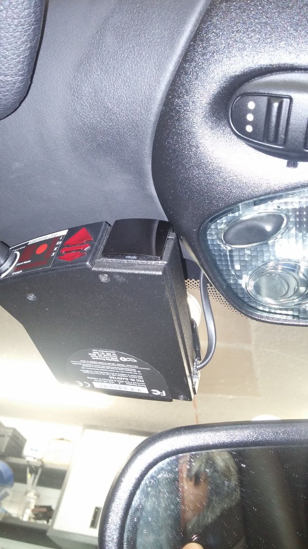

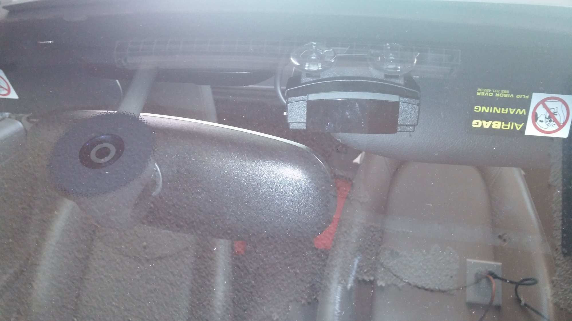

View from underneath.
Another view from the front.
Here is what the install looks like from the outside.
Testing V1 with visor down. Clearance perfect.
Smile!!!
