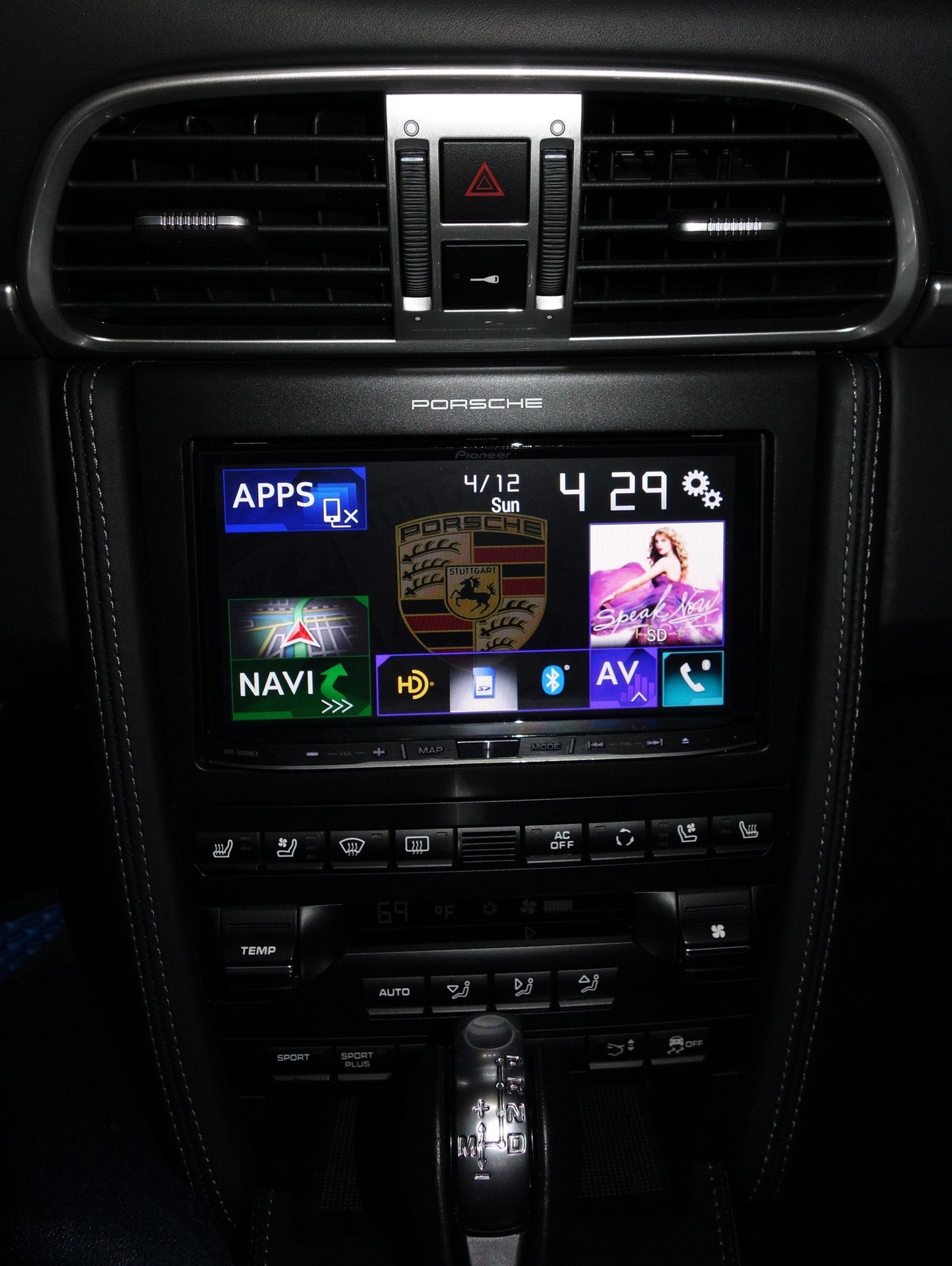

Pioneer NEX-8000 head unit. (Not pictured: Used with Siri and Apple CarPlay when the iPhone is connected)

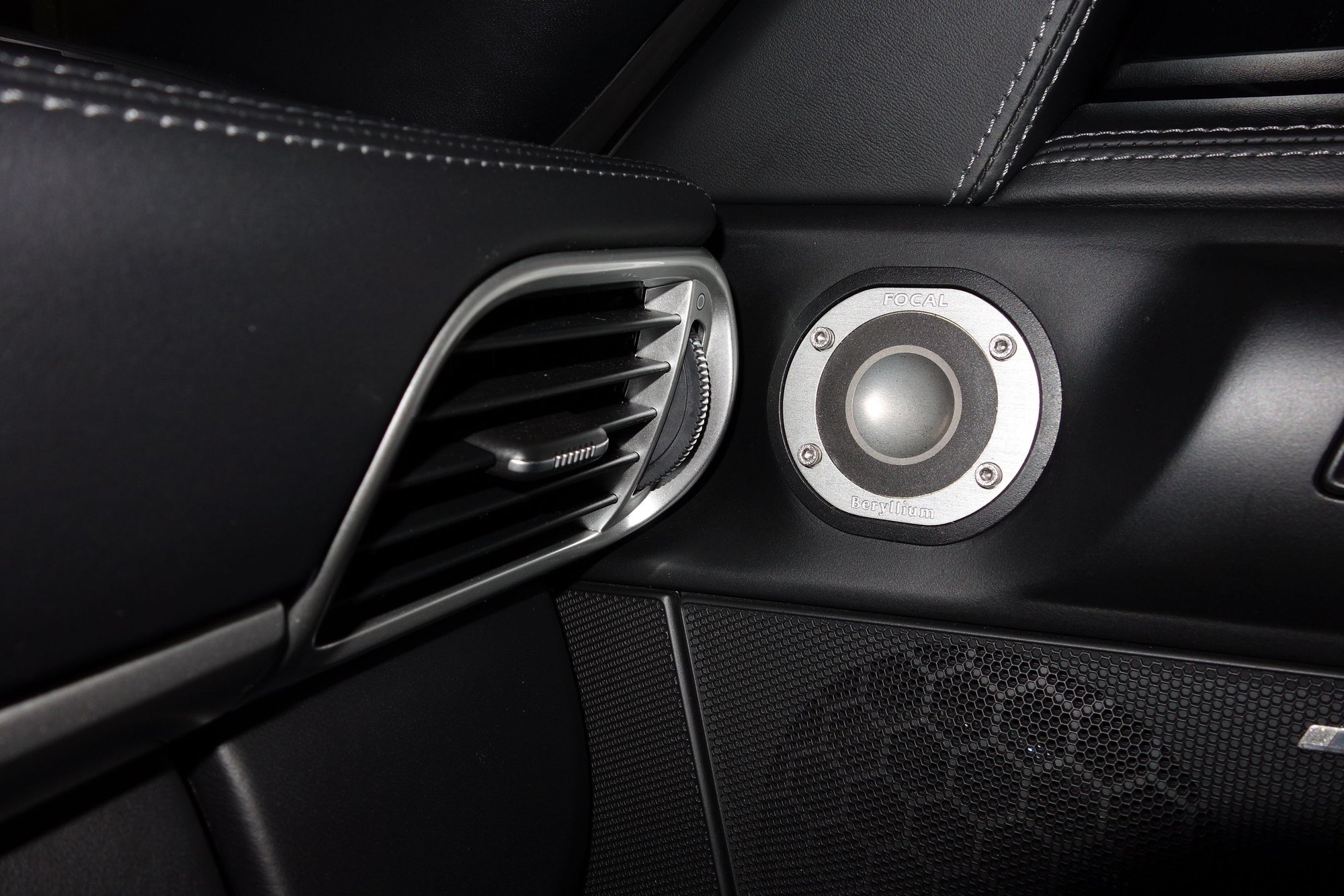

Focal Utopia Be No.7 3-way speakers mounted in factory locations. Tweeter mount was custom fabricated by Sound Innovations (Hayward, CA)

Focal Utopia tweeter closeup (grill off)

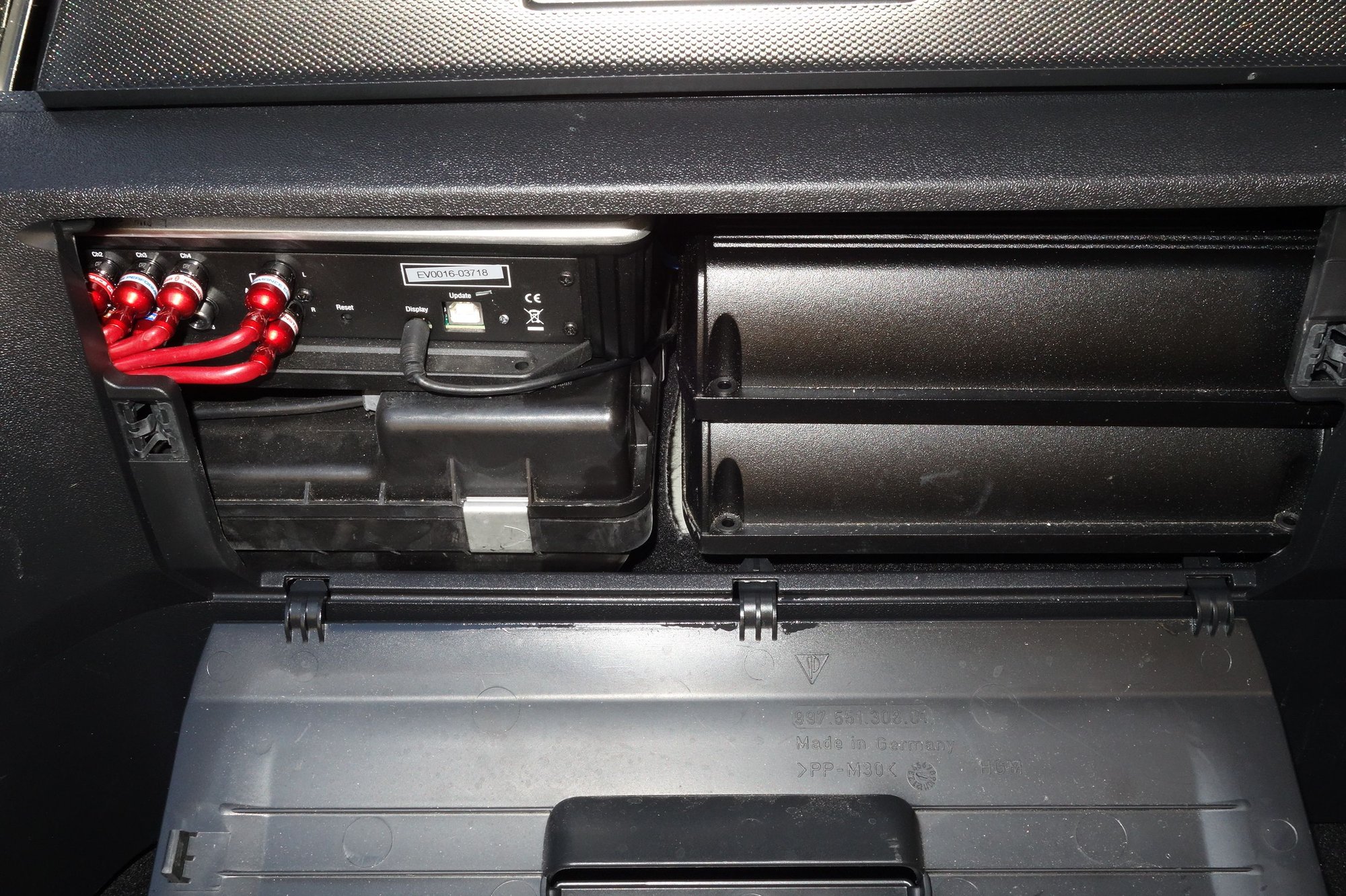

JBL MS-8 Processor and JL XD600/1 amp mounted in the frunk. They are completely concealed. The MS-8 does active crossover duty and frequency response / timing corrections (using a calibrated mic) for the speakers/cockpit. There's an extra XD600/1 in there that I did not end up using.

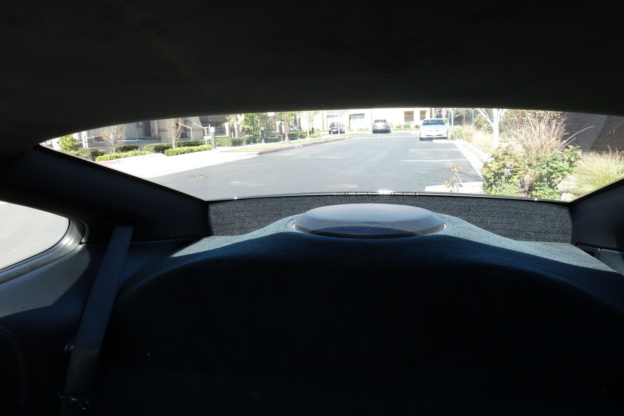

13" JL 13TW5v2 shallow sub mounted in a custom MDF/fiberglass enclosure (created by Sound Innovations). The enclosure takes up the factory Bose location and the space above the rear parcel shelf. It uses the factory Bose mounting holes.

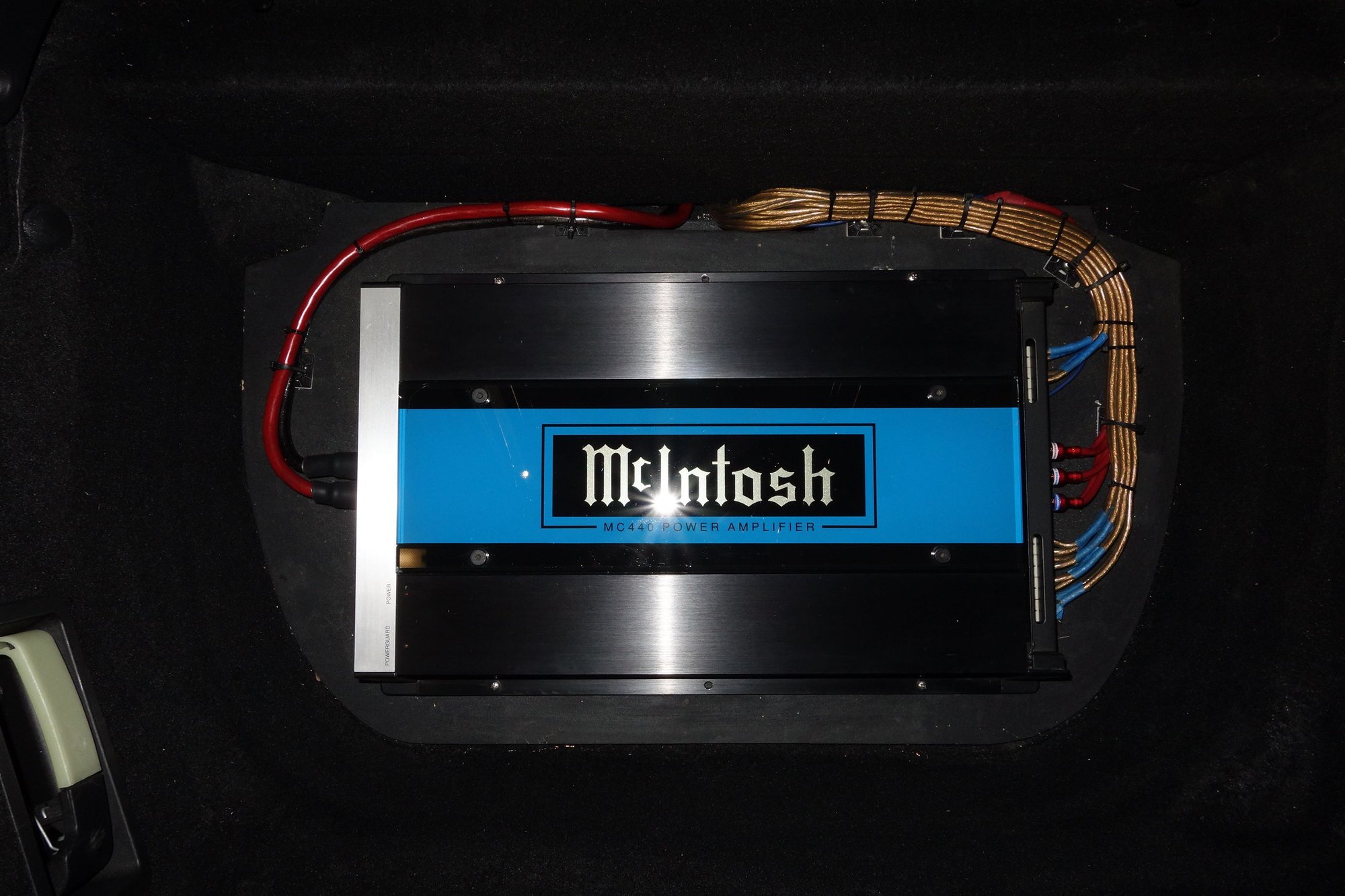

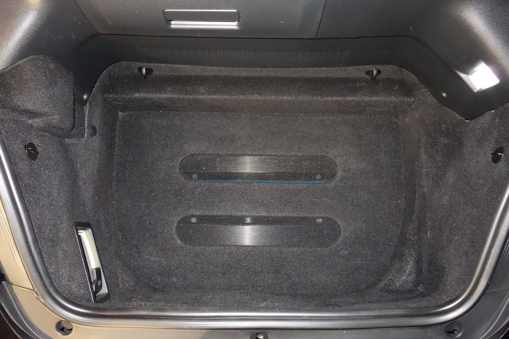

False frunk floor with mesh vent grills (again, by Sound Innovations). The Mcintosh 6ch amp is underneath.
Mcintosh MC404 6ch amp on the frunk floor. I am responsible for the amateur wiring job.
