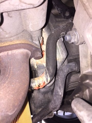

2006 C2 75K miles. I've had a very very slow coolant leak for about a year that has persisted despite replacing the tank.
Today I was changing my oil and noted what looks like coolant crud on a black pipe running alongside the filter (towards the passenger side). It seems to be coming from somewhere up above the pipe.
Any ideas what I'm in for here?

Thanks everyone for your overwhelming response.
According to my indy the leak was coming from the oil cooler. There was some corrosion so just replacing the rubber seals wasn't going to be enough. FWIW he said he hadn't seen this before, and he works only on Porsche.
PS - this was the first time I had jacked up the car to do an oil change (got new stands and was practicing). Otherwise I don't think I would have noticed it. I had been dealing with a VERY slow coolant leak in the setting of a relatively new tank.
