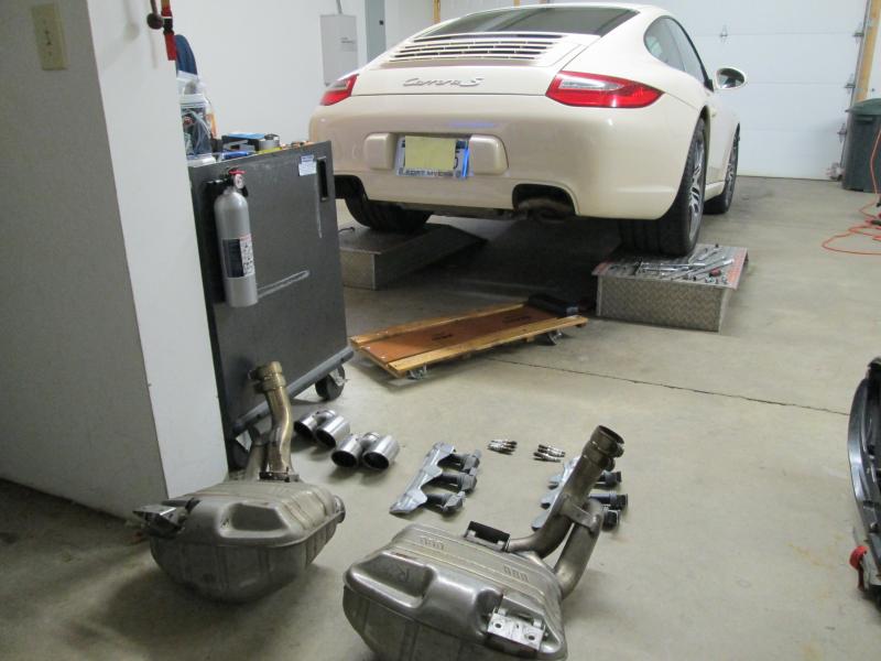

here s how I did my plugs...
LOL, on the right ramp you can see the tools used.
