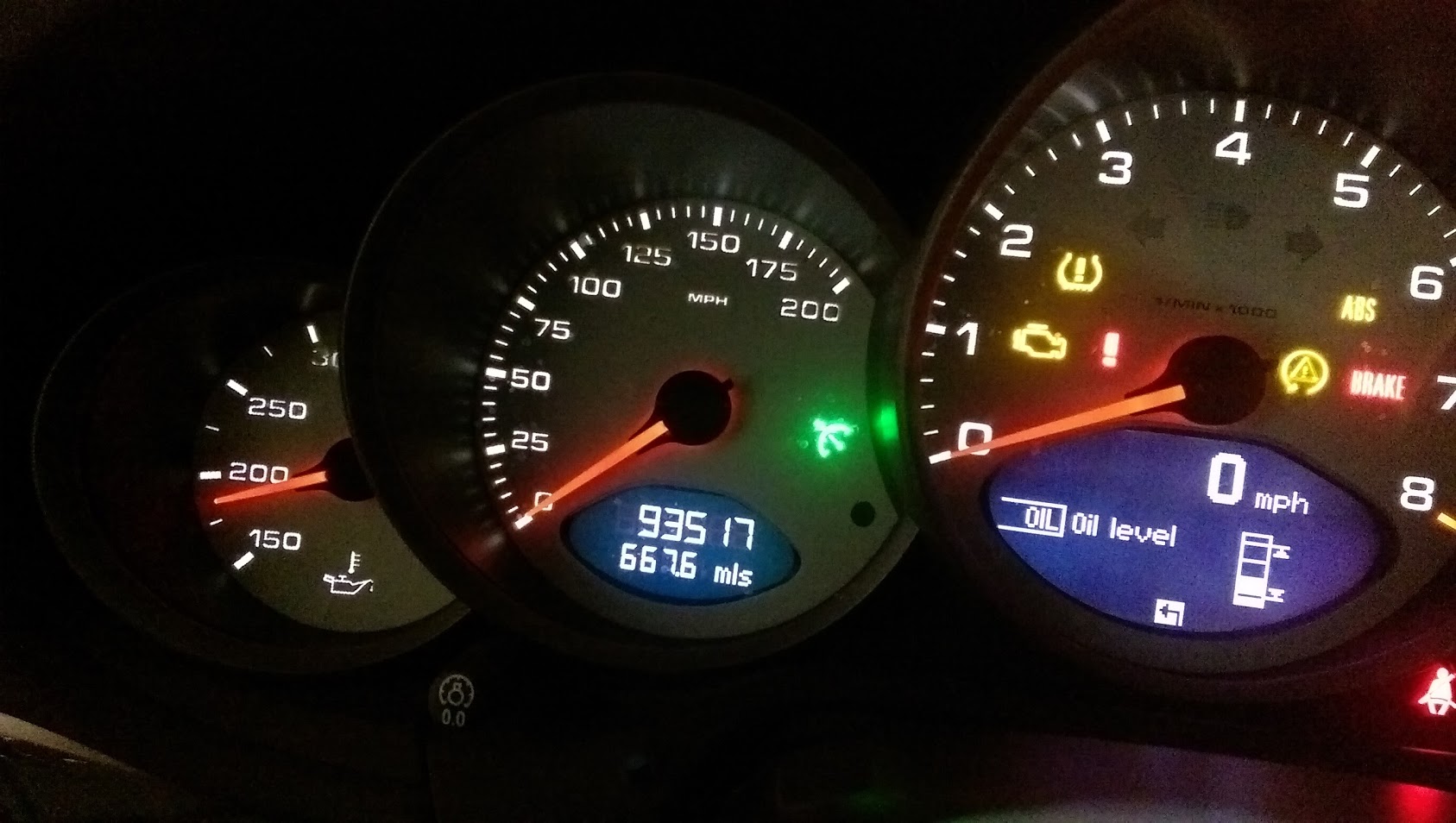

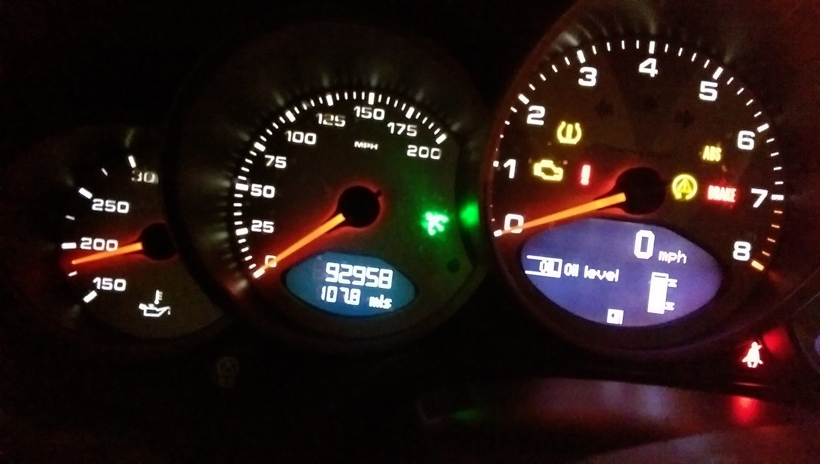

560 miles. 2 bars. I swear before the AOS failure I was getting like 5000 miles before 2-3 bars were gone. I'll ask for the borescope next time I do anything around the cylinders.

Tex, I notice that sometimes my oil guage may read a little differently if I am not at the exact spot in my garage, etc. and I will take a couple readings over a couple days to make sure I am seeing the correct level. Just food for thought. I see you are reading at the almost exact temp. Might I also suggest that you are probably over filled in the first photo, but only a slight bit. As the oil will expand further when it gets up to operating temp (200+). Maybe get the temp up to 200 or 205 and then measure, your 2nd photo might be at the 2nd bar... possibly? Also the oil temp gauge and the oil level gauge have such poor resolution that it may look like you are close to replicating the scenario, but might be off. Don't get me wrong, you do seem to be burning oil, but I am just trying to look at the brightside that it might not be as bad you think.
