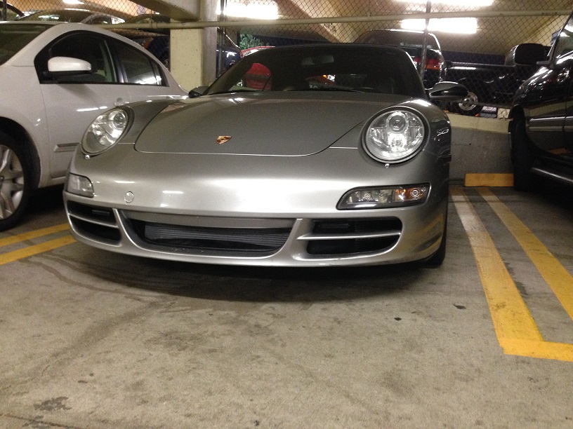

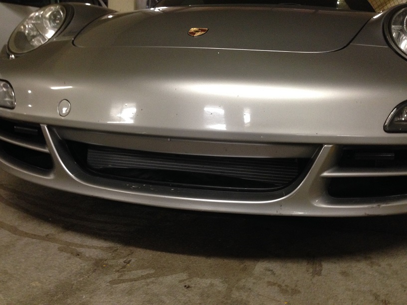

Decided to do some preventive maintenance before the hot summer starts
Jason @ HouseAutomotive was tremendous help from beginning to end. He worked out all the prices with break-downs.
He had the car picked up at my house via flatbed and the crew did a clean and great job !
Definitely recommend HA for all Porsche work
Work done:
- Installed the 3rd Radiator
- Replaced the Water Pump
- Bled coolant
- Replaced the front brake pads & sensors
- Oil Changed
- Replaced the high and low horns
- Total Inspection including charging system diagnosis
They kept it overnight to make sure there are no leaks. When I picked it up, the car was ready to go.
I took the car to Vegas (from LA) last wknd in scorching heat (100+ deg) and the car drove like a champ
No matter how hard I pushed it, I couldn't get the temp to go above 203. (Keep in mind tho that was on the streets/hwys. On track, it may be a different story.)
Sitting in <5mph traffic, it crept up to 225.
The water pump was preventive since there were no signs that it was failing yet. But the Pcar is now 8 years old with 60k+ miles.. so I changed it since I didn't want to worry about it.
I had the plugs and belts replaced last year... so I am good to go for few years on any major work.
Hopefully just oil change, bleeding brakes, and changing tires. knock on wood.
no pics from the shop but took some pics in Jtown parking garage showing the center. lol

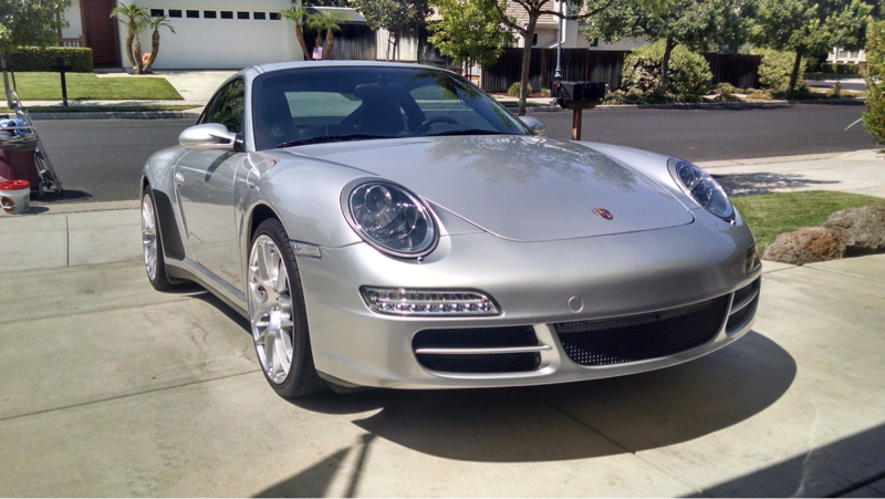

On the 997, I'm a fan of the innie and installed mine by pulling the front bumper... I purchased mine from Rennline.

I partially biased to the outtie as zunsports only has that option for my .2, with a 997 car I'd go innie..nice upgrade btw!

A bit hard to see in the picture, but that is really the point, isn't it?
