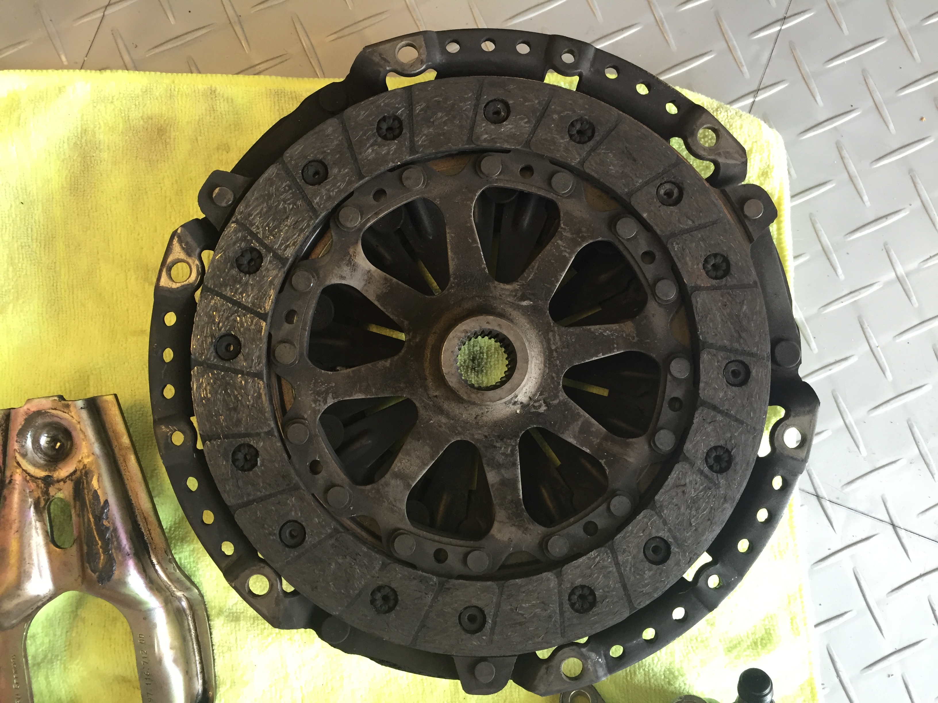

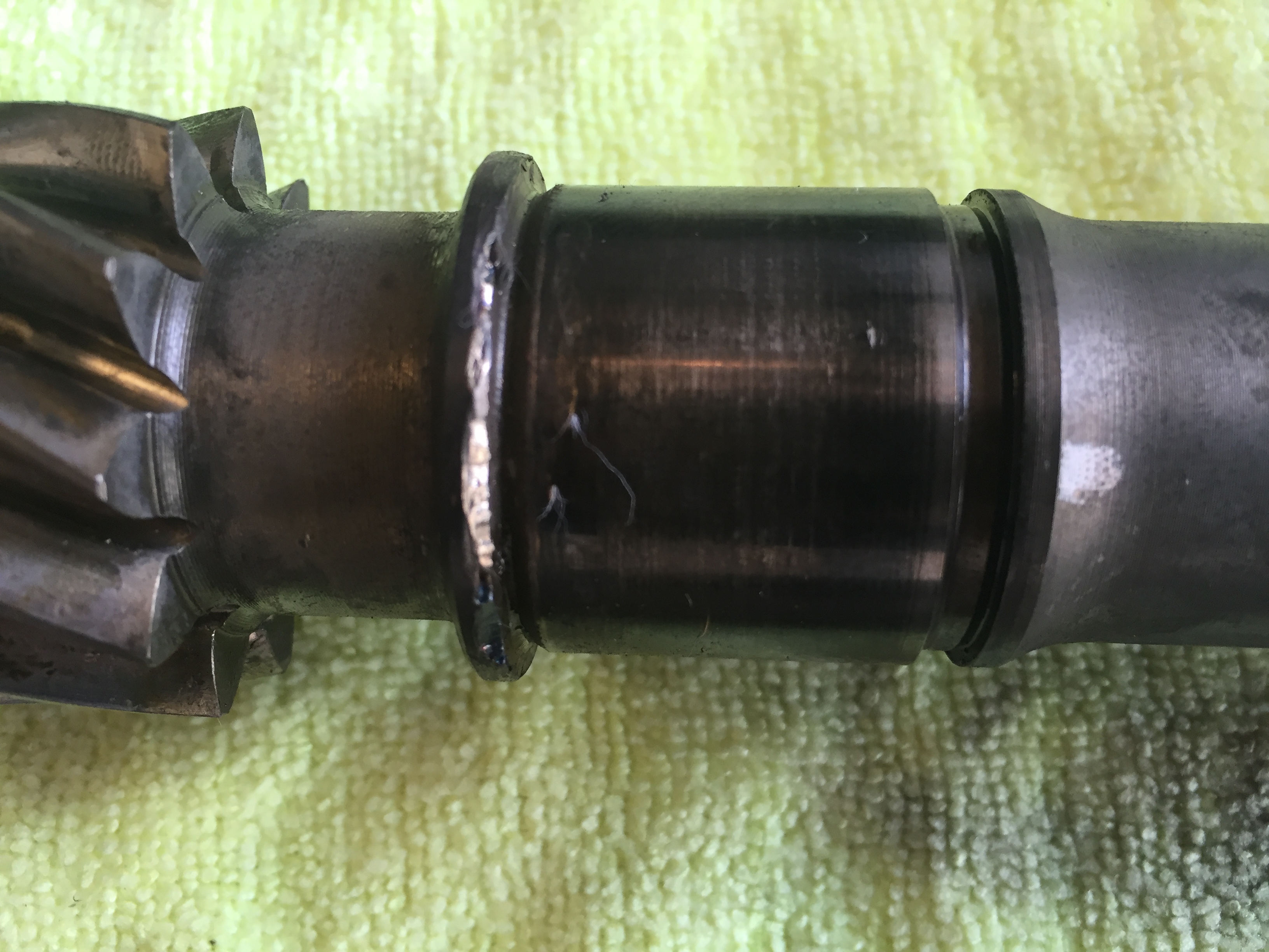

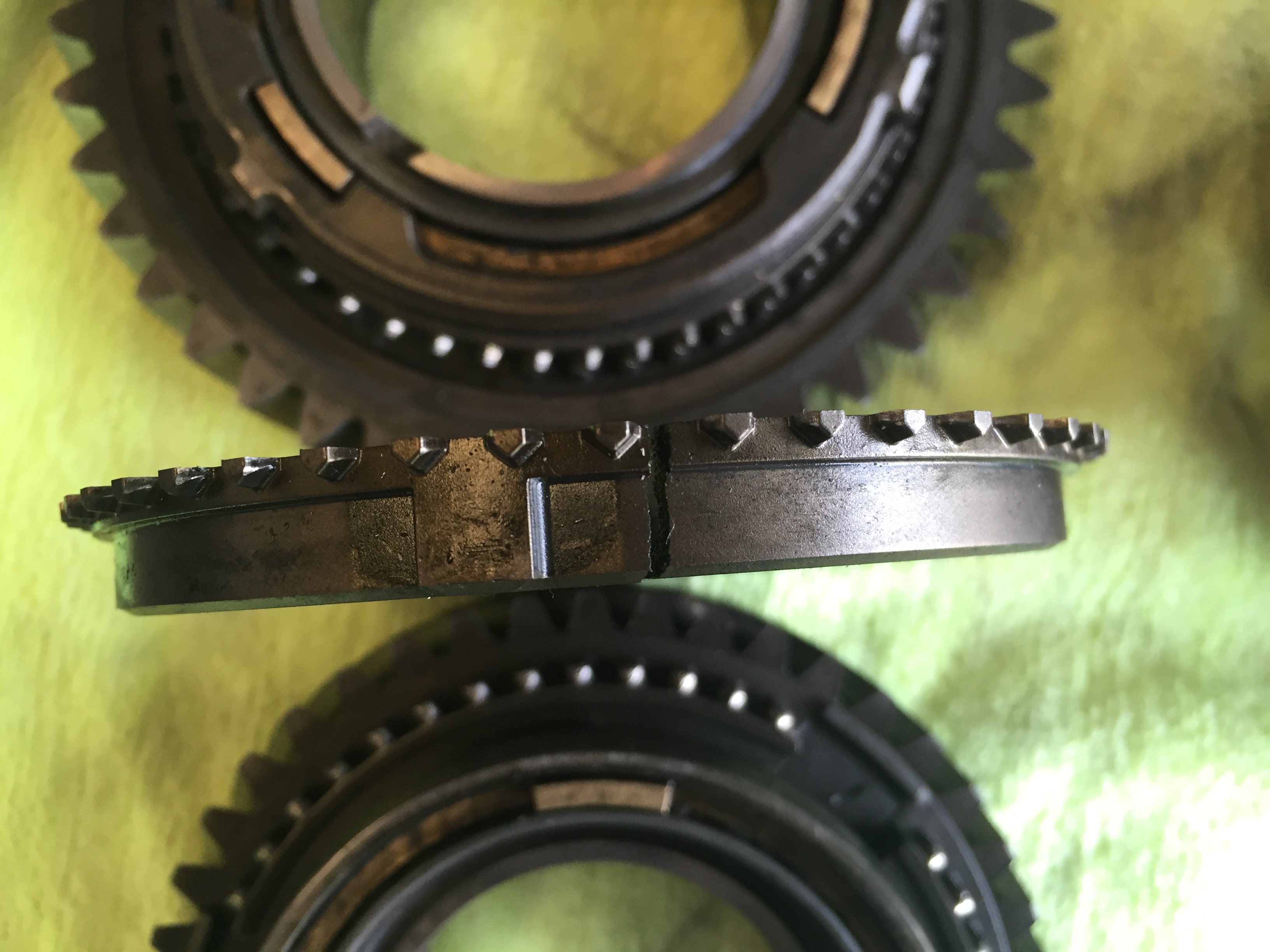

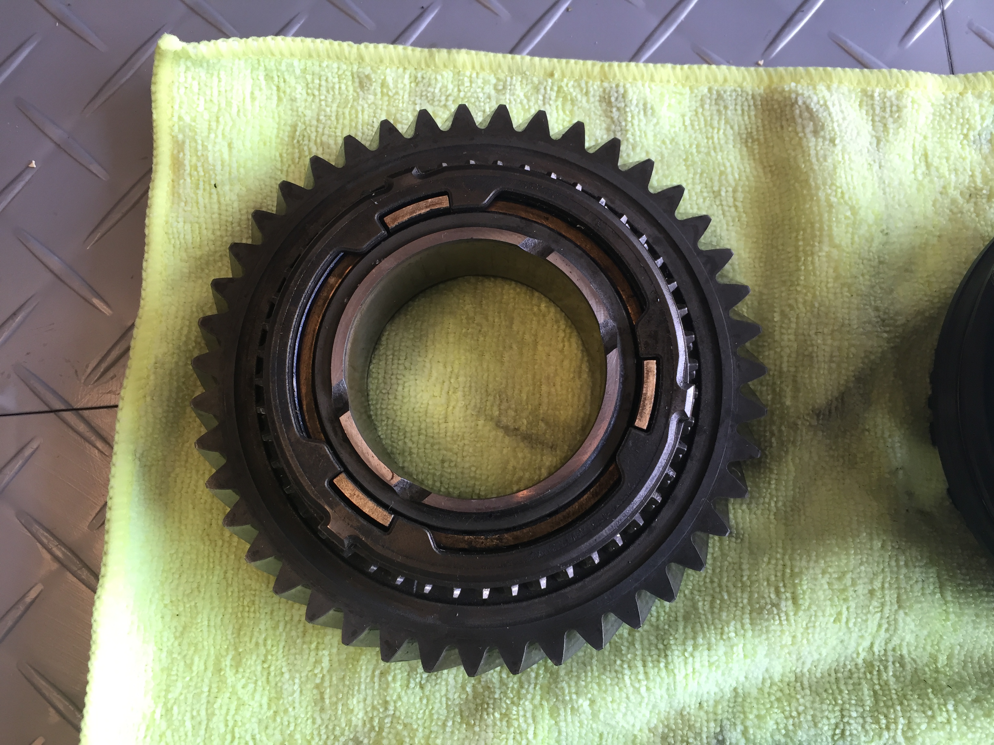

Finally got my baby back today. Tranny is all fixed. As you can see from the pics, I had some work done. I was a bit shocked how worn my clutch was, way past 50%, but the clutch has felt this way since I got it...so previous owner must have been riding it! Since I was getting the syncro's done...clutch was there...needed it! Boy what a difference that made in the overall performance of my car taking off and heal toe shifting!!
Now onto the tranny......
Initial inspection done by dealer confirmed that the syncro was bad...so once the repair shop, Indy in Oakland, CA, Bauer Porsche, opened it up, we found that the pic below was the reason for the failure....broken outer ring! Indy says he never saw that before.
Porsche has a service bulletin about "new style" syncro's that are the only style you can buy now. There was an improvement in the location of where the ring meets the sycro to allow less torque in the same area of the ring when they meet with the gear and match up. That means now I had to replace 1st Gear as well as 2nd Gear along with the main shaft. As you can see from the pic, the main shaft had some wear...glad that was repaired! Indy says this gearing style is similar to the GT3 and if it is...what a great "upgrade" for me!
Shifting is incredibly smooth and easy to do compared to previous shifting. It's more noticeable in 1st and 2nd since that's where most of the torque is generated.
Indy found the main shaft seal also leaking, got that replaced as well. The Selector sleeve & guide sleeve also got replaced along with the slave cylinder since that was worn as well. Used Mobil 1 gear oil, synthetic and didn't opt for anything else. Wish I didn't have to wait two weeks for the job to be done...however it's done and felt good to be back in the saddle again!

Up to 58k right now. Got the car, from the dealer at 18k. When I drove it, the dealer told me that the 4S has a heavier clutch than other models. My first Porsche....I didn't think that much about it.
It's been very heavy the whole time I drove the car. It was heavy because it was WORN!! LOL I felt so stupid when I seen the plate...wow. If I only joined the forum before I bought the car I could have gotten a new clutch from the dealer!
I know how to drive a clutch..been driving them since 17. I know I don't ride them...but the previous owner was an older gentleman, but how do I believe that since the dealer has not been totally honest with me! LOL
