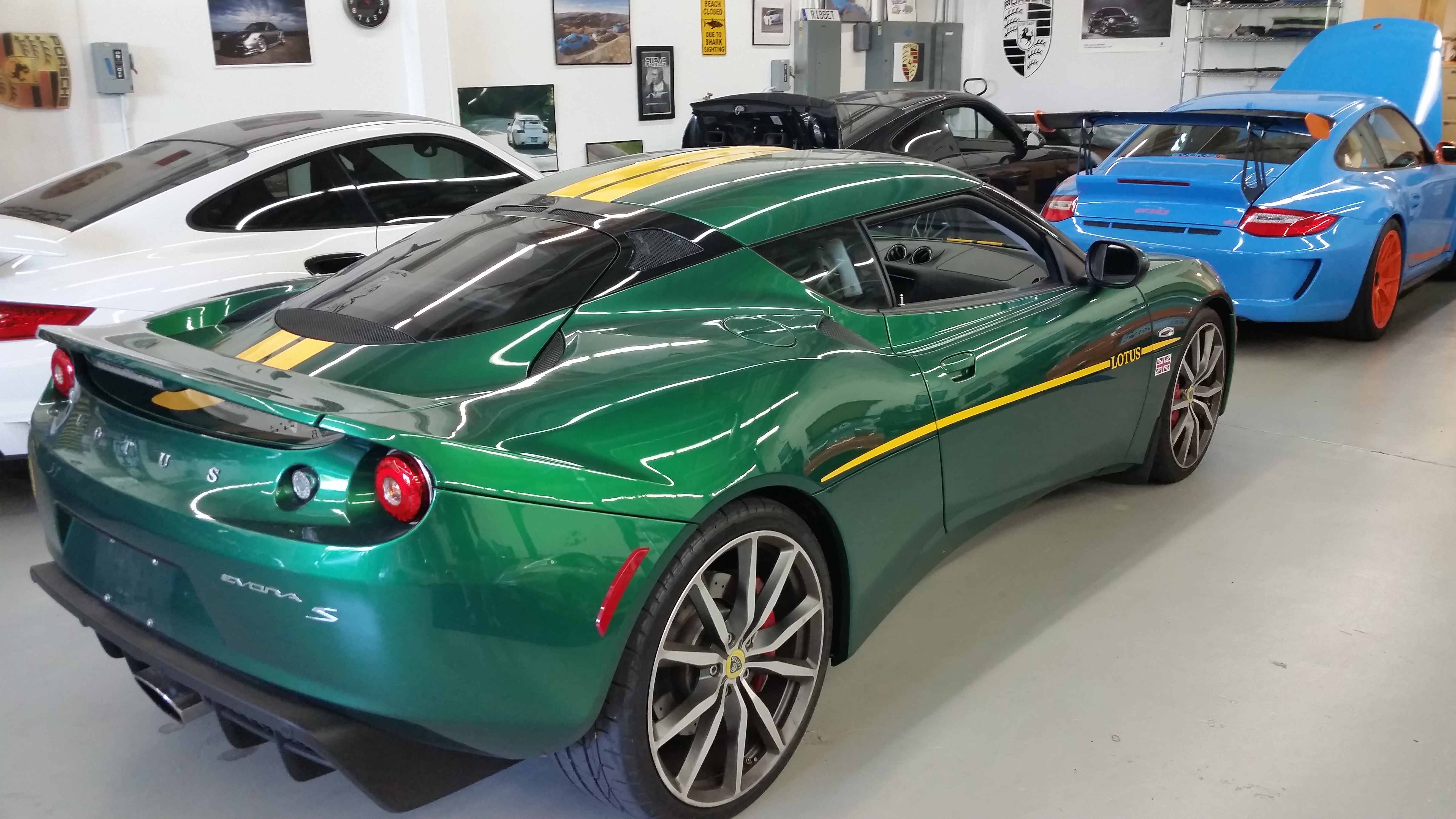

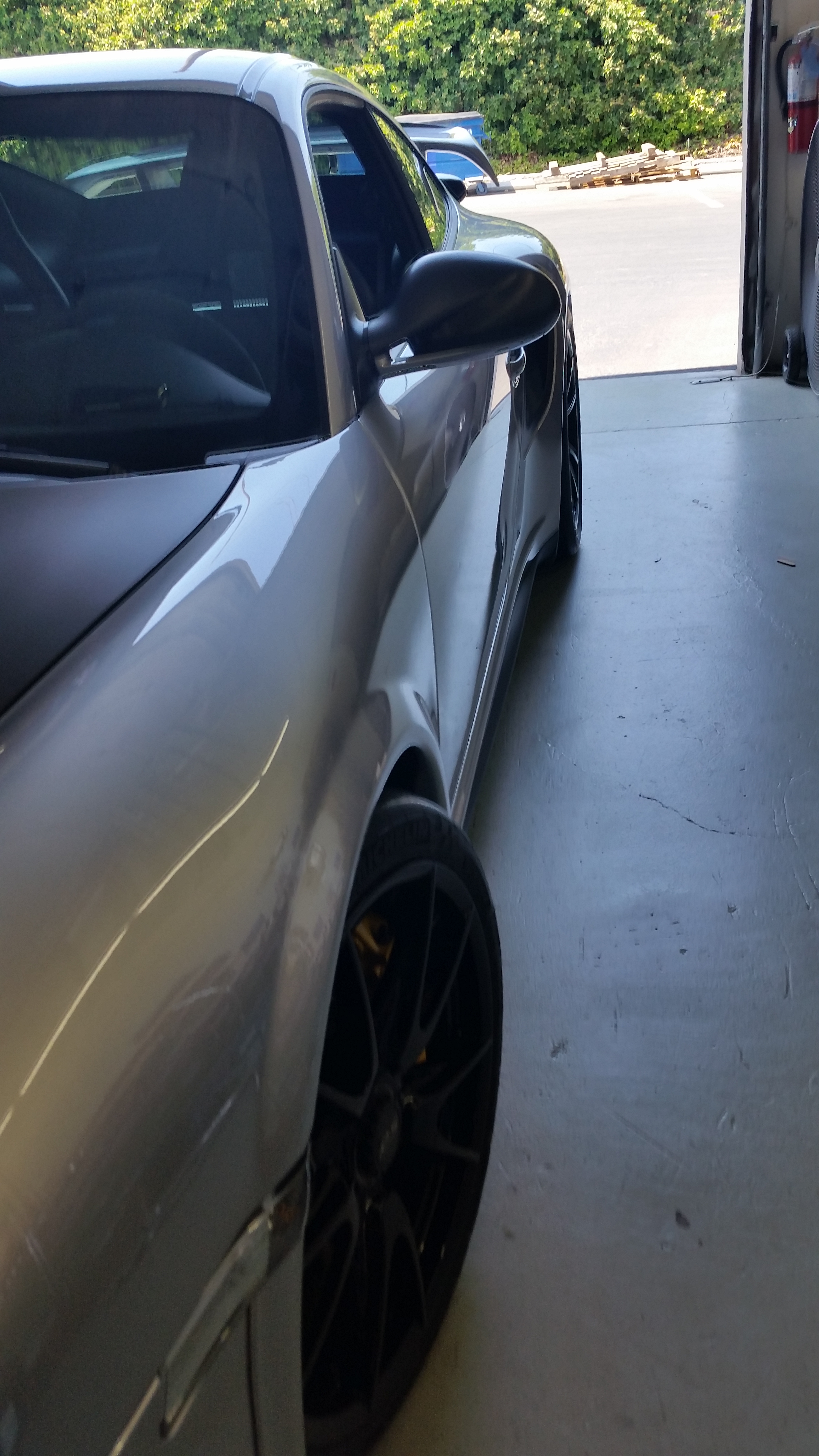

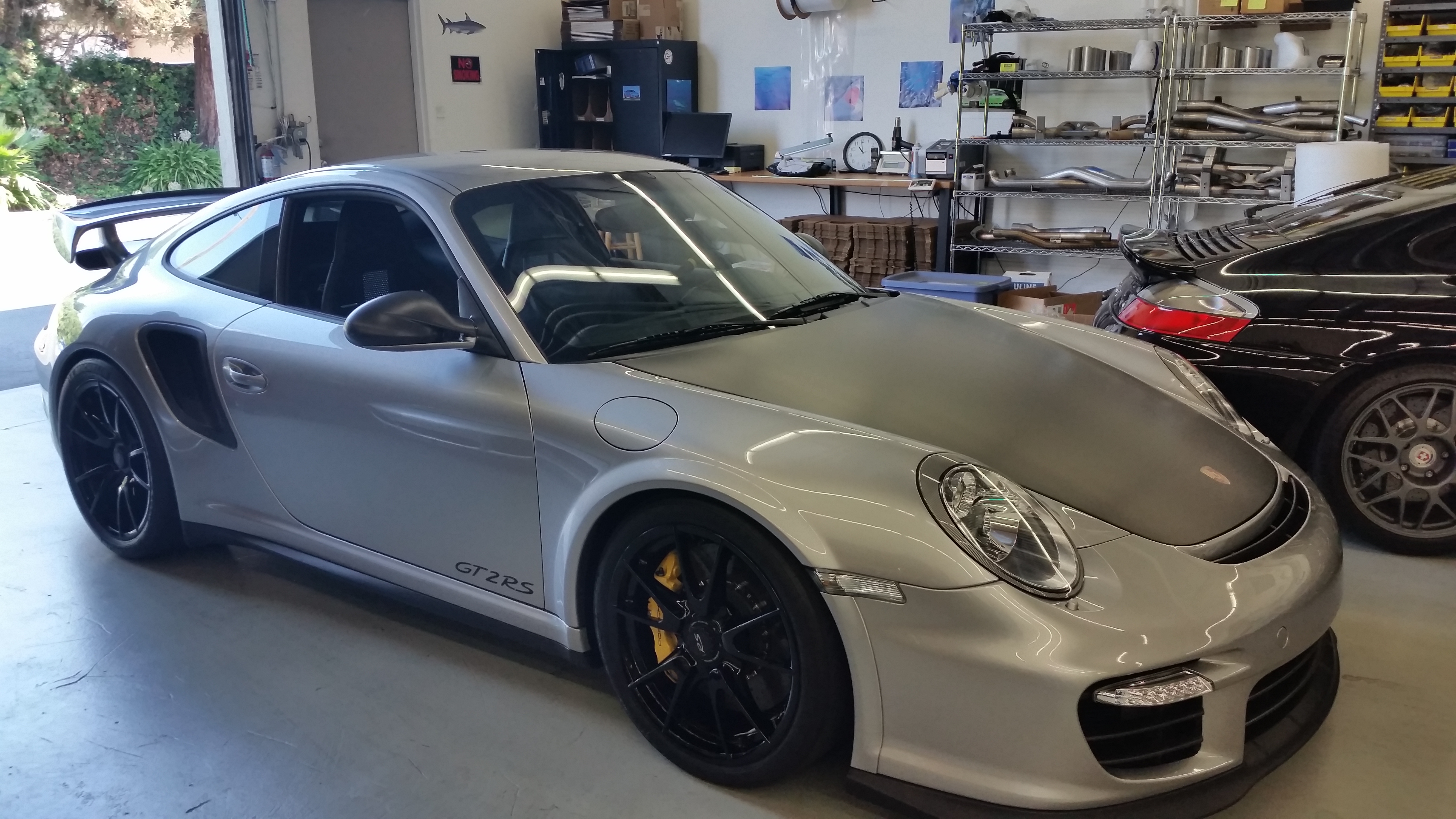

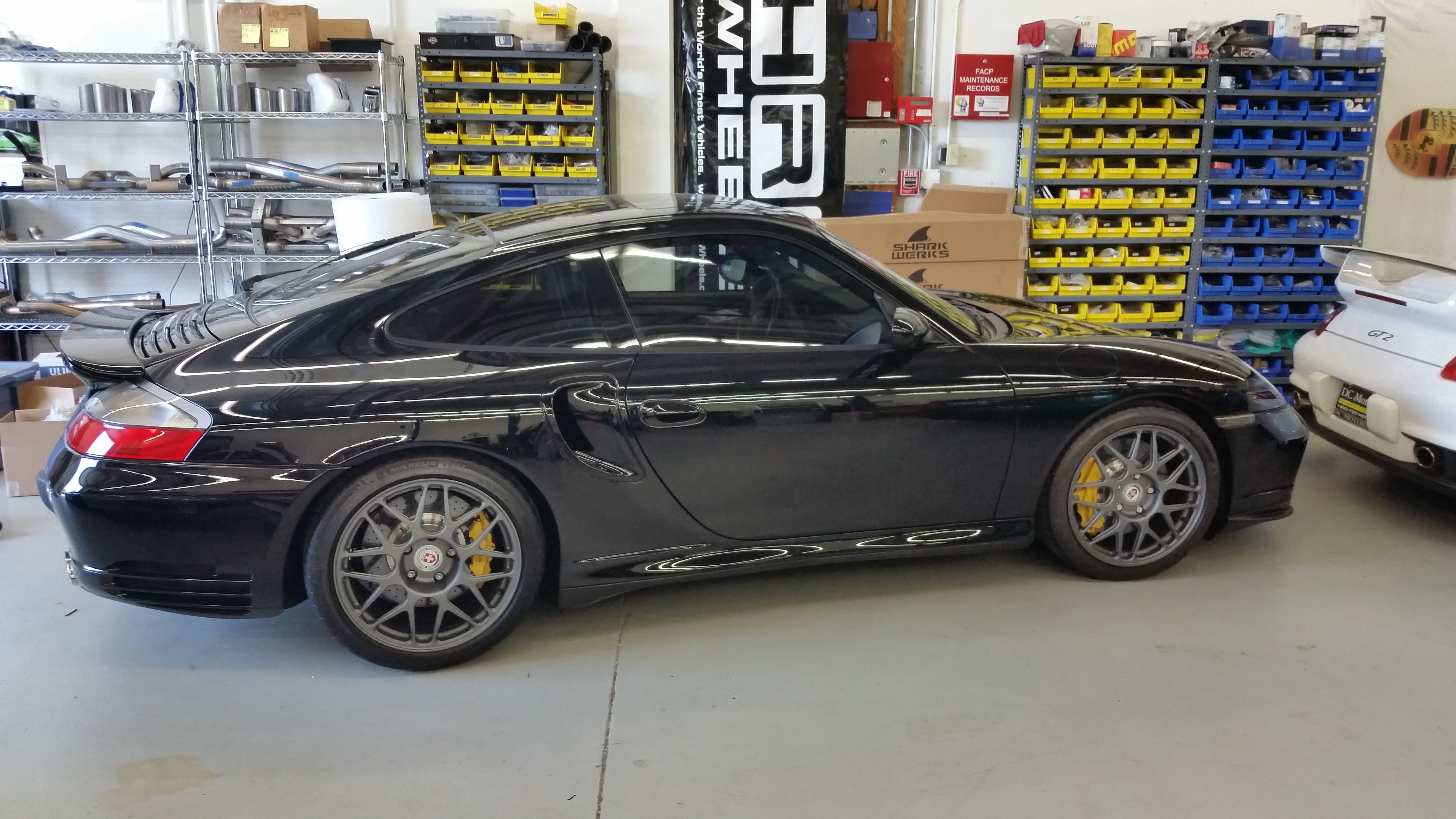

Off the the dealer bada boom bada bing. Back to the smog guy it passes. So, if you have a problem smogging. No matter how much you drive it nothing will get better. Back to your Dealer you must go. Got my reflash back and look at these nice cars in the shop.
