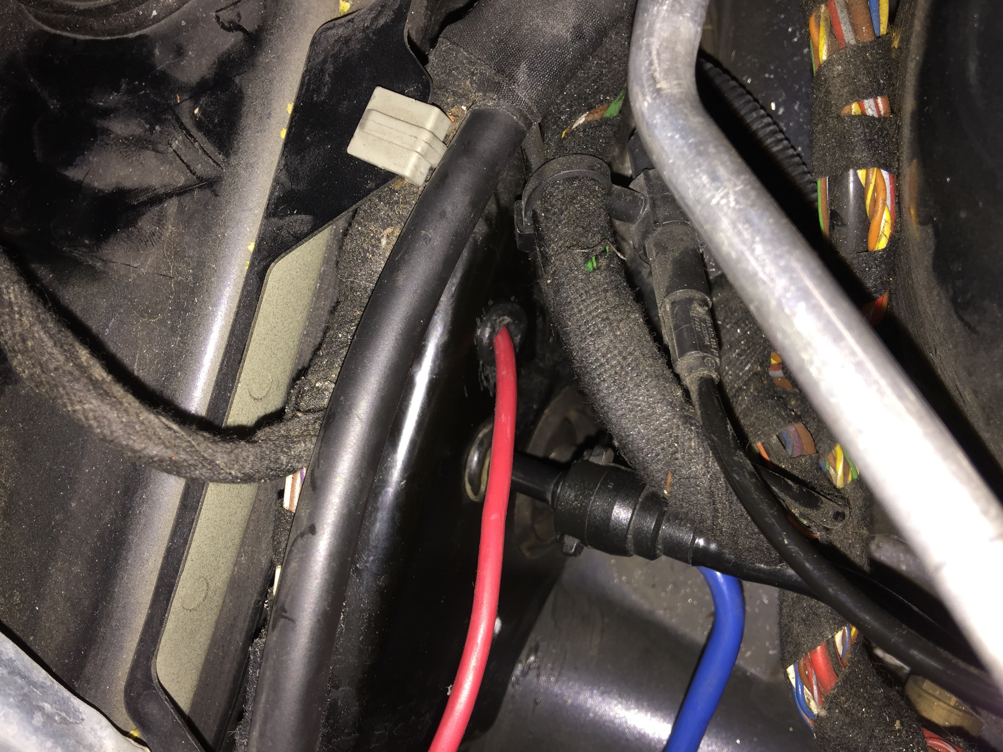

Adding the dedicated lines proved to be the challenge. However, I finally settled to drilling a hole. Hopefully, this info is new to everyone.
Use the location below and ensure you add a grommet. Note: I would have added a negative line along with the positive line. I will someday, but for this time, I skipped that process.

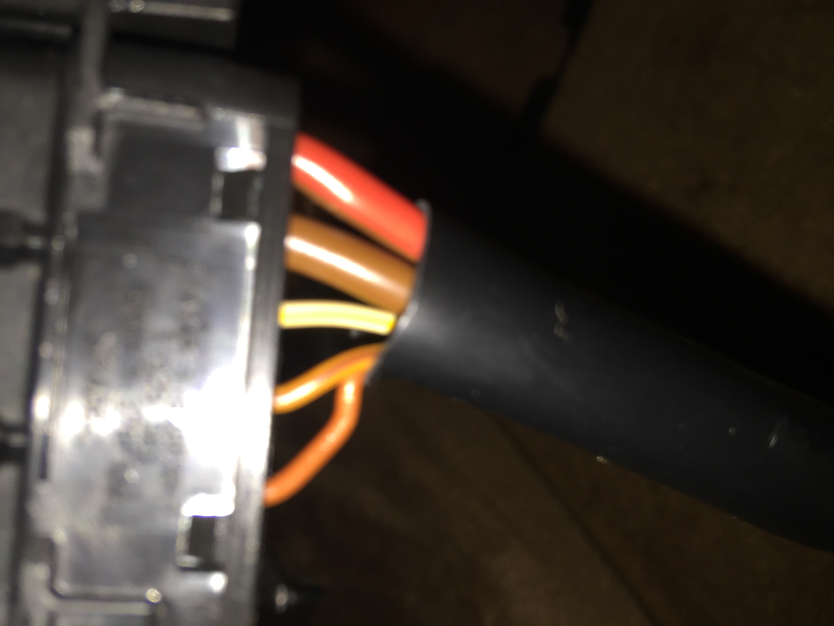

Remove the factory amp and tap into the orange and white lines. The Orange lines are the speaker input and the white line is for remote power. Note that with my setup, the factory sub remains functional and will continue to work in conjunction with the BassLink.

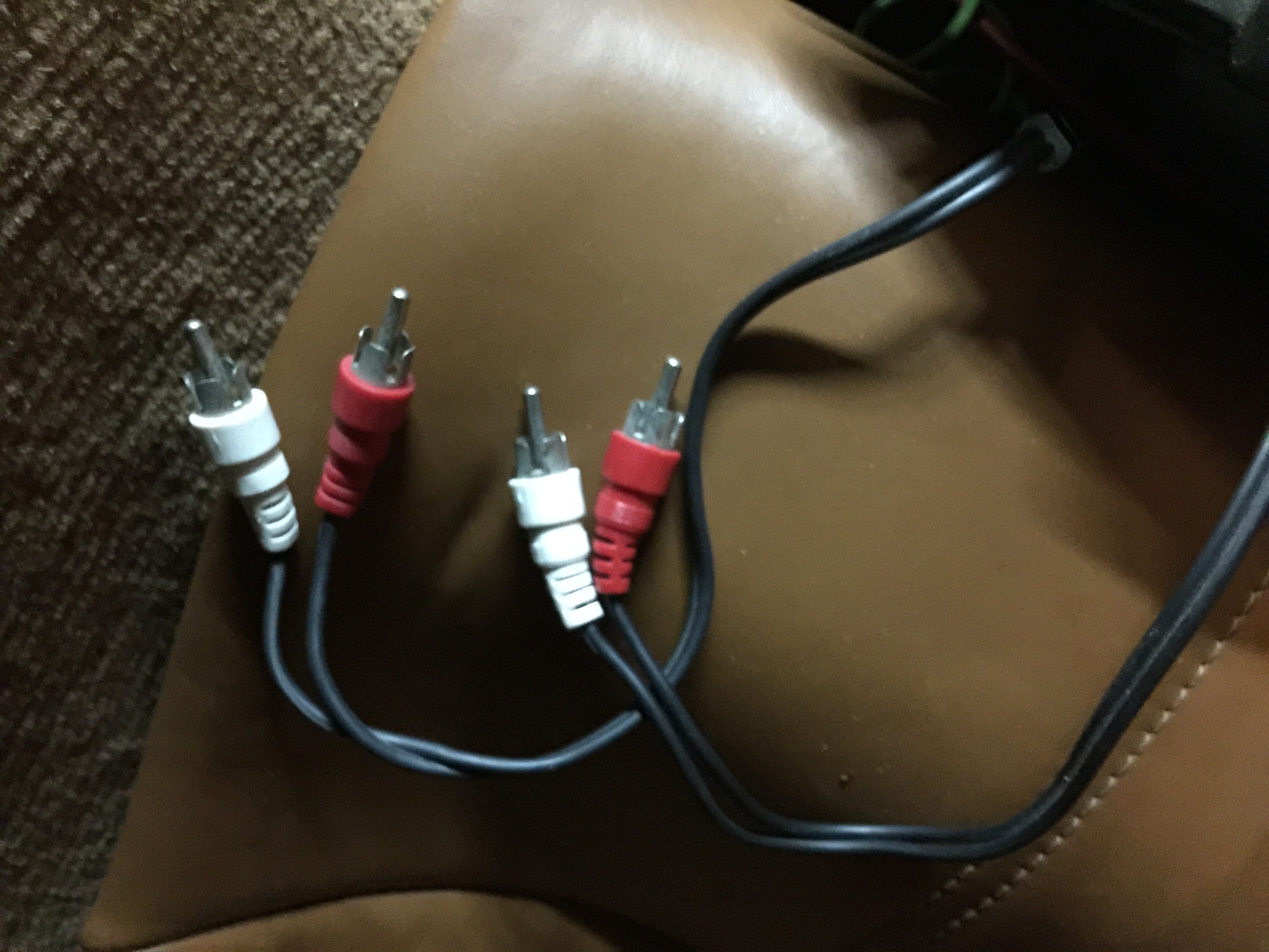

I did not use a line output converter for this project. Using my multimeter, I noticed that the signal from the Orange lines is super low. I then decided to convert that signal into 4 RCA lines. The BassLink has 4 low level inputs: as I connect each one, the bass incrementally got louder.

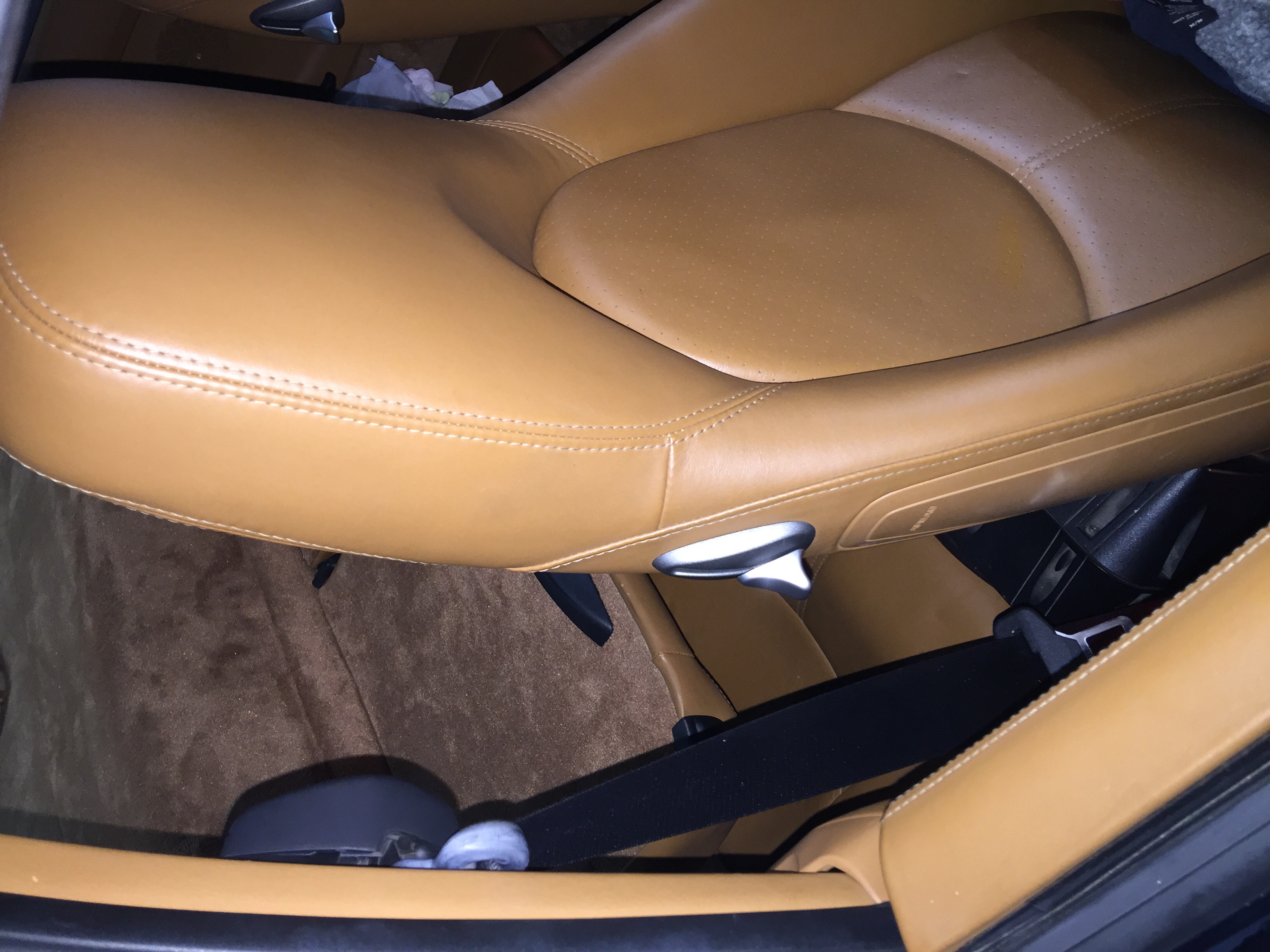

Here is the final product. In my opinion, it's stealth, clean, and it serves the purposes I was looking for.

I must be missing something because I don't see the basslink in your finished picture. Maybe that is a good thing or I am simply blind? Is it wedged right behind the passenger seat, sitting on the floor?

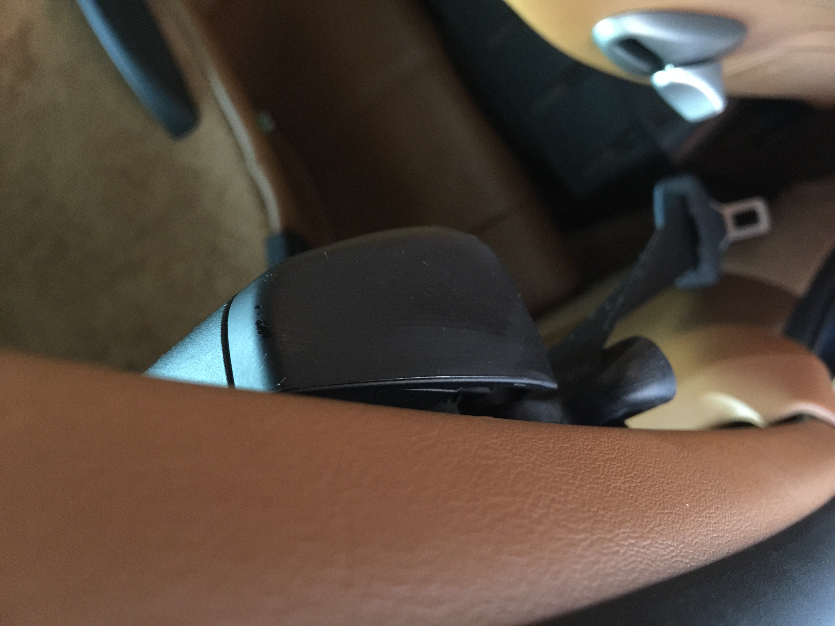

Also, noticed that your seat belt pieces near the B-pillar are pretty oxidized. Mine are too and cracked..not sure what caused that with only 45K miles. But in case I am replacing my belts altogether to address. Just FYI.

It's there in the pic just sitting on the floor. It's wedged behind the passenger seat. I took out the unit's feet to lower it further.

Looking good cab. That thing is hidden. I wish I had that space to spare too. How did you connect the 2 pairs of rca? Did you just solder 2 pairs of coax to The lines from the sub connector. I remember I used speaker level input to the basslink. Which input did you use?
. I think I went overboard splitting that one line into 4 RCA lines.
I just connected them to the Orange lines coming into the factory sub box. You know, the signal into the factory box is way way low --- if you connected them to the high level input (speaker level), I wonder if you even experienced "real sub sound" from the BassLink! Even then, you were feeding the BassLink with just one (1) input!!!!
As I previously mentioned, the BassLink sub output incrementally increased from 1 RCA input, 2 inputs, 3 inputs and finally all 4 inputs. I actually had to adjust the BassLink output via the control ****.
You don't see the BassLink yet you saw the oxidation!!! Wth!??? Hahahaha jk
I just checked and you are correct. That film is like the white film that you see on new tires. I went ahead and applied leather conditioner and it appears to have disappeared. I'll check again tomorrow and see if I need to be a little more aggressive by applying polish and wax.
