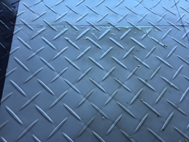

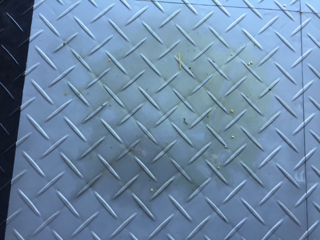

Hey guys......Got my syncro's done for 1st & 2nd gear. All repaired and shifting is buttery smooth!
NOW......there was a puddle of fluid under my car. Since it was a good size leak, per the pics, it's been leaking since I picked it up last Saturday, 10-24-15.
My question is, when I get to the repair shop on Tuesday, what is the most common reason for a leak from the tranny after it's been open?
I will be looking under the car myself when it's on the lift and I'm very curious as to why this would be happening. Maybe there is a loose bolt? Gasket isn't seated right?
Hoping someone has had a leak and can give me insight into this issue!

rear main seal? those are known to leak anyway and im pretty sure that gest pulled when you separate the transmission from the car.
Old Nov 4, 2015 | 07:47 PM
RaidersR1's Avatar
Joined: Jun 2011
Posts: 1,039
From: Brentwood, CA
Rep Power: 61
RaidersR1 is a glorious beacon of lightRaidersR1 is a glorious beacon of lightRaidersR1 is a glorious beacon of lightRaidersR1 is a glorious beacon of lightRaidersR1 is a glorious beacon of lightRaidersR1 is a glorious beacon of light
I had that replaced while the Indy was in there. Turned out that the leak was from the breather because Indy overfilled the tranny.
Hope the leak stops after driving a bit. He drained some fluid but it still leaked when I got home.
I put cardboard on the floor to monitor.

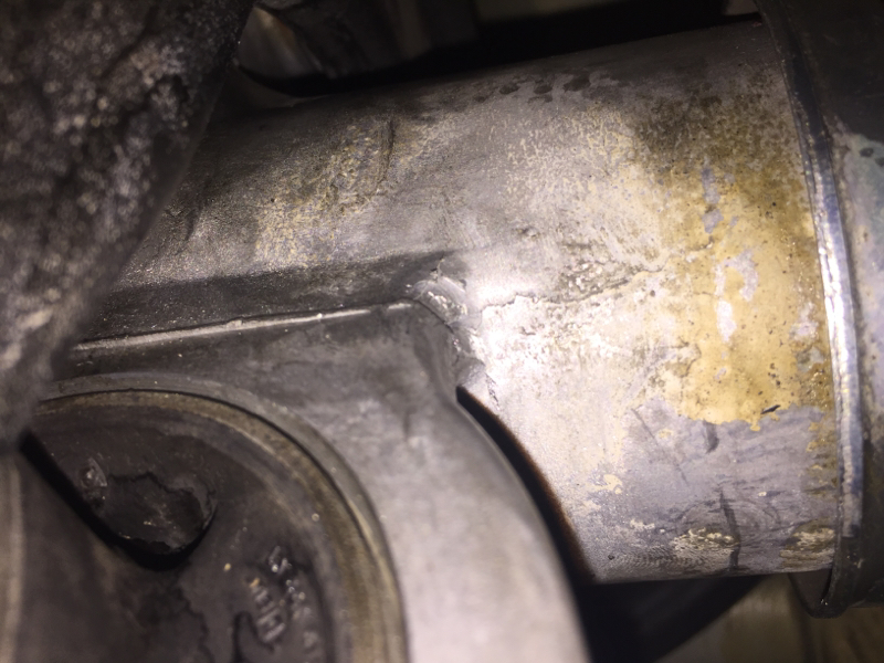

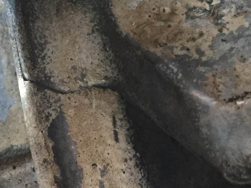

Found the leak.......wish I didn't....
This my friends is a crack in casing!!!

wow, that suck. curious to know what would cause that. car bottom out from suspension, bumpy road ?

So there was no leak, someone worked on transmission and now case is cracked. What do you think happened? And what will they do about it? Or am I missing something.
Old Nov 8, 2015 | 06:05 PM
RaidersR1's Avatar
Joined: Jun 2011
Posts: 1,039
From: Brentwood, CA
Rep Power: 61
I was very upset about this. I flat out asked the repair shop what the hell happen. It was obvious that something happened!!
While the shop would not confirm nor deny the crack...someone there dropped my tranny case and caused the crack. No doubt the repair shop is at fault.
He relented and agreed to purchase a new case and fix this for me. I felt sorry for him somewhat but he needs to be on top of the work being done in his shop.
Waiting for the case to get in and drop off the car and get this fixed.
Took a lot to keep my composure when I saw this crack!!

More pics
