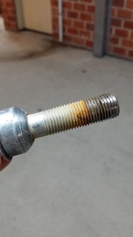

Anti seize is just copper grease right? I was thinking of using some as my wheel bolts look like this, should I replace these or just clean and apply some anti-seize?
Also do you still torque to 96 lbs when using anti-seize?

Here's a snapshot from the manual PDF regarding this.
It looks to me like you could clean and reuse your lugs. Yes, you torque to 96nm with the anti-seize since that they spec'ed the torque reading with anti-seize. The Castrol Optimol TA they recommend in the manual is rather pricey. You can find less expensive alternatives but I don't know if those products meet the recommended specs or no, so you'd want to carefully compare. One tube will last a very long time.
BTW, I've some some posts saying that Porsche upped the torque number a little higher in later recommendations, but I've stuck with 96 with no problems. I figure if it was critical they would have officially notified owners. Here is a thread discussing it: http://rennlist.com/forums/997-forum...heel-lugs.html
