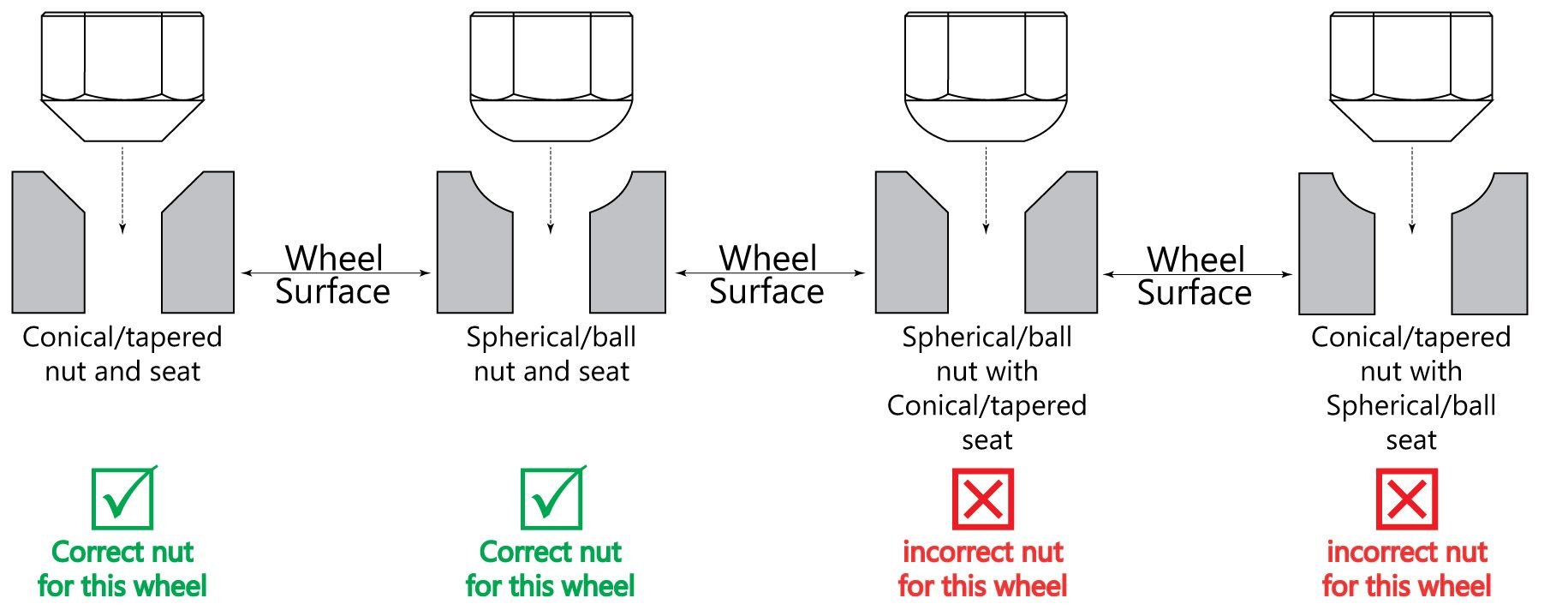

I got these and solved my problem

Never mind. I see you got them from wheel dynamics. I bought my wheels from them. Those are the lugs that should have come with the wheels in the first place! Frustrating. First the damn things come off when I'm driving now they won't come off when I'm not driving !!

Remember when replacing wheel bolts be sure to match the "seat" type to the wheel. Porsche OEM wheels have spherical seats. The ones in that picture above are conical. Not sure what type your aftermarket Ruger wheels have, just check them and match the lug bolts to them.

very good info Semicycler.... That s what I didn t like about that wheel, the fact you had to use different bolts. I doubt they did a better job than Porsche.
