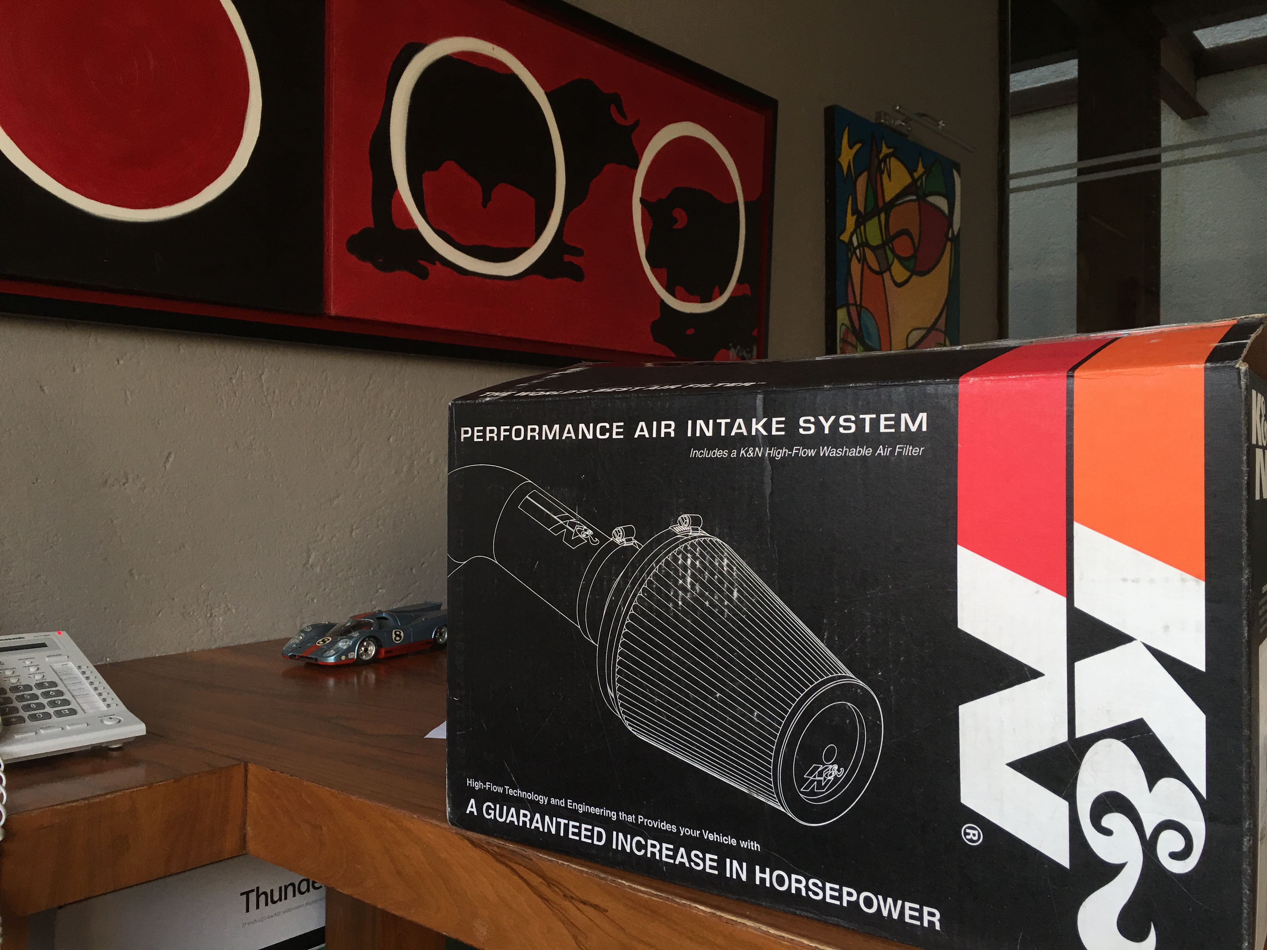

This is what happen after I seen you video review, tomorrow I will install, I hope it sounds like yours!!
Cheers

I must be the only one confused.
Why are u guys replacing the Porsche-designed CAI box with aftermarket air filter that will just sit in the hot engine bay ?

Because of the noise!! (Sound)
Just kidding for what I saw the filter comes with a box seal with the hood or engine bay door, all the other parts are completely seal look like no hot air from the engine will come inside that little box.
I know that the original is design to work in all conditions specially on hot climates, any way the specs of the filter gains 23.8 hp.
Cheers
Awesome!
I think you are going to be very happy with the sound, better throttle response, and nice power increase in the mid range. It's a screamer from 5000-7000rpm
with any new intake modification you may want to reset your ecu by unplugging the battery for a few minutes. The computer will reset and then go for a 30 minute drive for the ecu to learn and adapt to the new higher air flow. Try to drive and accelerate all the way to redline in several different gears. Part throttle and full throttle. This will help the ecu plot some new fuel maps to work with the new airflow.
I also would highly recommend buying some "CRC Mass air flow cleaner" spray. Clean your mass air flow sensor real good and you should run like a champ in no time.
If you do not reset the ecu right away then you may notice a rough idle the first time you start it up with the filter on. This is just the ecu adapting and you need to take the car for a nice drive for the ecu to adjust.
Please let us know what you think after a few days running it through your favorite canyons
if you drive your car in the rain a lot, make sure to put the water repellent jacket over the filter!
