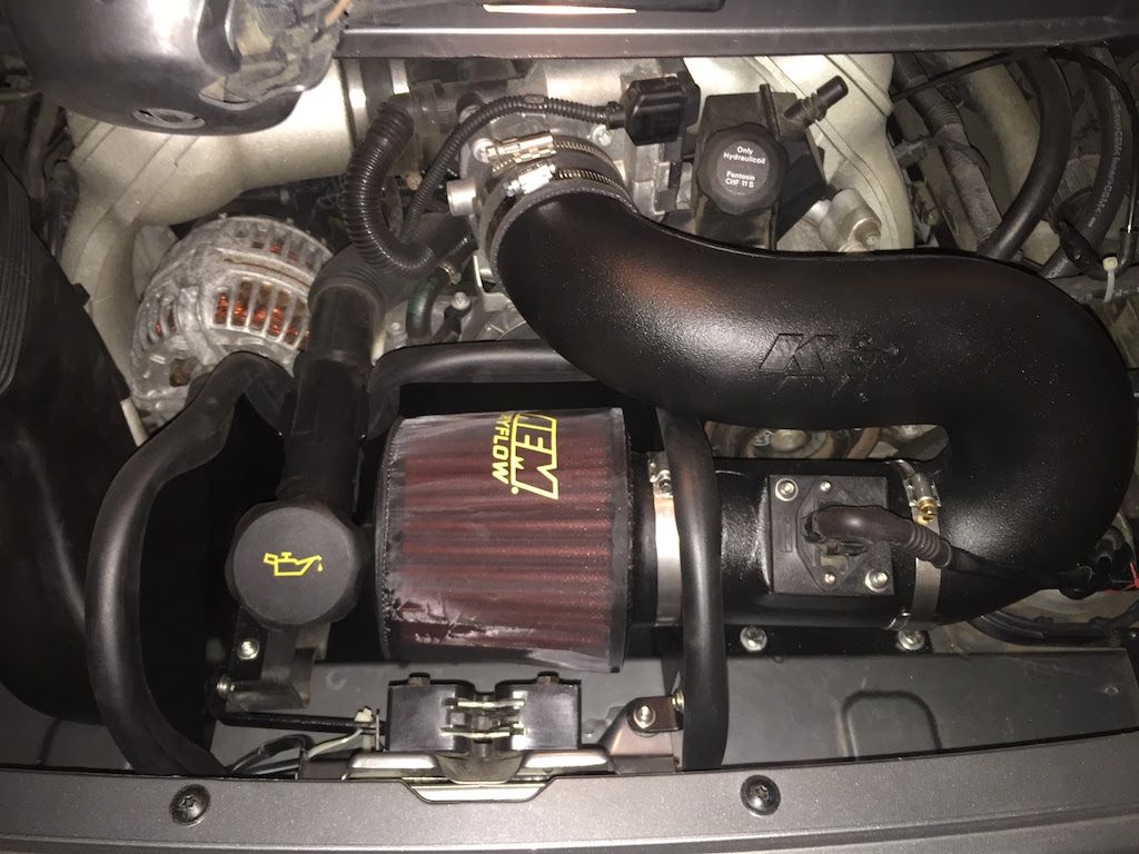

Installed the K&N Intake today. I bought it here as it was the best price I could find. It showed up in 2 days with free shipping so no complaints! http://www.uspmotorsports.com/Engine...6-Carrera.html
I read extensively about the K&N (the pros and cons) and decided I would also get an AEM filter and water cover. The K&N filter I received seemed pretty darned dry so I think the risk of it founding the MAF is low. The AEM is more coffee can shaped and the K&N is conical. Given how the heat shield is designed and the location of the air snorkel feeding the chamber, the K&N might be a better shaped filter for this installation.... I will experiment with that in the future to see if the different types of filters make a difference in performance or sound.
The install itself would've been made MUCH easier with a larger/better detailed exploded diagram, but it really isn't that difficult. Taking my time, I completed the job in 2 hours. Almost all of the nuts, bolts and washers are the same so you can't mess that up. The 2 remaining things I need to do are: figure out what to do with 2 largish plastic washers that are leftover and adjust the intake nozzle so that it seats more cleanly with the hood....it seems to catch right at the top of the trunk. This is also a pretty comprehensive video of someone installing this intake on a 996 on YouTube
Also, I need a better technique for zip tying down the left hand side of the heat shield. I left the L-bracket on thinking it would make a better zip connection closer to the trunk latch but I see in other photos that the L-bracket has been left off... What I've done holds OK but a modest yank will dislodge the zip ties.
So now the driving impressions: today's weather on Long Island was 38 degrees with winds gusting to the mid 30 mph so I had a cold air intake no matter what. As mentioned, there is almost no difference in sound or power at low RPM's (I couldn't tell if the engine was sluggish off the line from warm air because it was just plain cold out). Also because of the wind, the only time I really heard the intake "woosh" was above 5.5k RPM. Hopefully tomorrow it will be warmer and less windy so I can take it out for another spin. I drove maybe 45 miles on backroads and the highway and hit redline or close to it in most gears 1-4. The sound was definitely there, and it sounds awesome! It did feel like the car had more throttle response but I can't be sure if this was because I disconnected the battery and the car was re-learning things. By the end of the drive I was having a harder time discerning how much more throttle response was actually there and how much was a result of 'Proud-Poppa Syndrome'.
I am going to keep this mod for a while and see how it evolves as the weather gets better and I drive the 911 more. I'm also curious to see how it handles stop and go summer traffic because that will be the real test.
