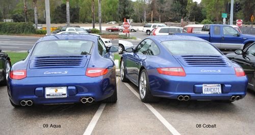

Fronts are completely interchangeable between 997.1 and 997.2. Rears require the tail lights to be changed too I believe. Not entirely certain though. This assumes of course NB to NB and WB to WB. Mixing NB and WB rears does not work.
Random picture on the Internet. Notice the dip on the 997.2 tail lights on the left:
