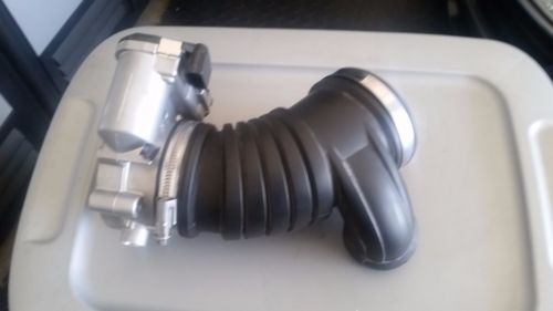

The stock airbox rubber connector will slip on over the GT3 throttle body. I did it and will attach a photo. But going back to oem airbox means going back to the not so exciting sound too...

oem air box connector attached to GT3 throttle body
