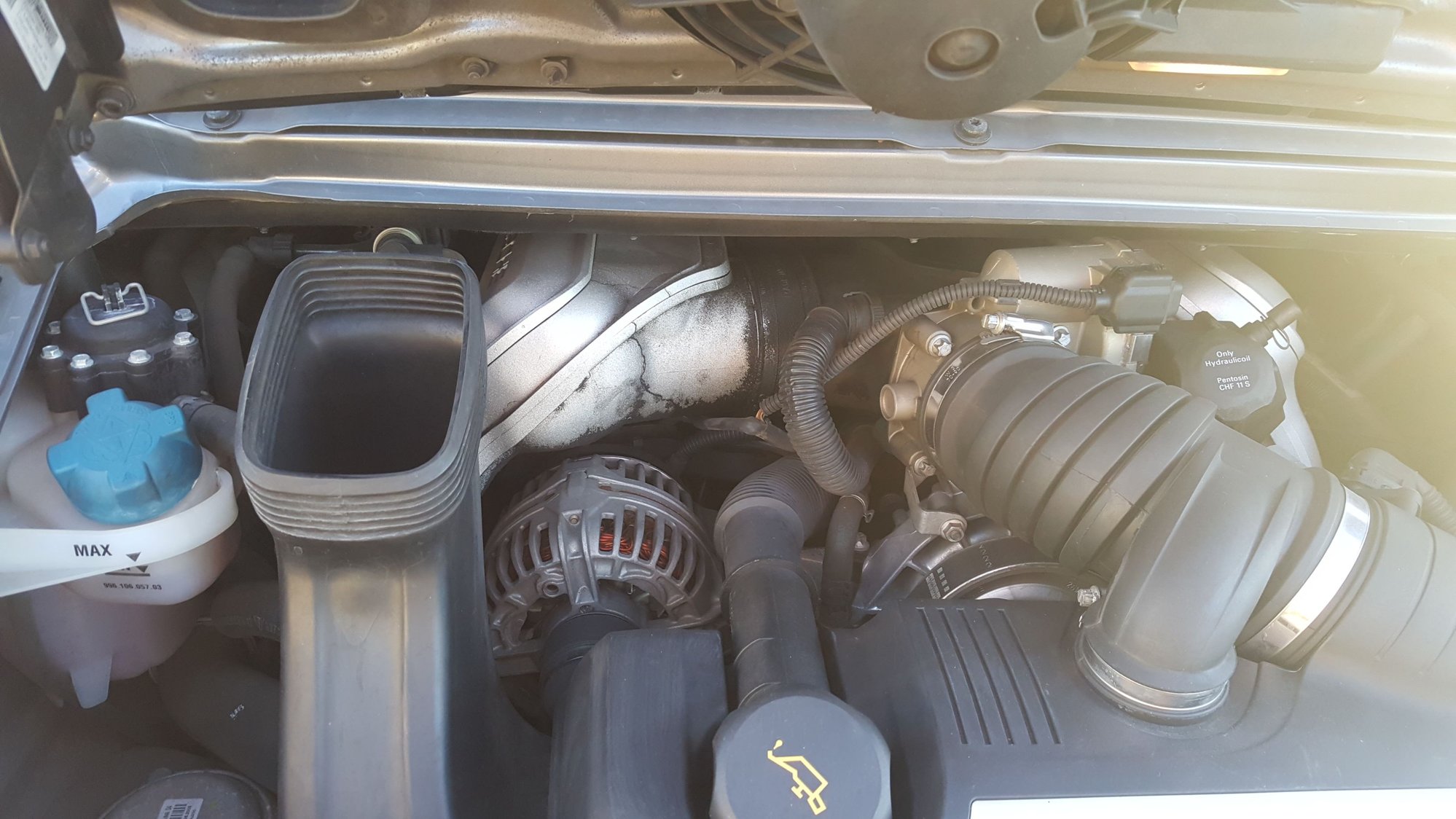

Got to see the car, took a look at the engine. Oily residue on the left intake. Thoughts?

If this is the car in question....an 06 with only 36k miles on it...id say its
on the pig dirty side.... even the underside of the engine cover, and the inner quarter panel... 4 owners is not unusual for 10 or 11 year old car...many of these are weekend toys.... this one given the miles obviousely was not driven.
If you buy it,,,, the water pump should be changed out given the mere age of it.
I have a neighbor with a 07, hes a slob and doesn't even vac his interior, and his engine looks exactly like this, but his car has twice the miles as yours.
that residue your pointing out looks more like basic dirt/road grime residue to me.
Did you drive it yet? observations?

Great comments yes thank you this is the car in question. The car drove great stopped great and the clutch is just fine. My enthusiasm for the car dropped significantly when I realized that the front driver fender had been resprayed and the entire passenger side of the car had been clear-coated. The silver flake doesn't match entirely and there is clear coat on the rubber trim on the roof.
What really bothered me on the oily residue on the intake is that the passenger side intake was completely pristine and clean. I would assume that if it was just residue it would be consistent over the whole motor but this is only on the driver side.
