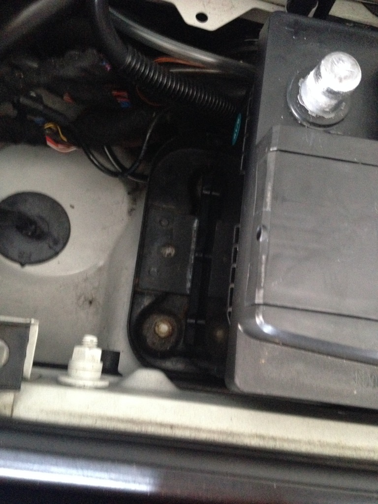

Battery Replacement - New battery covers up fastening screw hole
old battery
new battery covered up where the thread was to screw in the plate.
http://s537.photobucket.com/user/halperin/media/IMG_5551_zpslhhyhrbi.jpg.html"]Name:  IMG_5551_zpslhhyhrbi.jpg
There is about an inch and a half of room for the battery to move around and so far driving it like this it has not shifted a ton. Is this bad to leave like this?
Solution someone recommended, other then getting a new battery, was to place about a 2-3 inch circle of this on the left side underneath the battery and let it side over night to act as a glue/adhesive.
https://www.amazon.com/Permatex-82180-Maximum-Resistance-Silicone/dp/B0002UEN1U

Well you purchased the wrong size. OEM size is H7/94R, looks like you bought an H8 which is an inch longer than the H7. Some folks use the H8 and use the 3rd hole but modifying with a nut. if you ever track you may be required to have a proper hold down so I wouldn't recommend gluing or leaving it un-clamped.

I had auto zone look up the proper ones and they told me to get that one but yeah over sized. The cars only use is for daily driving, if that makes a difference in solution.

It's probably not going to go anywhere unless you're in some type of collision...I'd still want it clamped properly. Did you hook up your vent tube - picture isn't clear enough for me to tell although it doesn't look like it.

+1 install your vent tube
The other holes have a nut attached to the bottom of the tray. The last hole as you have found out does not. So take the mounting bolt to the hardware store and match a nut to it (metric). Then mount it from below. The bottom tray is removable after you take the battery out. It shouldn't be that hard to figure out a solution.

Bad practice to drive around with a loose battery and could cause other issues, a short if it contacts something, fatigue of the battery cables, etc. I see 3 options for you:
  1. Return the incorrectly sized battery and get the correct size
  2. If the remaining hole doesn't line up correctly, you can remove the tray, as semicycler says, and drill a new hole in the appropriate position for the stock hold-down to work correctly
  3. alternatively, you can go to your auto-parts store and maybe find a different sized hold-down that works with the one exposed hole.
If you'll be utilizing either a newly drilled hole or the existing last hole that doesn't have a welded nut, it's not too difficult to set a nut under the tray in the correct position (or temporarily tape it) and they you can actually use an open end wrench slid under the tray to hold the nut once you get the bolt from the top started into it. I think it did it this way on either my car or my wife's when going to the Optima Batteries.

ya, for some reason the smaller h7 is more expensive. but anyways if there is no harm in having the bigger size, i think i can use some plyers to hold a nut underneth the tray and use that 3rd hole. if not, i guess i will take it back. i am trying to avoid going back out there and lugging batteries in and out. thats why i thought the glue option was viable. it will hold it in place and can be ripped up when i change the battery again.

The battery wants to be secure. If it is loose it will shift about in the battery box.While it probably won't fall out this can wear the battery plastic and the base case could leak (acid).
Not what you want to risk.
Either find a way to secure the current battery properly using the hold down hole and the battery hold down or get a proper sized battery that can use the proven/tried and true original hold down so the battery is secure.

My battery became loose and it would make a thump when I brake. Over time, the connection can get loose and battery life is compromised due to the acid sloshing around excessively. If you insist on keeping the battery, you need another clamp

Thanks all. Was able youse some plyers to hold a nut underneath and secure the clamp down. Wasn't that hard after all.
