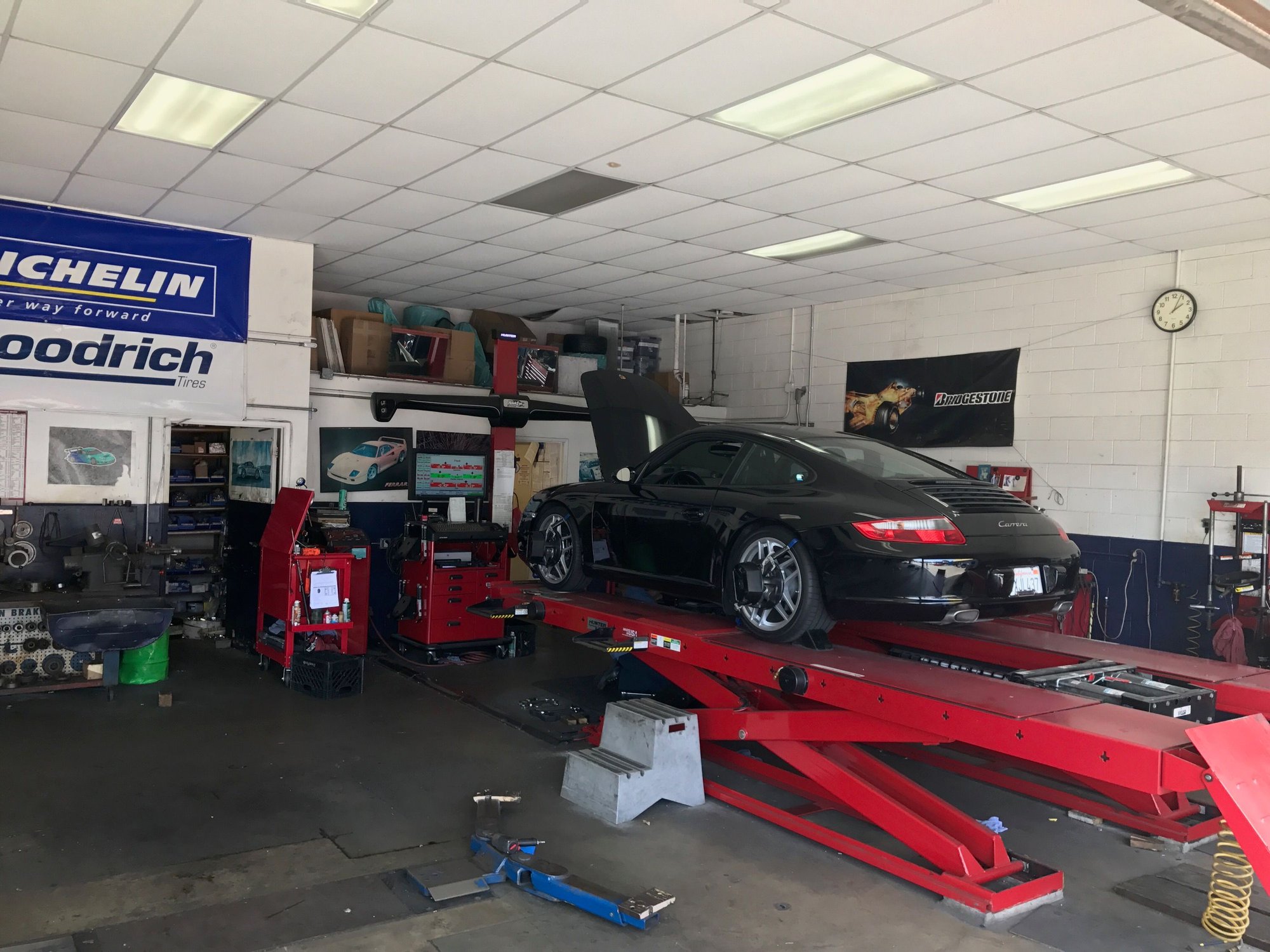

I installed mine yesterday and took it to the alignment shop as soon as I had it out of the garage. I'm still dialing it in but all of the recommendations on this thread have been very helpful.
It's a very straightforward job if you have the tools and space. 4 hours for the front and 3 for the rear.
The time-consuming part was finding all of the torque values. Here is the link that helped me the most.
https://drive.google.com/file/d/0BzY...lIV1pGRUk/edit
(I am using jack stands the jack is just there for safety)
Alignment at Stokes in Santa Monica
I may drop the front 10-15mm but this is the height for now.

Is that before or after? It looks like the Non-S stock ride height
