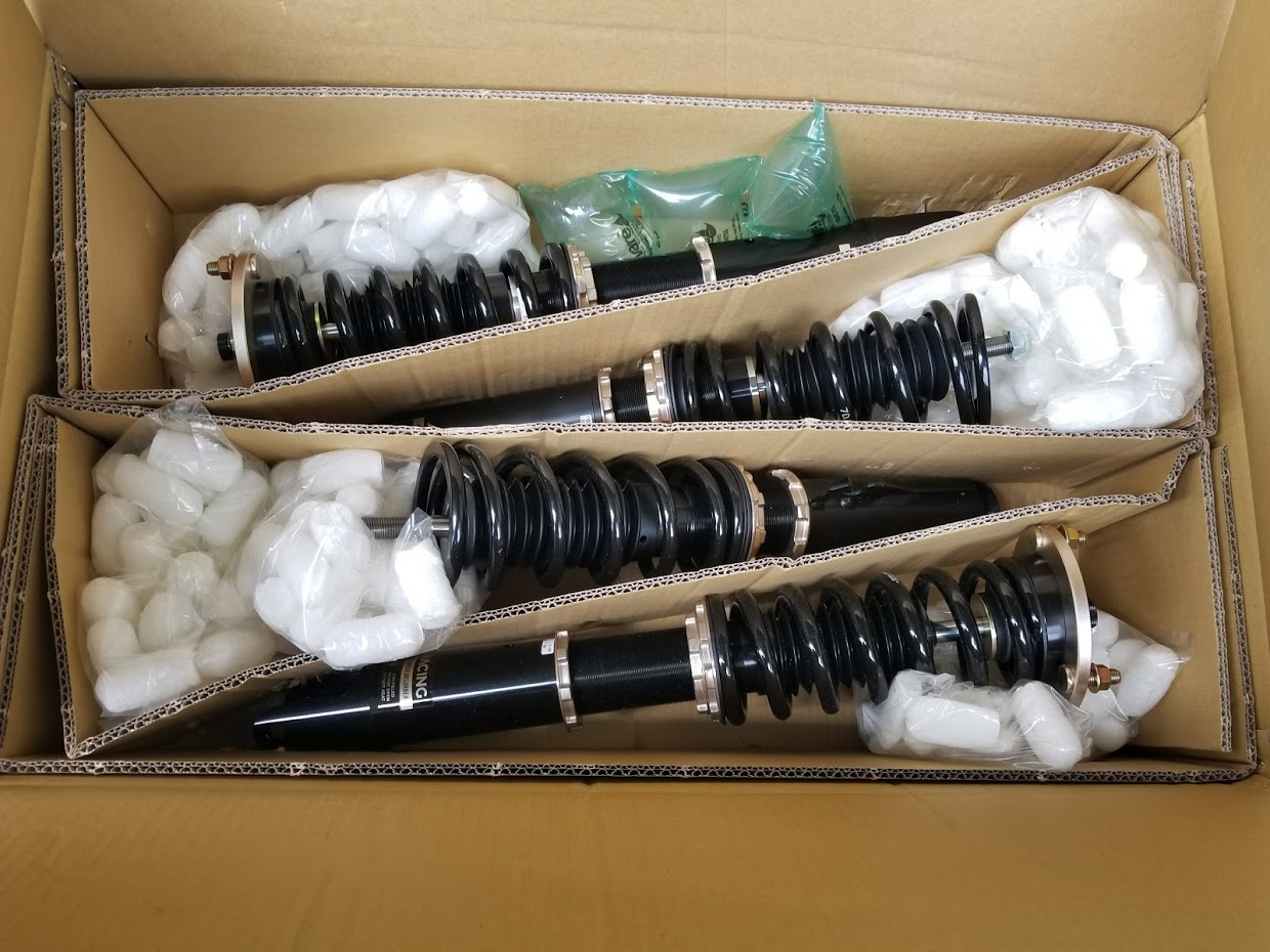

i got my coilovers in the mail last week and also picked up a pair of damper extenders. they're getting installed on the 24th. german88 thank you for all your help!
my indy told me i wouldnt need rear toe arms unless i wanted a more aggressive track alignment. for street he said i would be fine with the stock eccentric bolts.
Glad to help! Let us know how the install goes and a pic of the installed extenders when you get a chance.
