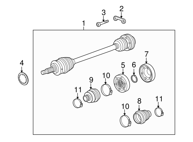

Does anyone have the torque specs for the inner 6mm cap bolts for the axles.
also the front suspension torq specs ,,i removed a few parts to remove my axles. need to get everything torq again./

here are some pictures to get an idea, the green , orange and purple arrows

green arrow(#3 on your diagram) should be cv-to-diff flange bolts. if they are m10x1.5 then 81nm/60ftlb. if they are m10x1.0 then 90nm/67ftlb
purple arrow isn't on your pic. If you're pointing to the eccentric camber bolt, thats m12 100nm/74ftlb
Orange arrow is also not on your pic. If you're pointing to the control arm bolt (m14x75) that's 160nm/118ftlb
