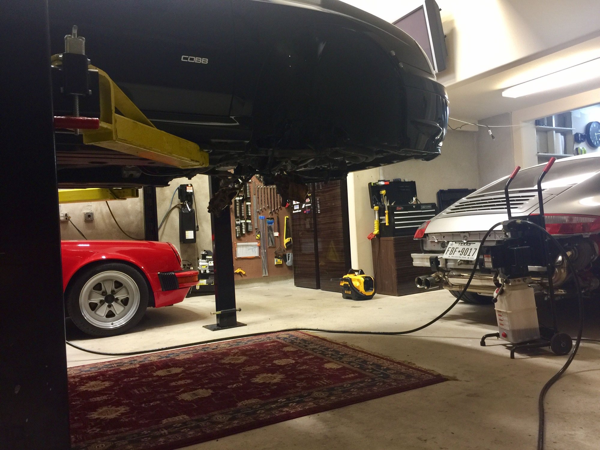

Just whoring out this photo of my work space. Bought a house with a large garage mid-way through this 997 build. It's amazing how much easier the work becomes when there is space to organize your tools and move around the car.
Not pictured is my new Mustang GT (premium performance pack). Still not sure what I'll do with it, but starting to look at FI options. I had not driven a mustang from the last two generations before buying this one and I'm actually amazed how great it drives in stock form
