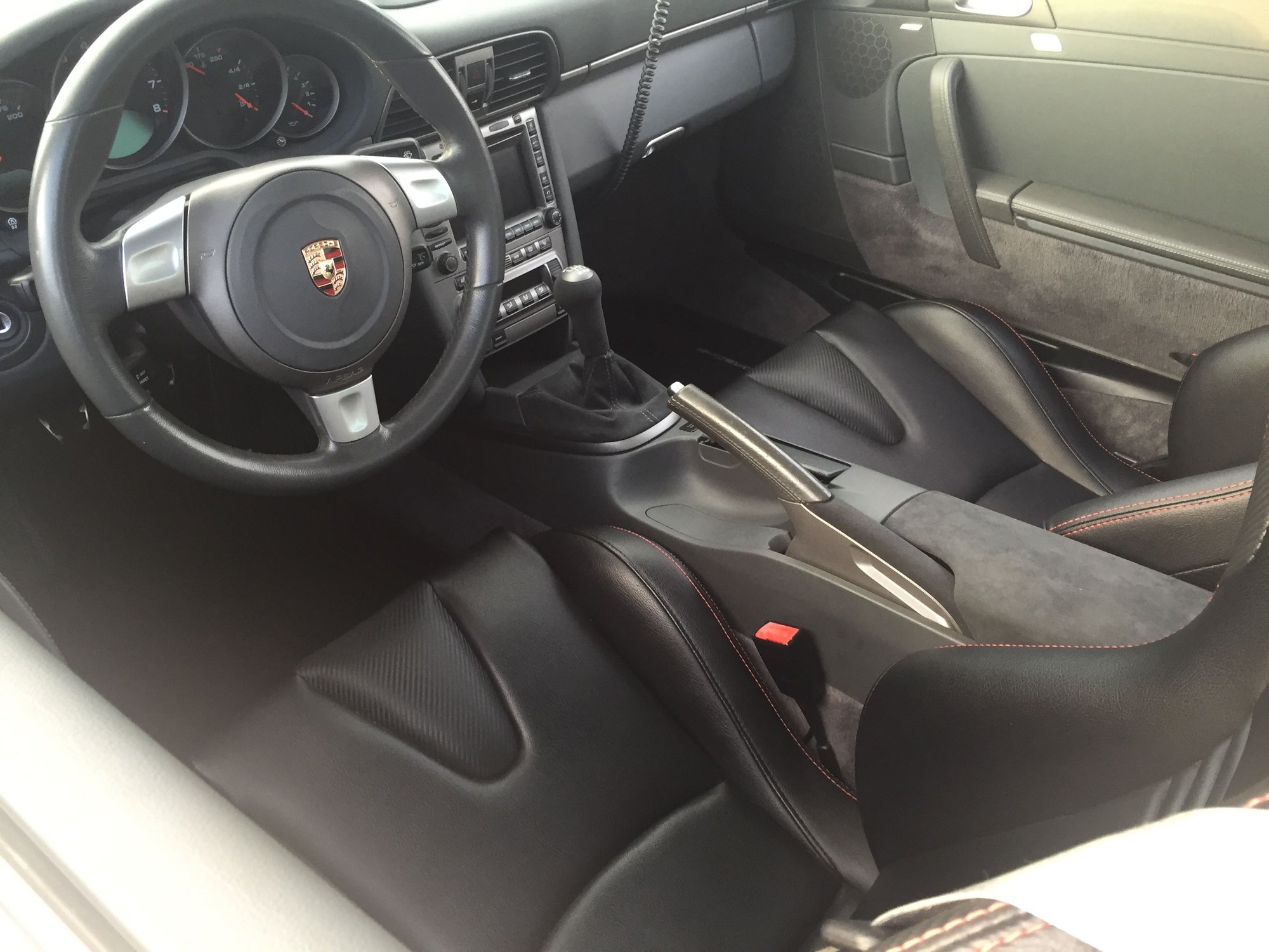

Here's a few pictures of the car

Thanks for the info.. good idea on the boost controller and bov. A must IMO.
Car looks good.
