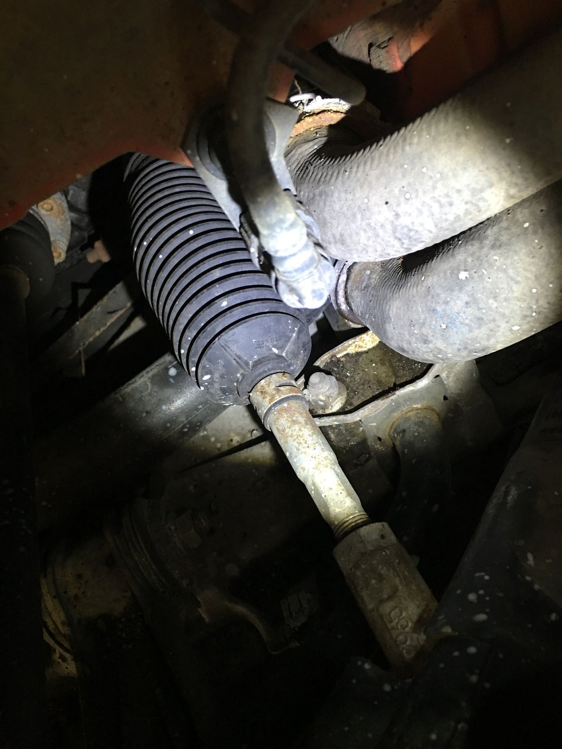

Sorry for not replying. I had some time and took out the front right wheel to see. I noticed there is a small leak on the lower pipe. Is that water hose supply or return line? Or something else completely, I used my finger and touched the liquid and it did smell like coolant. I had to add coolant lately and this is the first since 9 years of ownership and I have been smelling coolant lately around the front right of the car.
John
