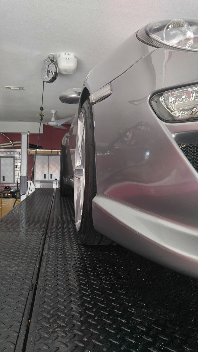

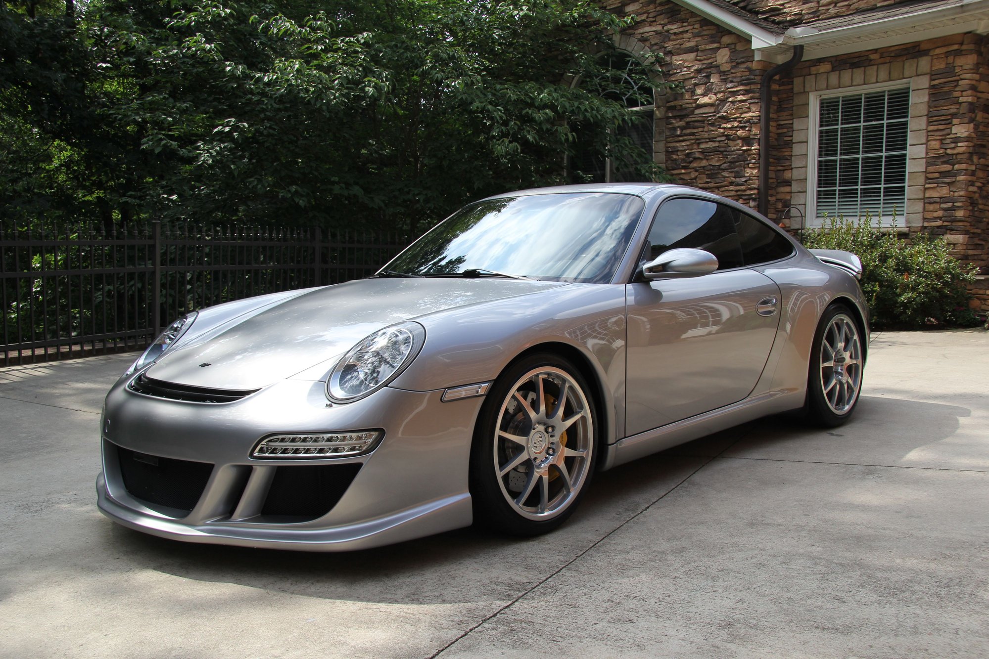

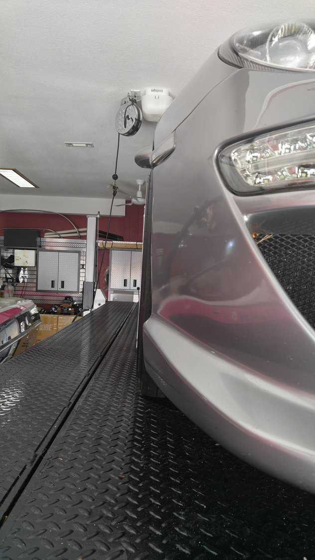

For a point of reference, these wheels I had on my car for a very short time were 19x8.5 with 42mm offset which put them outward 11 mm vs a stock setup (53-42) and they weren't anywhere near flush with the fender line. The setup you're looking at would be almost another full inch further out. The car didn't look good or drive well with this setup.

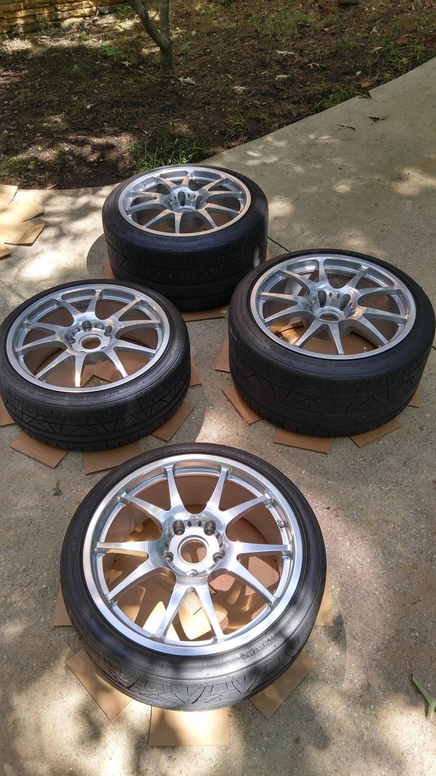

I have a set of forged, polished and clear powdercoated Champion rs171 wheels for sale in a perfect C2S fitment if your looking for new wheels. $4,200 shipped in the US.
Front - 19" x 8.5" with 53mm offset
Rear - 19" x 11.5" with 62mm offset

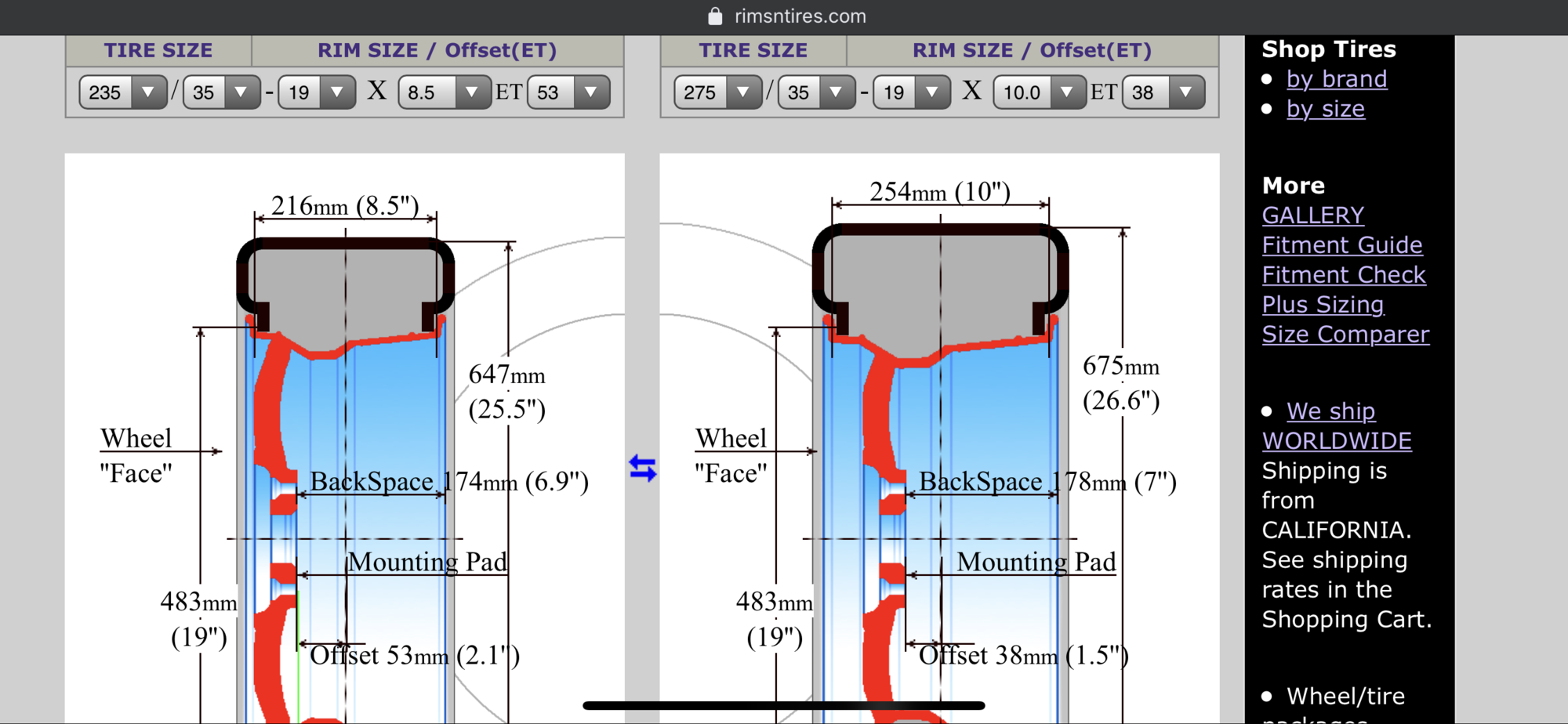

This calculator always helped me when determining sizes.
https://www.rimsntires.com/specspro.jsp
plug in the stock sizes and the potential size and it will give you lots of measurement comparisons
