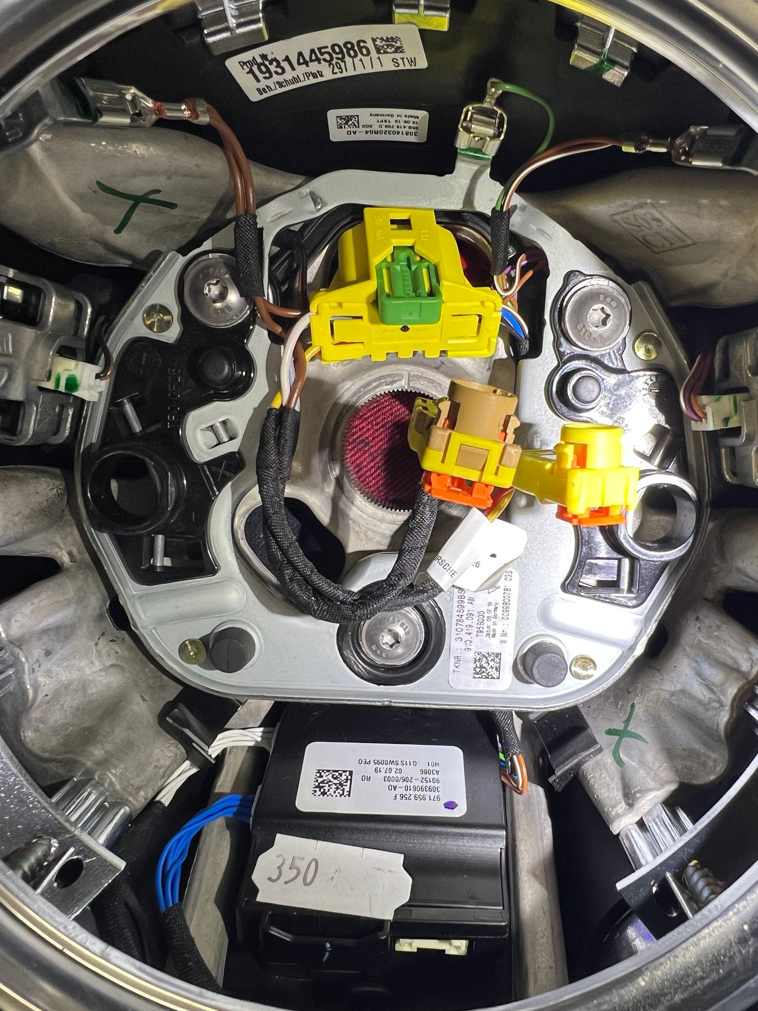

Just wanted to share; so I purchased a 2019 Macan SW and after getting to the final stage to install I discovered that the main pin connector was not the same as my 997:1. I’m hoping somehow I can swap them out so the Macan SW can fit….would anyone have any 411 on if this is possible. I attached a
2019 Macan main PIN does not fit onto my 997.1
pic of the Macan SW

Did this ever get resolved? I'm in a nearly identical situation; bought a 2018 Macan SW for my manual, non-heat, non-MF 997.1 but the main pin doesn't fit. It's the same as in the picture from G-Flat.
