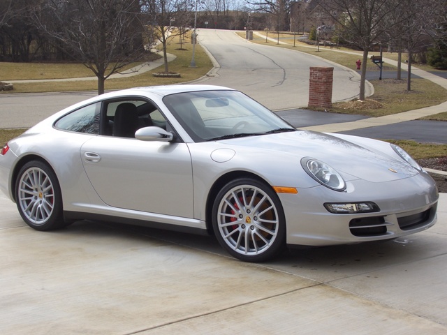

Rejex Story and Pics
So here's my Rejex story. Yes, I paid Eric for a pint. No, I don't want my money back... I really like it.
First off, I'm a mechanical engineer with a basic understanding of chemistry. I don't claim to be a chemist, but I've tried most all of the mid-range to upper-mid-range wax / cleaner / polish products on several cars - black BMW, metallic grey Acura, white Saab, blue metallic Saab. The Bimmer looks freaking incredibly deep (the "black mirror" effect) when you do the whole "wash / wash / tar&bug / clay / hand polish #1 / hand polish #2 / carnuba" sequence - but it never lasts for very long.
And most importantly - I've traveled 100k or more a year for business for the last 17 years. When I have a free day at home, I want to drive the damned car, not rub it for ten hours... (although I've been known to enjoy a ten hour rubbing ;-).That why the Rejex concept sounded good to me. As the 997 is new, I felt that this would be the best time to test it.
Rejex is not a polish or a wax. It's not a cleaner, either - so if you wipe it onto a non-pristine surface, it'll look like crap. It was designed as a soil-blocker / anti-staining agent for airplane surfaces, especially around turbine exhausts.
And no, it doesn't shine like carnuba, but it looks pretty darned good (pics attached). Most importantly, it's slicker than Hell - and that's the best way to keep road junk from sticking to the paint.
I started with a wash (Meguiar's Car Shampoo). Then, spot work with Bug & Tar remover - it's amazing how much tar those 305s kick up in the back. Next, a detailed clay pass (again, Meguiars). Now here's the part that made me a bit nervous - another wash with... Dawn dish soap.
I know, I'd NEVER do that to a car unless I wanted to strip all of the wax. And it did, including the remnants of spray detailer clay lube. Okay, let's do the first coat of Rejex... problem #1 - the stuff is damned hard to see on a silver car! Now I understood why Eric suggested two coats - you need a second pass to ensure that you have 100% coverage. After I got most of the hood done, I brought in a set of halogens on stands and found that they helped a lot. About halfway thru the first coat, I had it down to a science. Comes off waaaay easy; rotated in about a dozen of my microfiber towels and got it looking really good... also, it doesn't mark window rubber or gaskets, so you don't have to blue-tape everything.
Then, 12 hour "cure" time. Wow, it looked much shinier after a day of curing. Slick, too - threw a microfiber on the hood and watched it slide down to the crest. But why stop there?
Second coat was even easier. To be able to just apply this stuff - no worries about getting it off the rubber or out of the rear-deck script - made the job go fast. When I had the second coat on, I went back and put a coat on my Sport Designs, also. I love these wheels, but they are tedious to clean (p.s. - I said tedious, not difficult. BMW basketweaves are difficult to clean...) so if Rejex works here, I'll be happy.
Another day for cure time, and we rolled her out this afternoon. I am impressed. Yes, I know that I'll have to use soap (Meguiar's, not Dawn ) to get the car clean. Yes, the finish would look "deeper" with a multi-pass carnuba regime. But nothing sticks to the Rejex coated surfaces - I watched a water droplet race across the hood and just disappear - no trace, no tracks.
That's EXACTLY what I was looking for - a surface treatment to keep my _driver_ Porsche looking good for the long run. Guys, I'm not knocking the 'full-chemistry' detailing plan, it is definitely a superior shine. But if Rejex is truly "stain-blocking", then it will serve exactly as I want it to...
I'll let you know (in one month and three months) how its holding up. I hope that I'm this happy regarding Rejex at that point. Thanks, Eric - good call!
