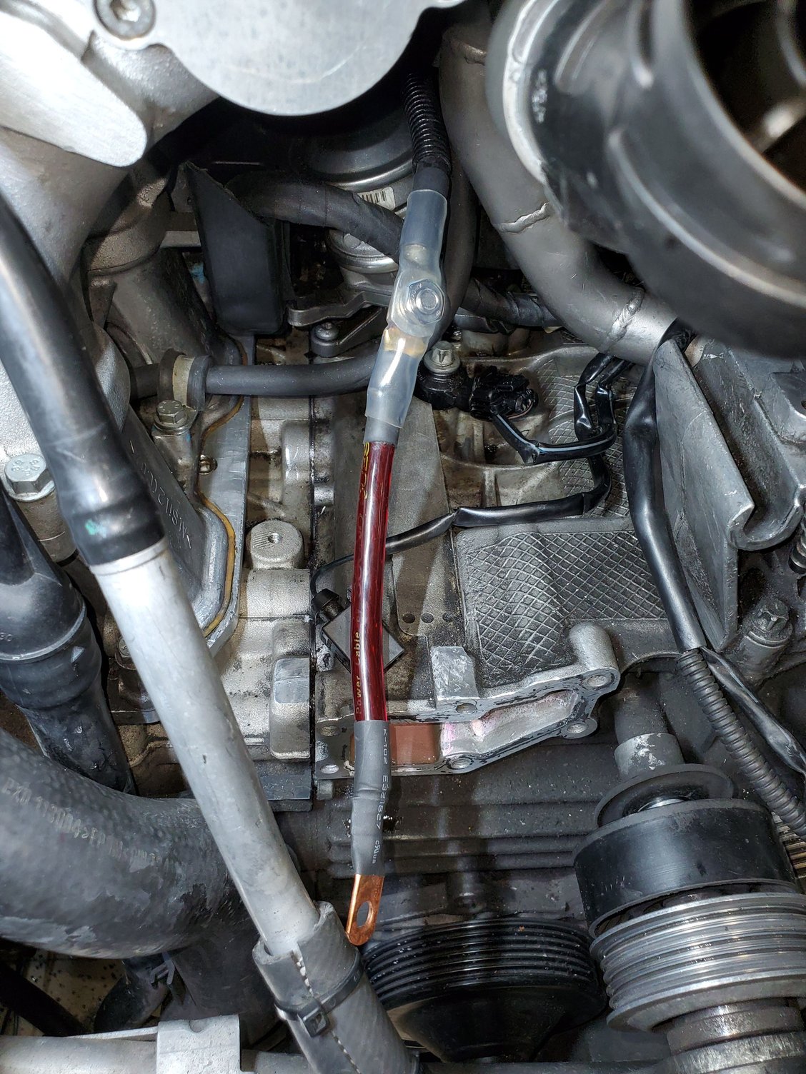

Secondary air pump is mounted on bank 1 forward and a bit inside of the intake manifold. It's the black and silver thing with the barcode label on it just behind my extended alternator cable.
Mean fuel trims for bank 1 and 2 will tell us more about what the whole fueling system is doing vs just the O2 sensors. Numbers should stay right at 1.0000 or swing just a little up or down and come back.

My car is a 2005 997. 1 C2S with 3.8L engine. Unless yours is a base 3.6 L engine, they should be the same.
