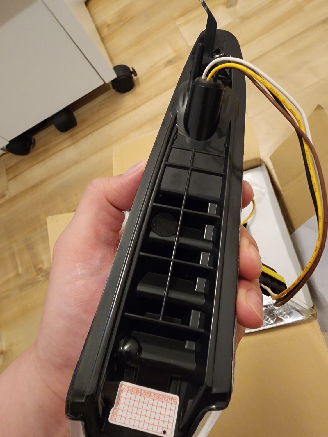

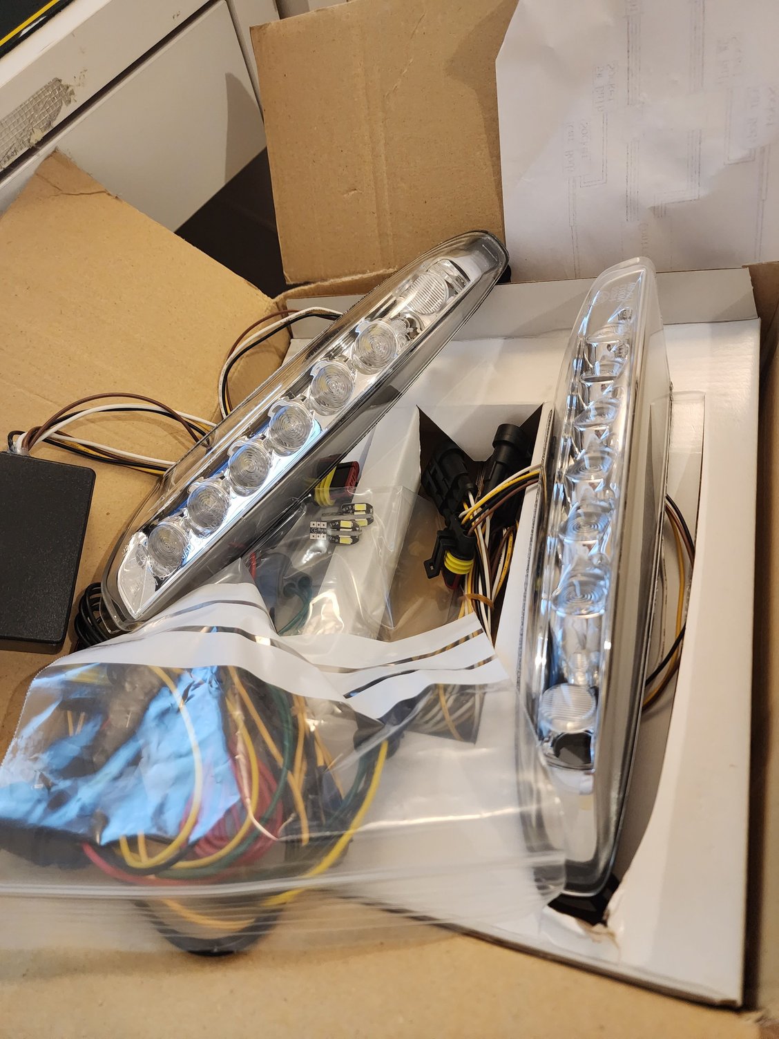

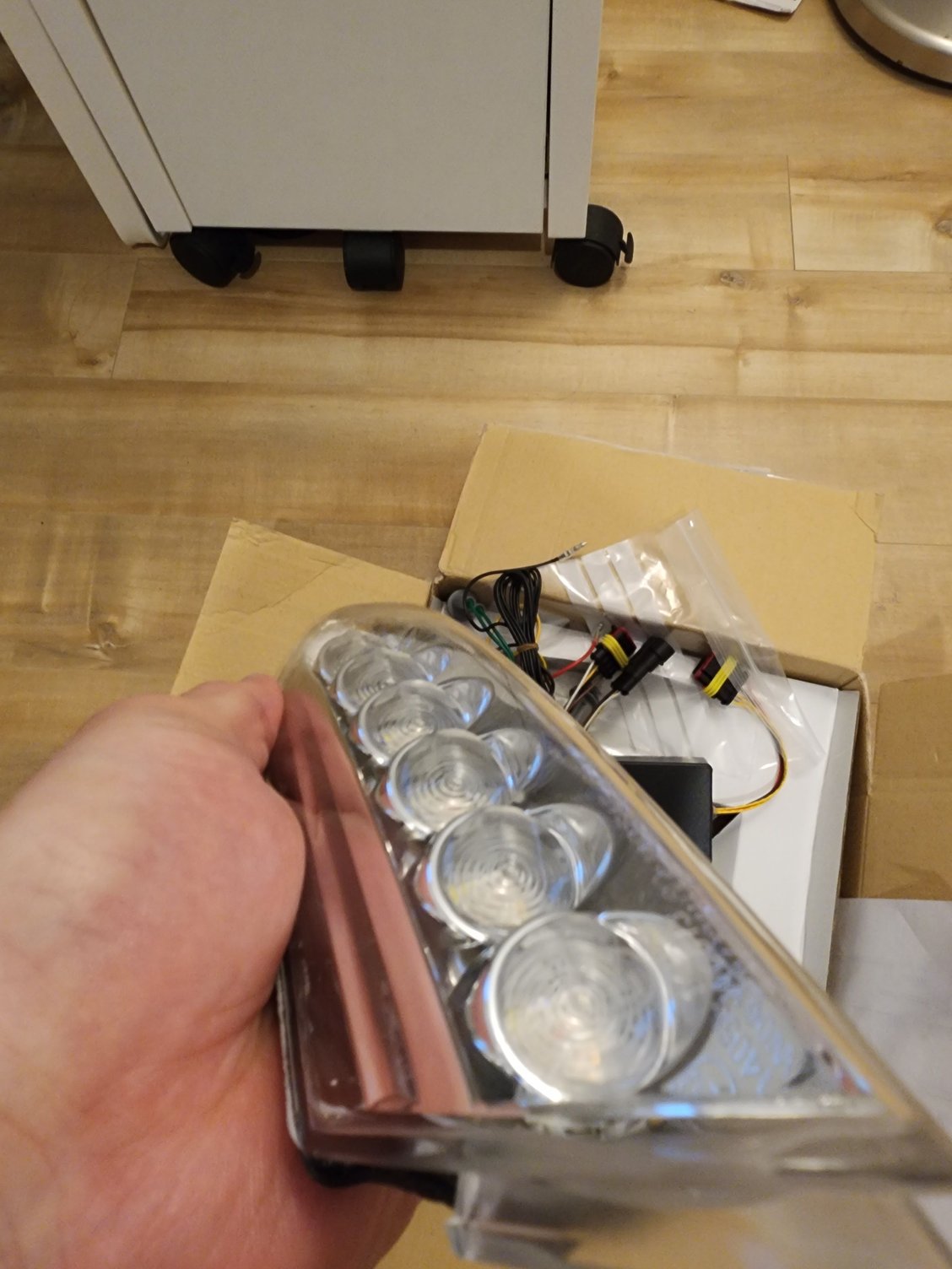

I installed these turbo LED lights including an aftermarket body kit that's made for the turbo on my C2S so I can give you some tips.
The exhaust sits 6.5 cm lower on the C2's but the length is the same as the turbo. If you want the bumper to be completely stocked then you have to do these exhaust mods, but if I were you
I would just go custom x pipe and delete the muffler, and re-direct the exhaust tip to slightly lower. You can do this under 1K using your stock muffler tips. You need a module to work the third light or a good mechanic
can tap into one of the rear window motors.
As for the signal lights they are great. You save a couple of hundred dollars compared to the OEM ones. He will send you two separate shipping. LEDs separately and lights and harnesses in another box. If you look carefully on the harness & lights
it's not the same ones as the agency power ones they use to sell. My car is sponsored by Jeffrey so you can direct message him on eBay and say that you got the lights because of me and he will give you up to 10% discount on top & free t-shirt. ( Save 60 dollars)
Headlight washer holes. They usually delete. Is the turbo bumper matching your car color? If not repaint the whole bumper and cover the holes it looks cleaner and better.
You might be jumpy because you just got the car and saw the opportunity on the turbo bumper. Make sure to train your eyes. Scientifically, especially tuning the exterior on the 997's
it changes by the time you reach 2~3 years of owning this car. I've seen some guy go far up to even turbo vents. He now has the Factory Aero kit.
Josh.
