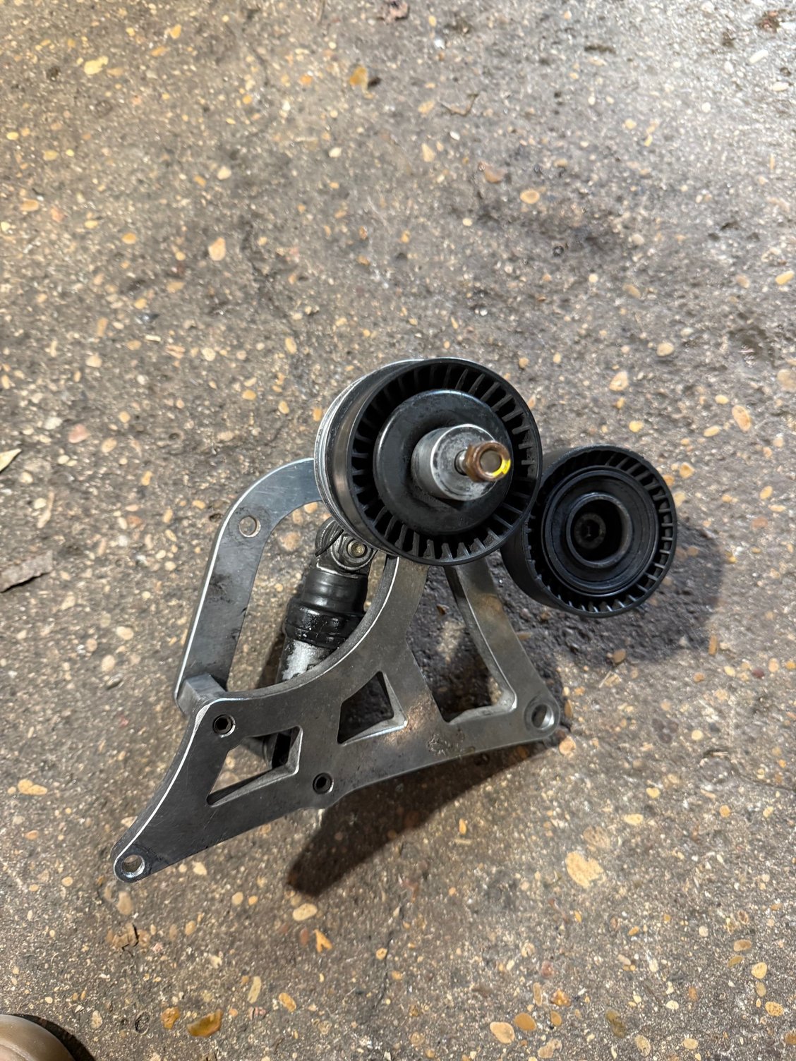

Can I ask you if by any chance you know the references of belt tensioner pulleys for the supercharger belt?
There are 3 of them and I would like to take the opportunity that this piece is removed to change all of them
I've asked RUF about it last week, if they sell them. Haven't received the answer yet.

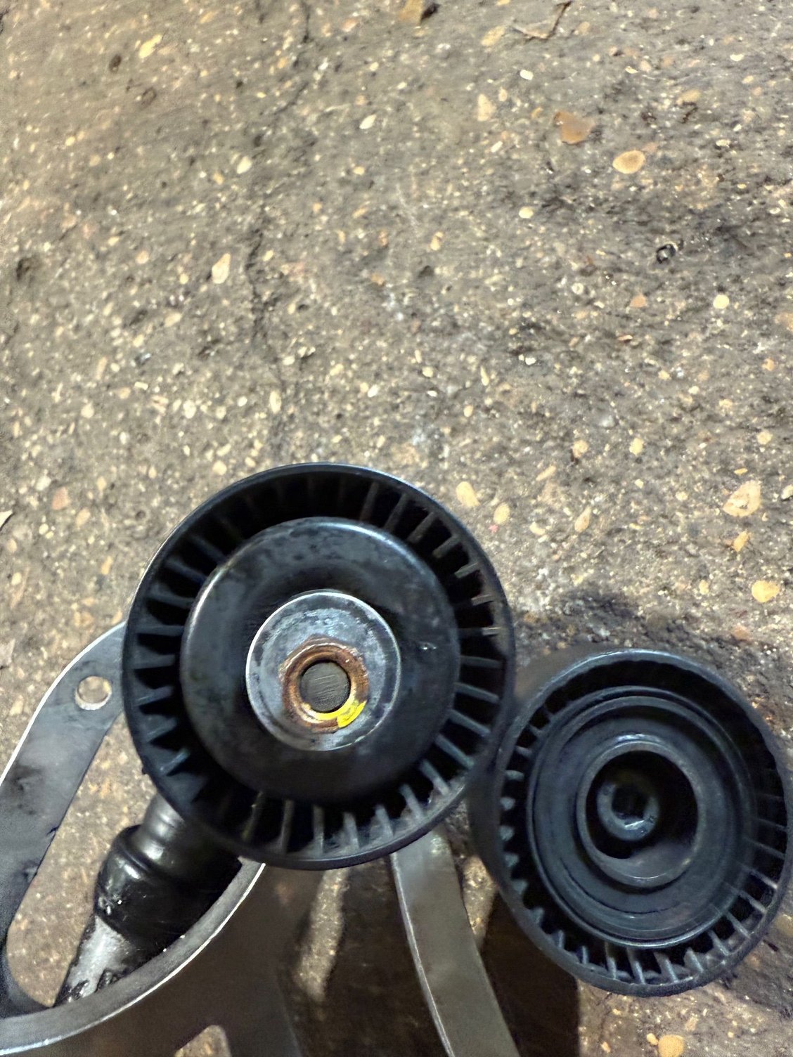

The tensioner and metal pulley are special items I think you can only get from them. The plastic pulleys are normal 997 versions. One of them cross references to a BMW pulley if you pull the number directly off the pulley.

OK great news, except for the metal pulley for which I'll have to wait RUF's answer. I hope they have it in stock

Regarding the tensioner and metal pulley it is indeed specific part and I got a quotation from RUF. I need to send the old piece to them in Pfaffenhausen and they will return me a brand new one. It is great they have it in stock.
I just need to buy the plastic pulley next to the metallic one. This one is not provided by RUF as per their quote.

I need to buy that same metal pulley assembly as mine failed and then melted the plastic pulley next to it. I used the one from my spare R-Kompressor kti but am now left without a spare. It was a much higher price than I expected so was planning to see if I couldn't match it up to something and build a new one myself.
