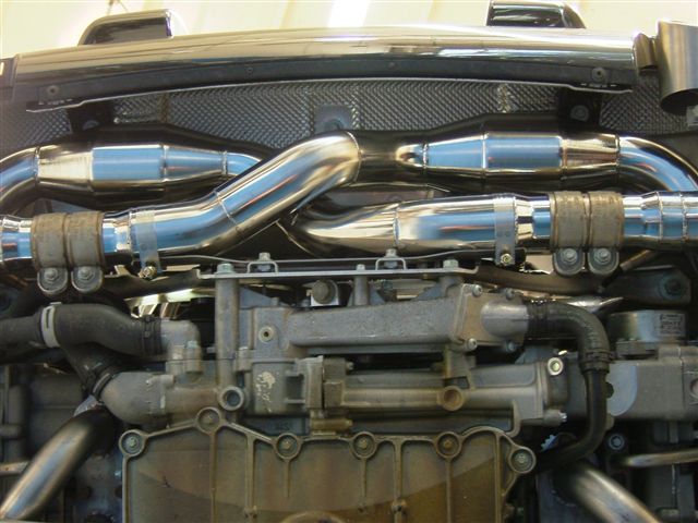

thanks. they're courtesy of sam's club
it's right behind the oil drain plug/pan. you can't miss it.

Deputydog,I found a picture of the underside.
The discolored part towarts the bottom of the picture is obviously the oil pan, which is a no-no.
Maybe you can point out where behind it , it would be OK to lift.
Thanks

it's kind of weird for me looking at it from this angle, but the red circle indicates where i would jack it on my 3.6 liter. that is of course if the 3.8 has a similar layout as the 3.6...

here's a shot of my car for comparison.... it's that solid piece behind the oil pan.

Dog - did you say a tech at the dealer said it was ok to jack from that location ? Seems odd considering how far back it is on the motor...
I wonder if a 2x4 placed under the oil pan that was as wide as the pan itself to distribute the weight evenly would be ok ? I used to use this method on my 993 in the front on the tub/trunk...But I dunno if it'd be a good idea on an oil pan.

yes, it was a tech at the dealer.
again, you're not looking to keep it up there on that point. just long enough to slip your rear stands in. it appears very solid. i have used this point several times with no problems (knock on wood )
not sure it would really matter how far forward or back on the motor it is. as long as it is a structurally sound point is all that matters. i would not try anything with the oil pan.

The oil pan is just a thin piece of cast aluminum.
What are your objections of putting the rear wheels on ramps?
They are a lot more stable than any jack stand and for $25 a pair,
why risk damaging the engine ?

just use the jackpoint i recommended. ask a tech at your dealership if it will make you feel better. it works fine. ramps are a pain and i don't like using them. not to mention if your car is lowered you may have issues even getting up them.
