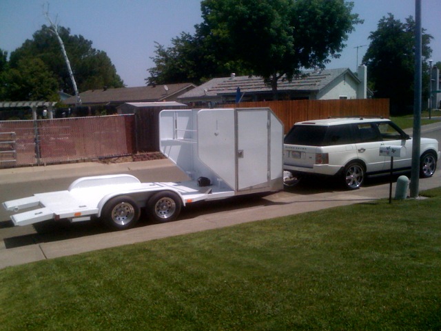

Best of both worlds: semi-open trailer (Here's my set-up...)
where can I buy that?
Old May 15, 2008 | 11:27 AM
Targa Tim's Avatar
Joined: Nov 2005
Posts: 1,550
From: Vancouver, BC, Canada
Rep Power: 116
Targa Tim has a reputation beyond reputeTarga Tim has a reputation beyond reputeTarga Tim has a reputation beyond reputeTarga Tim has a reputation beyond reputeTarga Tim has a reputation beyond reputeTarga Tim has a reputation beyond reputeTarga Tim has a reputation beyond reputeTarga Tim has a reputation beyond reputeTarga Tim has a reputation beyond reputeTarga Tim has a reputation beyond reputeTarga Tim has a reputation beyond repute
Looks very good! Which company made?
