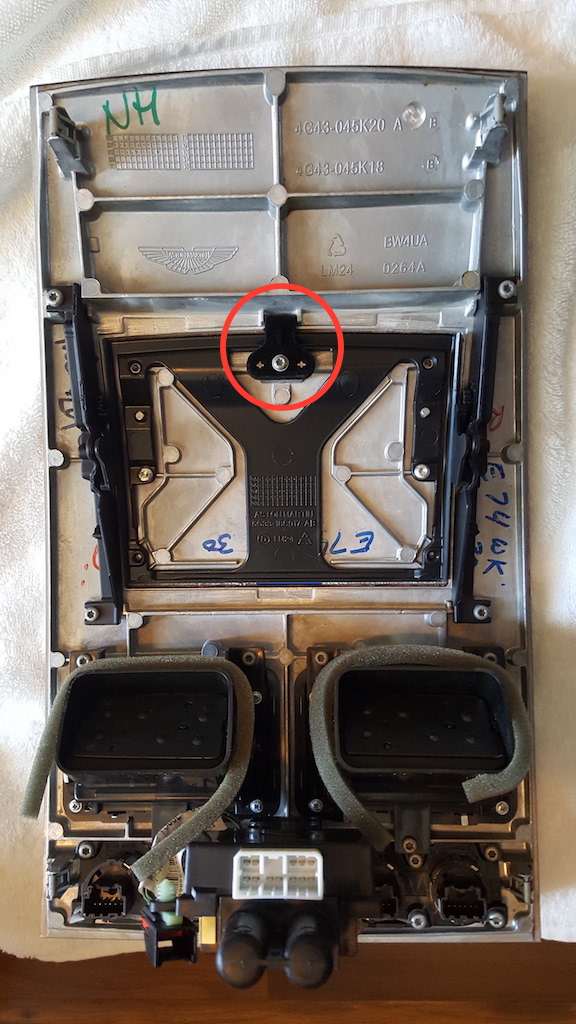

Satnav doesn't open completely to vertical...pitched a bit forward
My satnav screen opened and closed fine but never opened to truly vertical -- it was always pitched a bit forward and drove me nuts. I spent hours searching forums and thought I had a gear problem.
So I purchased the gear replacement set...removed the ski slope (I was very nervous doing this) and removed the satnav. The gears were fine and I was happy I didn't have to attempt the gear/spring removal replacement detailed in the service bulletin. So back to searching forums until I ran across this thread.
Since it wasn't the gears, and I had everything in pieces, I played with it for a bit and discovered there is a felt covered t-shaped stop piece bolted onto the back of the satnav door (not the satnav) that acts as a friction mechanism to make the satnav door open smoothly (rubs against plastic behind satnav as the door opens). I've circled the stop piece in this photo.
I figured it was probably creating too much friction and keeping the door from opening fully. I removed it, reassembled everything, and discovered that was the trick. Now my satnav door opens to an upright 90 degrees and closes fully -- the movement is just as smooth as before...and I can't understand why that stop piece was installed in the first place.
Taking the ski slope off allowed me to repair the foam seals around the vents. I sparingly used clear silicone which worked like a charm.
BTW, I have a 2010 DB9 and the satnav is secured to the ski slope door by wonky clips. My best advice for removing the clips: with satnav off/down, carefully lift up the door just a bit till you see the clips. Press down on the back of the satnav with one finger while lifting the door a bit more till you can reach the the clips and slide each one away from the center till they disengage from the door. Reinstalling is just the opposite...with the door laying on top of the satnav, push down on the back of the satnav and pull up on one clip at a time, moving it towards the center of the door till it engages. Hope this helps someone...but if this is clear as mud, see this thread with photos to better explain the clips:
https://www.pistonheads.com/gassing/topic.asp?t=1332420
***One thing I forgot to mention: once the stop piece is removed, the door will swing freely in all directions. Be careful and make sure it won't swing and damage the door or surrounding components. I used painter's tape on top of the door to keep it in place while reinstalling.
