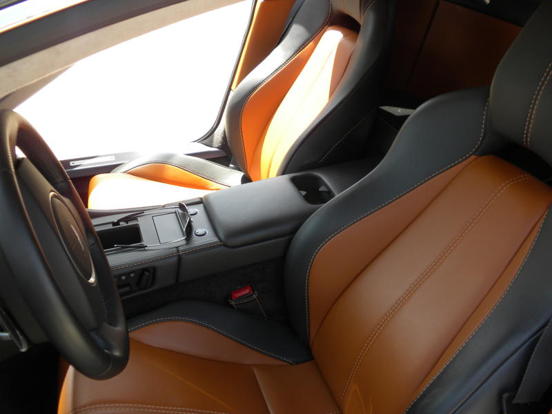

For the positive thoughts. Even though I’ve only been able to drive the car for 3 weeks, I love this car! It is so engaging to push the power out of the engine. I know I have after-market exhaust, but the engine note just begs you to give it more. The interior build quality is amazing. They put leather in places you would never expect and I’ve looked over the stitching and it’s flawless. I know some people criticize that AM put too much thought into everything. But, the car is a piece of art and the level of care they put into building the car also shows of the quality. Power, beauty and soul all the way.
