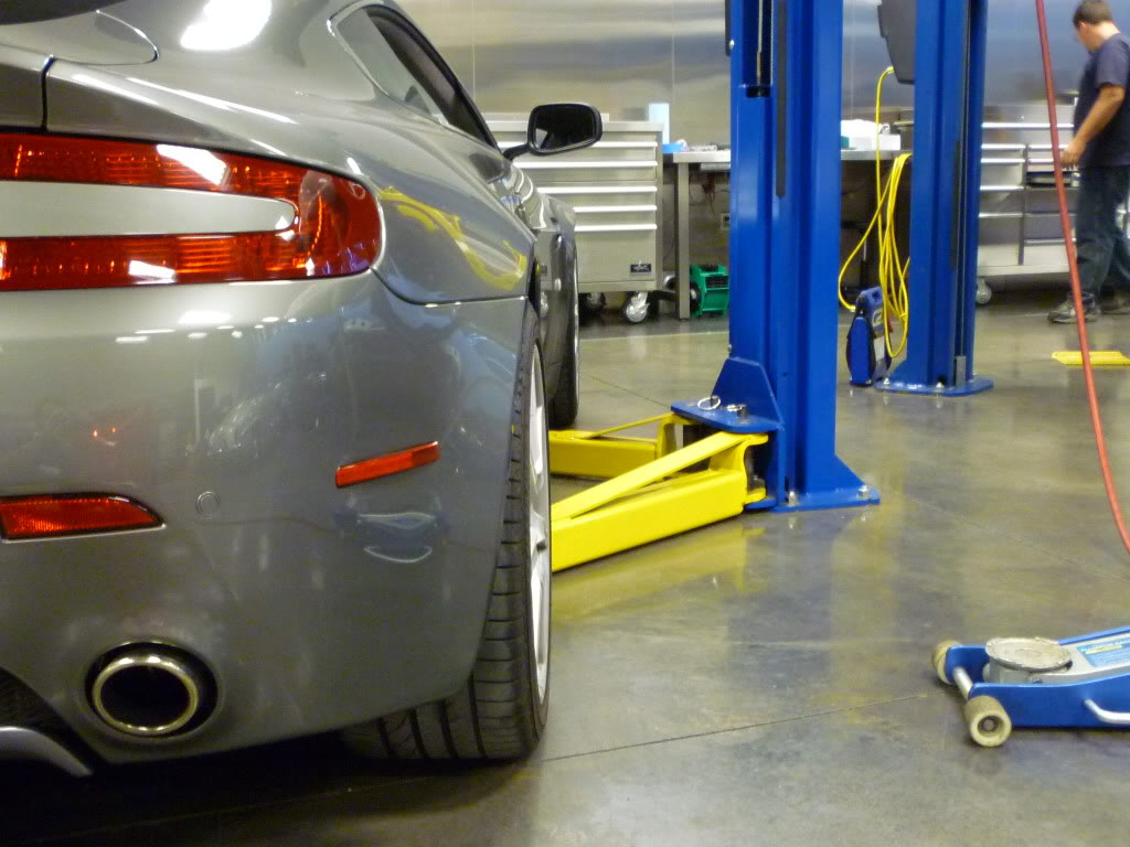

Okay Guys & Gals. Some Pics from Mr. Cobb.
Before:

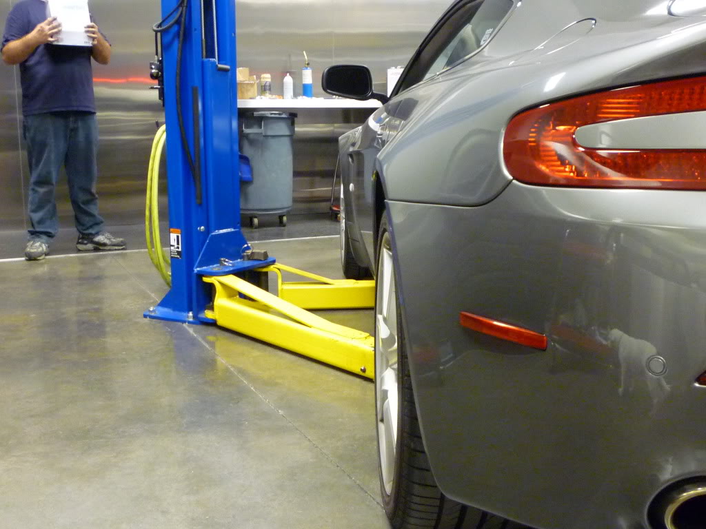

After:
