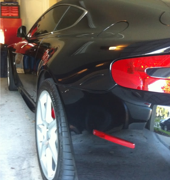

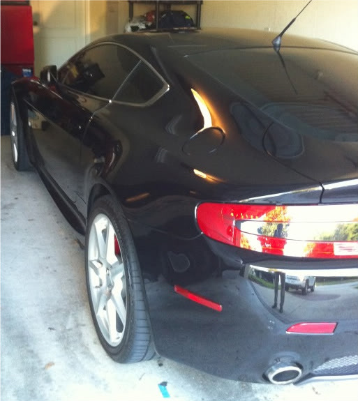

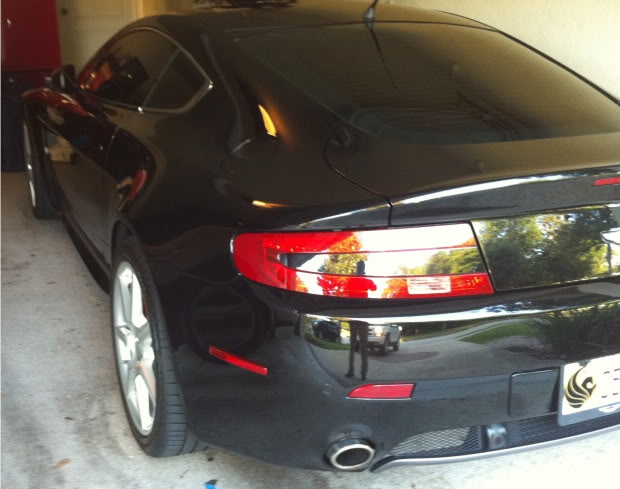

Here are some quick cell phone shots from this a.m. They new stance looks very nice.
